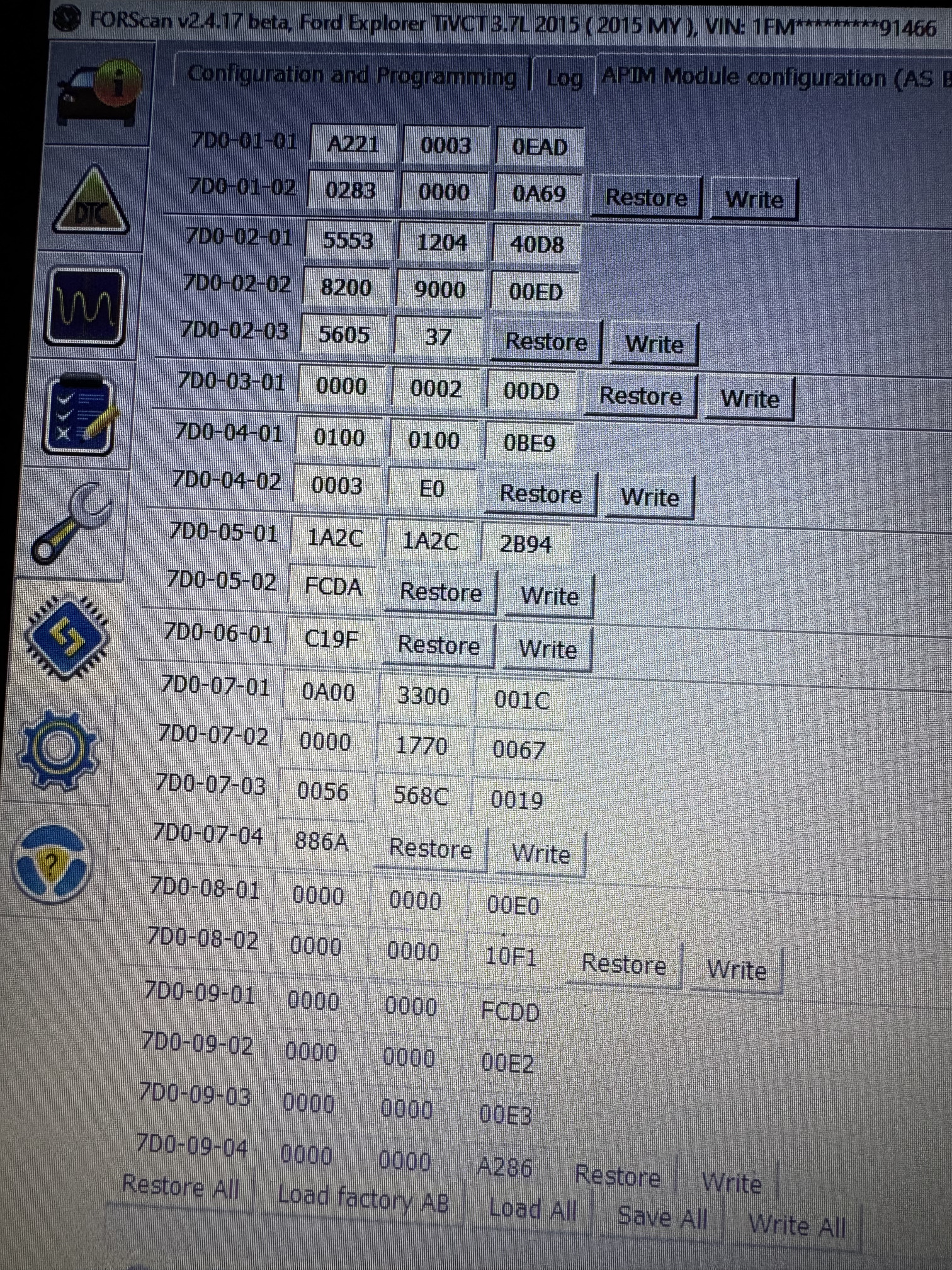

Just post your current AB here. It will just be easier for myself or someone else to tell you what to change.
I can do that. Where should I go? I used forscan but where should I go to send you a pic?
