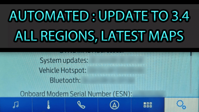

Ford SYNC 3 - Automated Method - Update to 3.4
Discussion topic for Ford SYNC 3 - Automated Method - Update to 3.4
Difficulty: Intermediate
A guide on updating your Ford Sync 3 based car to the latest Sync 3.4 version using Syn3 Updater to make the process as simple as possible for you!
Originally published at: Easily Update SYNC 3 using our Automated Method - CyanLabs
