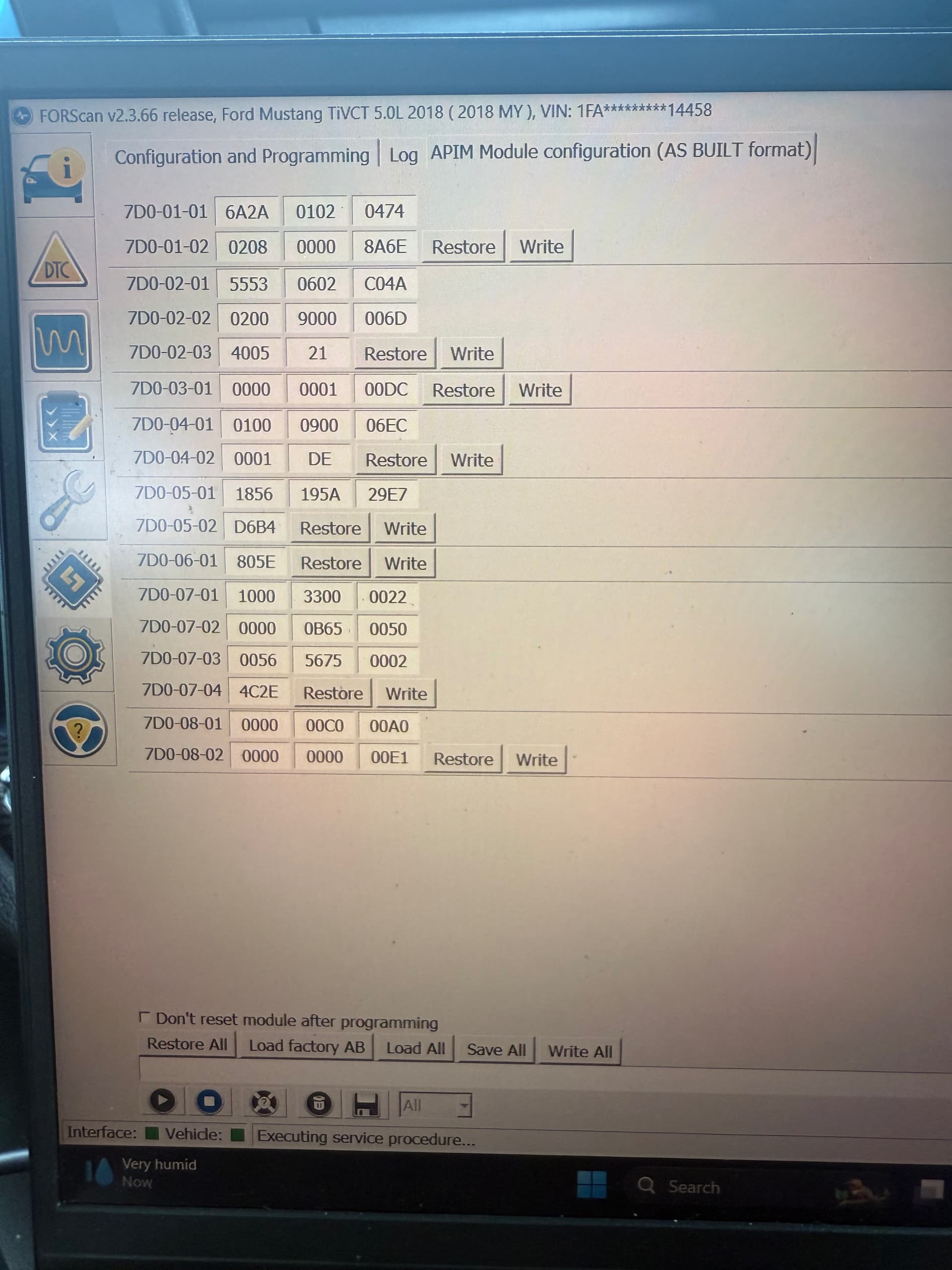

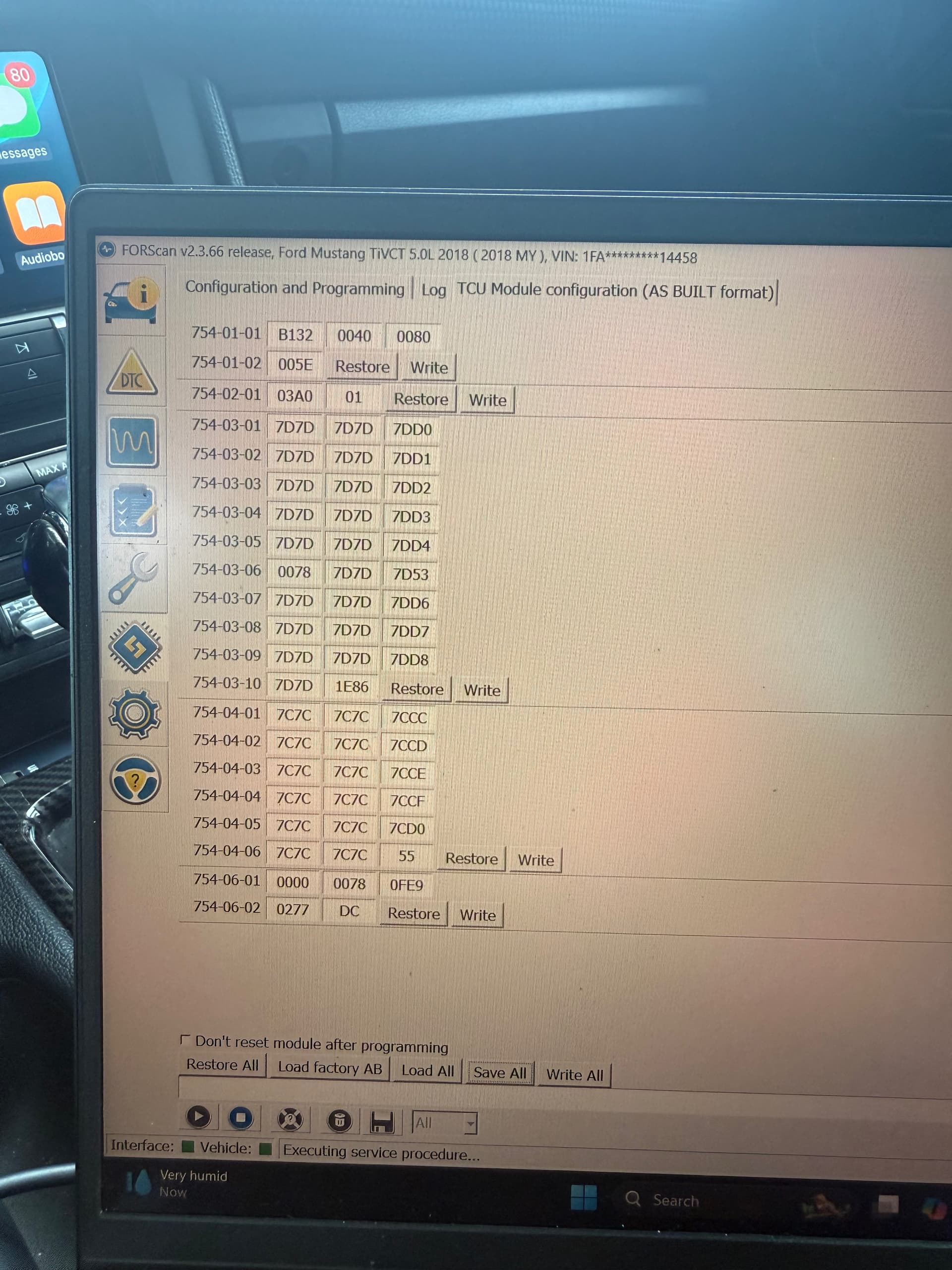

To start with post your asbuilt for the TCU and APIM.
Here is my TCU and APIM as built data, thank you

Your APIM and TCU coding indicate North America, specifically US. The APIM and TCU coding looks fine, no issues there.
Pull power from the TCU and let it sit for 5 minutes or so then plug it back in and try the factory reset. Look at the signal level in the logging feature in FORScan.
If the TCU does not respond it might be defective, this is not uncommon.
