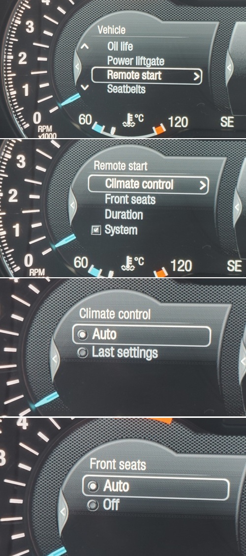

First time poster. I enabled OEM remote start with OEM key fob plus Forscan. Everything works bar the heated seats, which do not turn on when remote started, even when ambient temp is 10c or below. Got climate, front/rear demister and heated side mirrors working on remote start. But no heated seats on remote start. Even if they’re set to either ‘Last settings’, or ‘Auto’ in IPC settings.

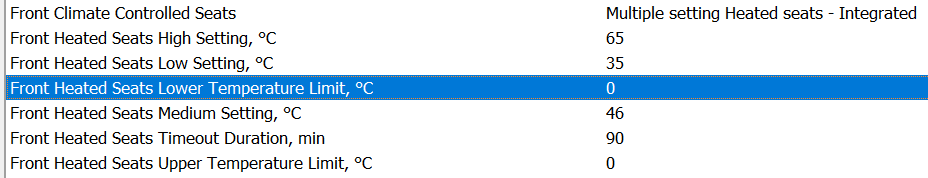

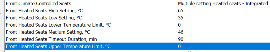

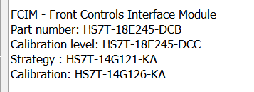

In FCIM, there’s two settings, upper and lower temp limit, which are both set to 0deg Celsius. Is this anything to do with the issue? What are these settings for? I will attach photos of these settings, plus my FCIM calibration level and IPC settings to this post if it helps.

The 0º you have highlighted telling the FCIM to ignore the element temp sensor if the button is turned off.
