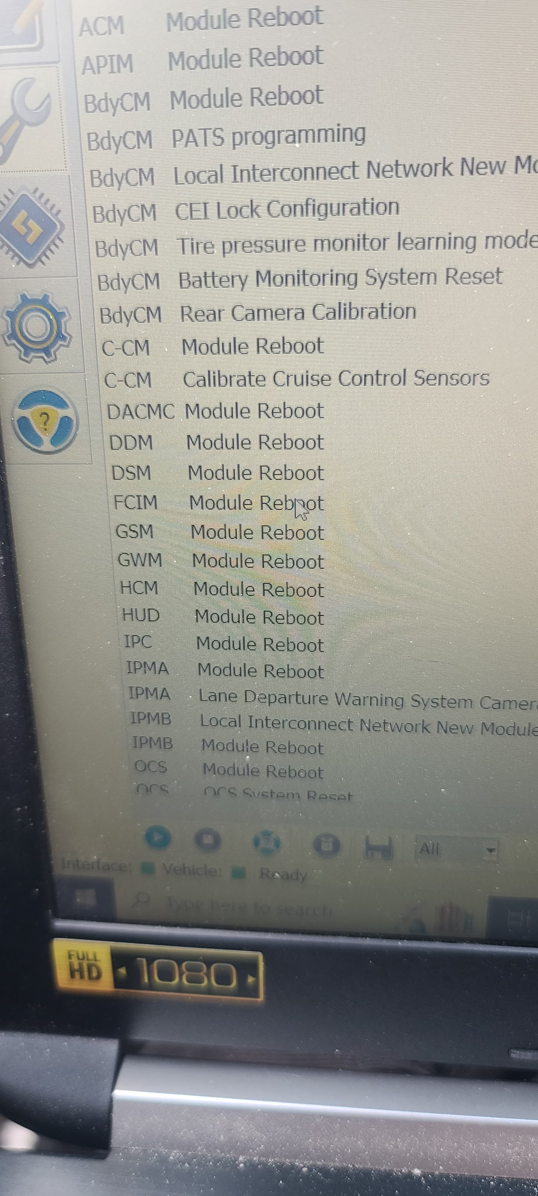

But, nothing above would cause the HSW to not work, it is independent of the Sync system, regardless of version. In the MKX, the HSW function is controlled thru the FCIM and the HSWM. resetting those 2 modules with FORScan might fix the issue if the HSW is indeed good and the modules just need a reset.
How do you know the HSW is not working?
The HSW button is in fact there on the home screen and the climate screen. The icon does change to red and stay red. The steering wheel can be on for an hour and is still as cold as the minute it was turned on. I can go in through Forscan this morning and try resetting modules and see what happens and if I currently have any errors with any of said modules.

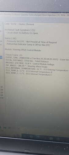

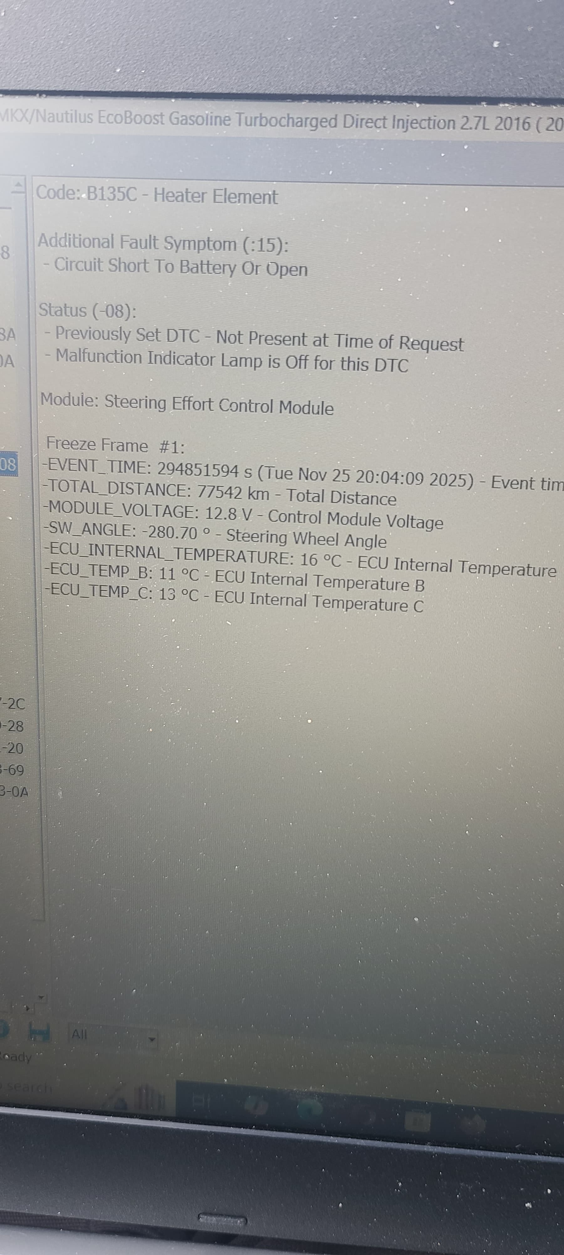

Upon getting into the SECM, I have this error which I assume means the heated steering wheel is toast… i reset the SECM but the error has come back.
That’s probally the answer.
It could be just the wiring…you’ll have to physically trace it out and check the connections and heating element with an ohm meter.
