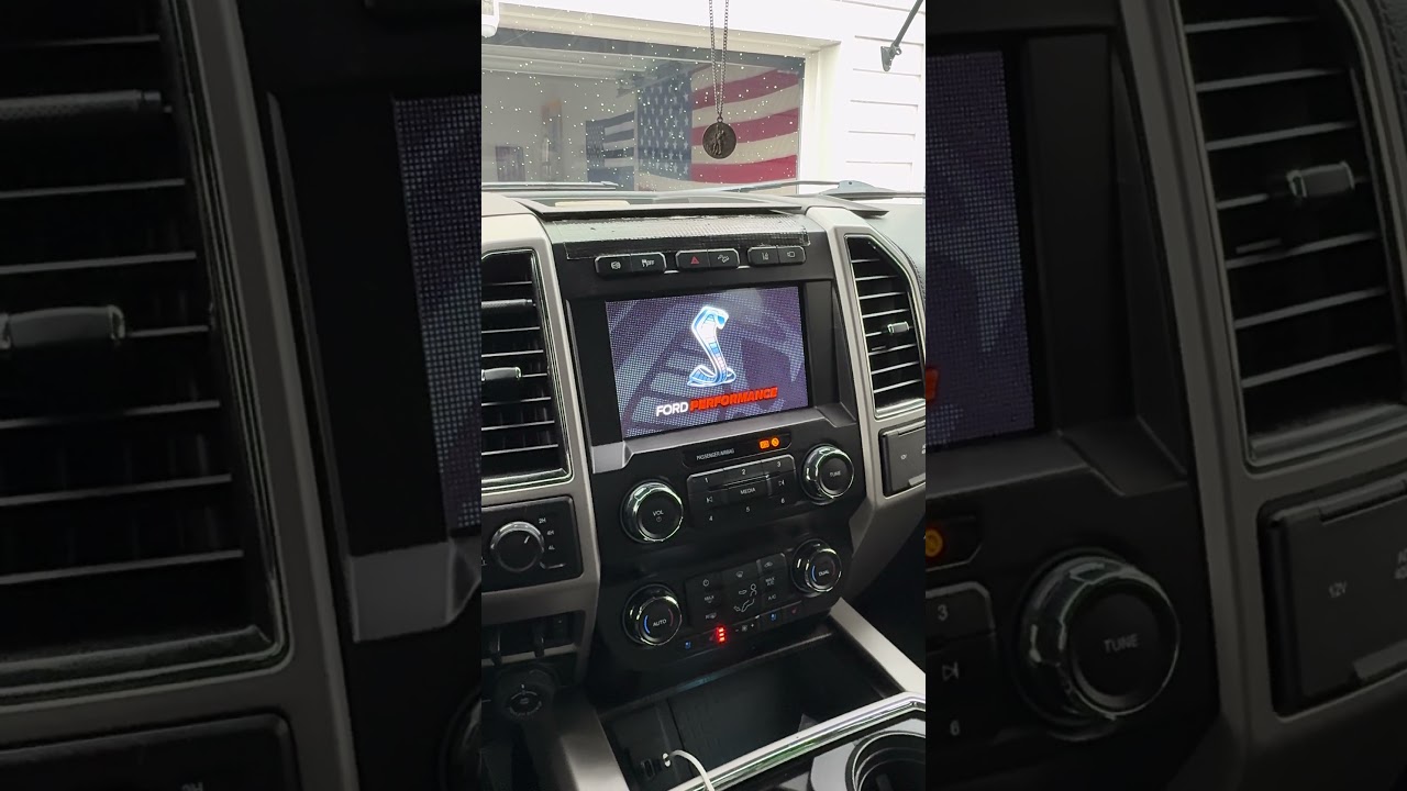

Help 2020 f250 black screen

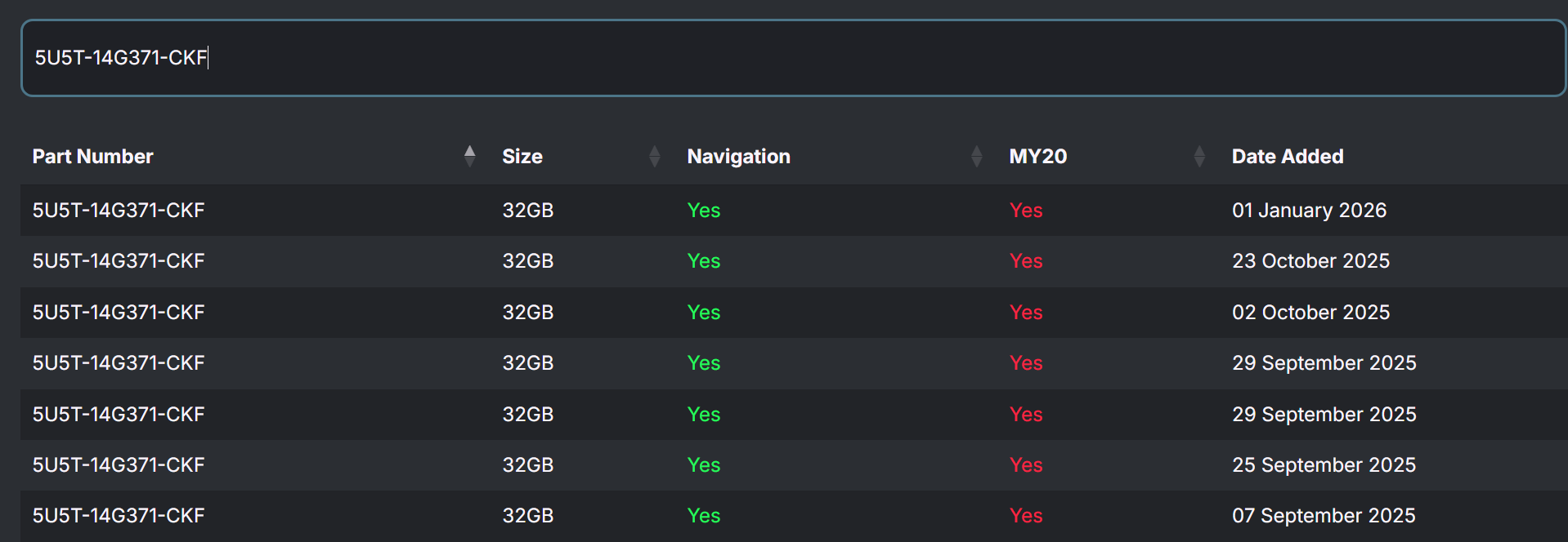

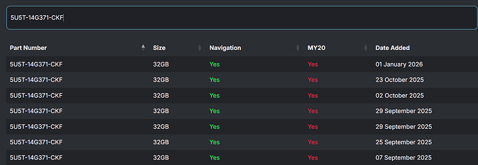

this is what you needed right?
This is a MY 2020 APIM.
how did you get that to populate?
is that in the sync 3 updater?
SYNC 3 APIM Hardware Database - CyanLabs
When a vehicle is a 2020 you have to assume it has a 2020 APIM. The only way around that is to physiclly remove it to check the sticker and the build date.
im in the truck right now ripping apart the dash
Well you have the model number so it’s kinda known now.
and before any one gets on here and starts freaking out that it’s the wrong boot logo or says that’s the reason why. I know I just left it on there after I got done on forscan. It still happens with the ford logo one too.
