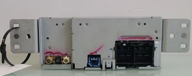

M1PT-18K810-DA/DB and look like the following:

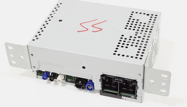

If I search for an ACM from a new Maverick, I ind these MX71-18D804-GH / GJ / GF
I prefer to find a Sync3 ACM that has Bluetooth, HD Radio and SiriusXM. The first unit has a label that says HD Radio and Bluetooth but sot sure about SiriusXM. The second ACM, although newer, does not have anything listed on its label. Also some of the FAKRA connectors on the ACMs are different and I’m unsure what they support.

The MX71-18D804-GH unit you posted are for EU, which will not have SiriusXM. You will need to find a NA unit.
The M1PT-18K810-DA/DB does have SiriusXM, more importantly the X40 platform which has the XM transimission platform and additional channels, depending on the subscription. Make sure your vehicle is compatible as far as wiring and options.
Thanks for your reply! Sounds like the M1PT-18K810 units would be the one to get.
