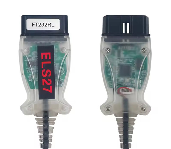

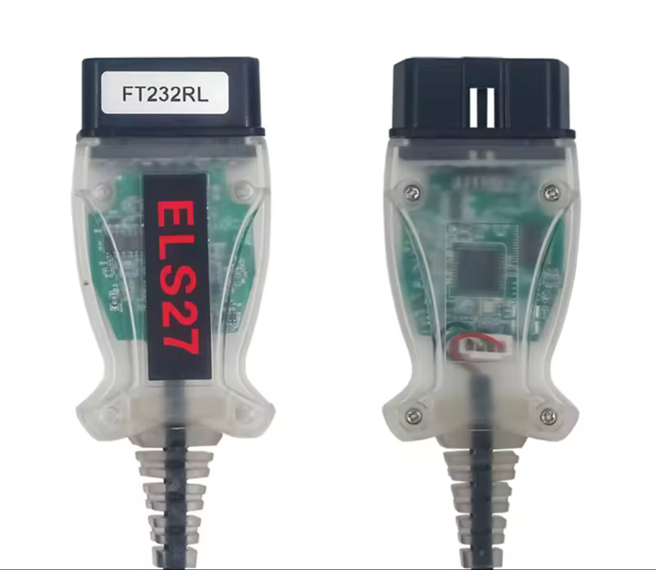

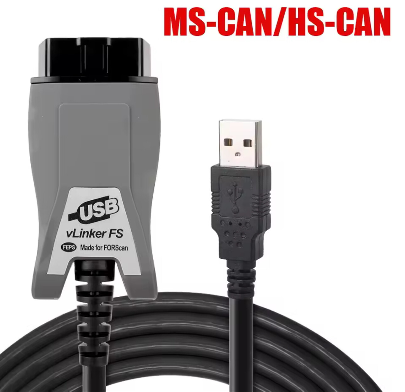

However, my Forscan doesn’t communicate with the ACM. I’ve tried two different cables without success.
I wonder if I should remove the ACM or if you could recommend another device that would allow me to modify the As-Built of my ACM.
What USB adapters are you using? Does it have a switch? Have you deleted the profile if you have swapped your ACM? Older ACM’s have very little to adjust in AB.
I haven’t changed from ACM,
Have you installed the drivers for those on your computer?
