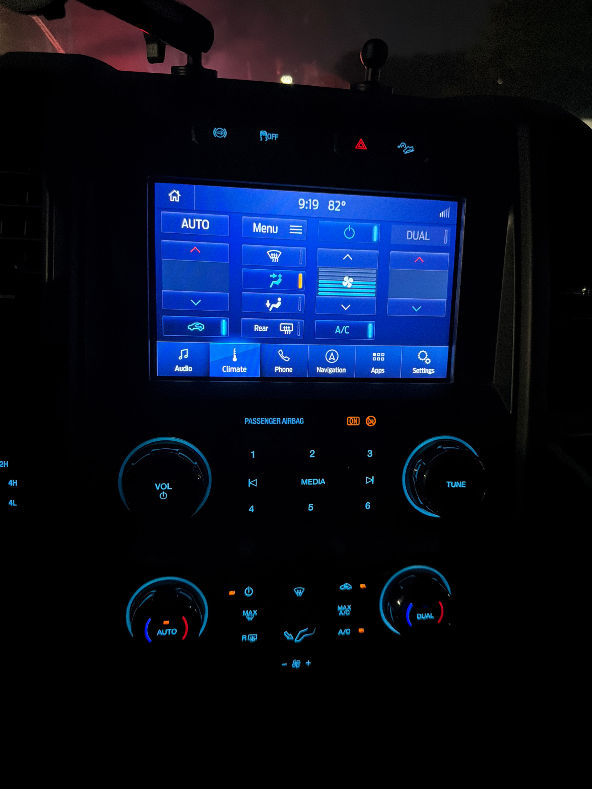

A while back I did a cluster upgrade and a 4inch sync screen to 8inch screen on my 2020 ford f250 everything was working fine until my tow haul mode wasn’t popping up I didn’t mind but when I change my transmission I had told ford about it they suggested a new cluster and the original one when they did they my a/c controls stop working and only blow hot they change the a/c module and still nothing denied working on it anymore don’t know what to do I have access to forscan maybe I can do something there

Only thing I know from ford is that when they put the original cluster and programed it that’s when the a/c started only blowing hot I told them I did a cluster upgrade and a sync upgrade and they told me that’s my problem and that they can’t use forscan I got on foscan earlier and couldn’t find anything I’m wondering if it could be a code on my build because they messed it up with there programming
I can’t change my temperature stays blowing hot no matter wat
