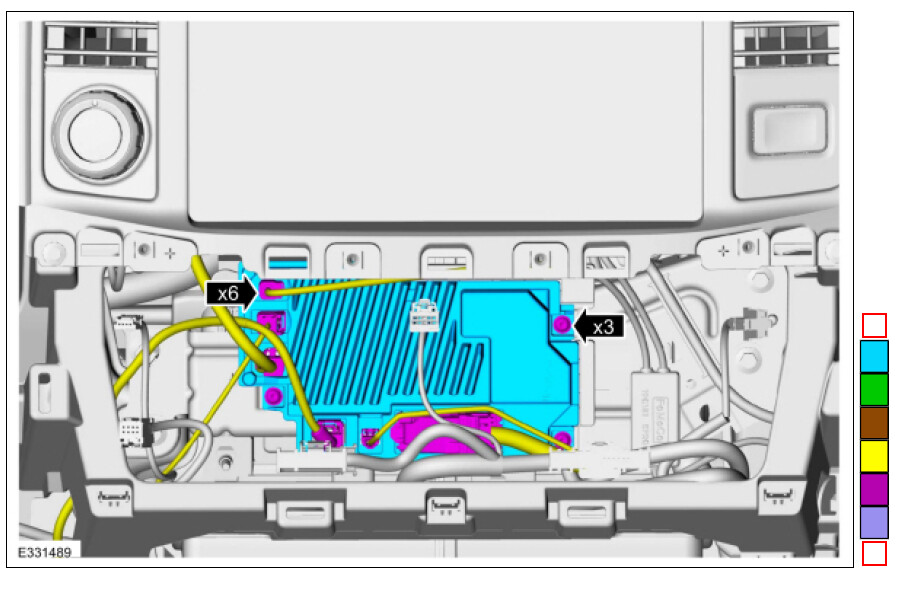

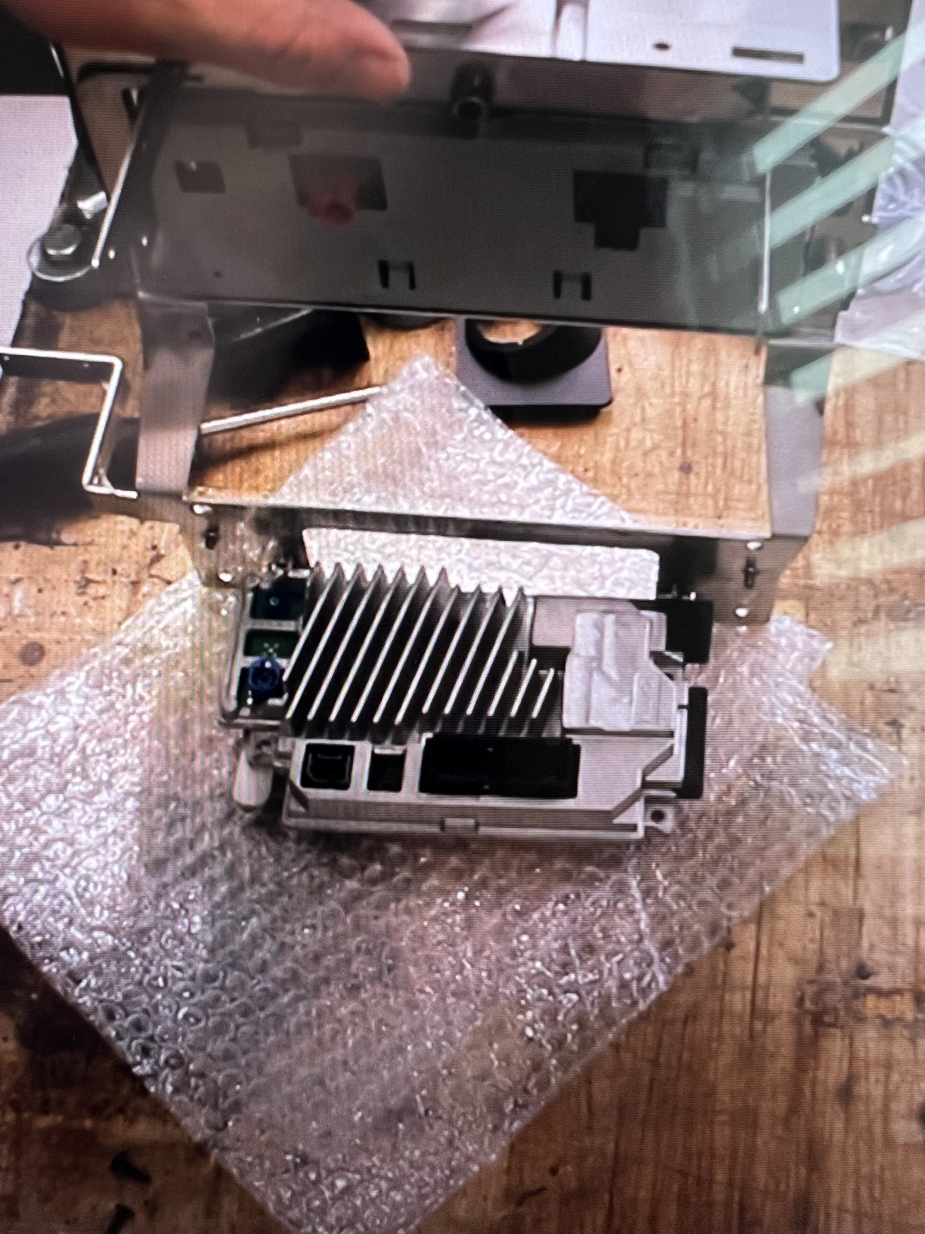

Hello can anyone help me with correct values for a apim mount angle, the apim is mounted vertically just like on picture

An APIM mounted in a 2015 F-150 Platinum is mounted with the Z axis of 4 degrees. (Hex value of 029A converted to Decimal is 666, multiply by .006 equals 3.996 degrees.) Run this backward and you will have the proper hex value for the asbuilt.
X and Y axis are both 0.
Once you have it mounted and your vehicle is parked on a level surface, measure the angle vertically of the APIM and this will give you a close enough value.
