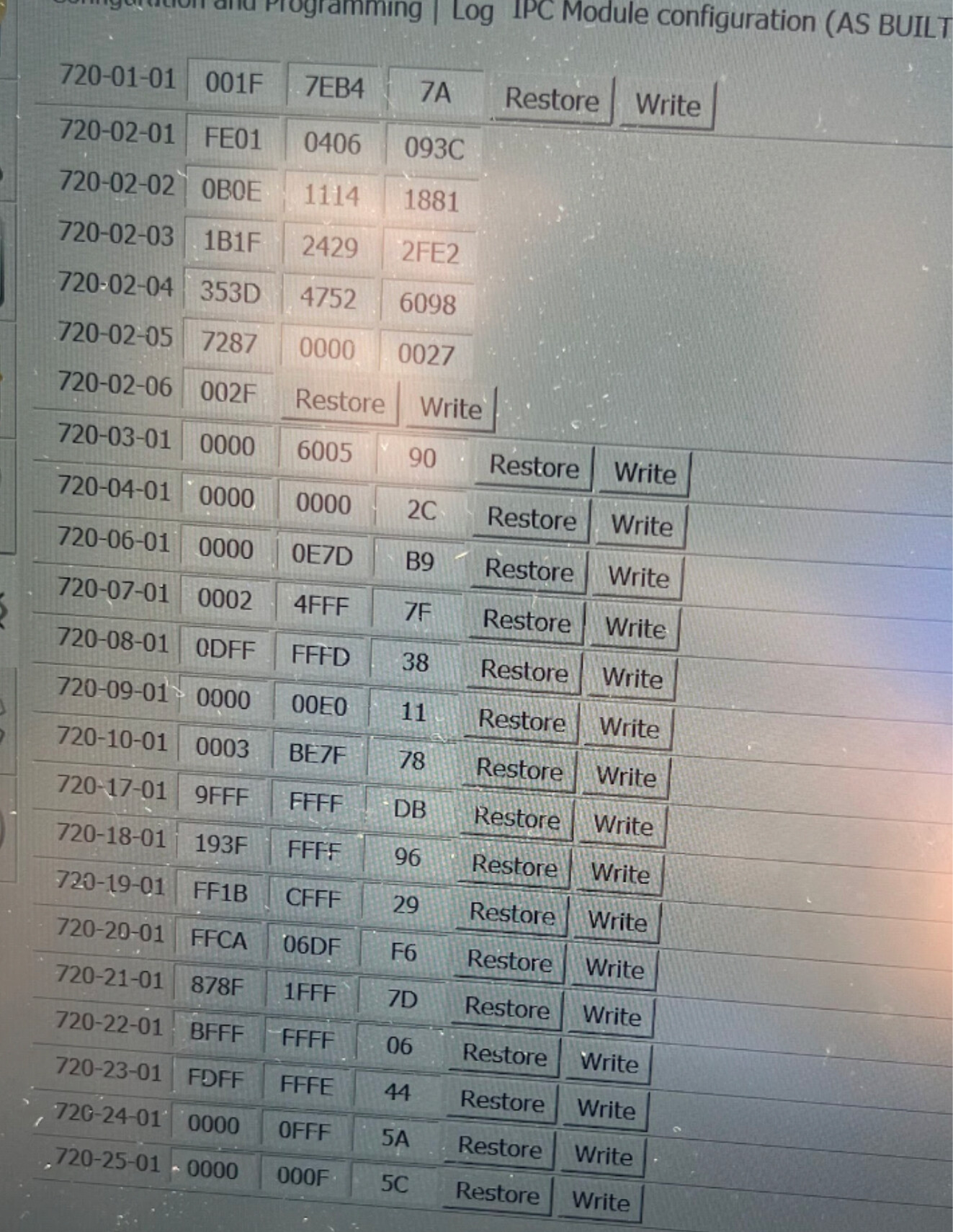

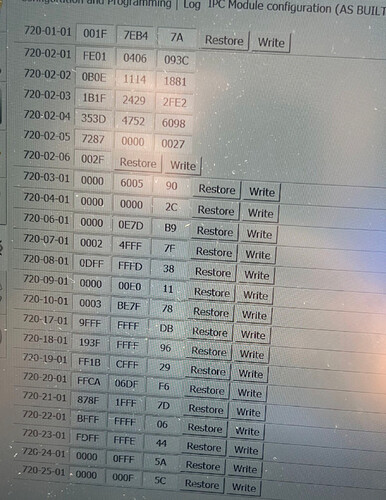

Without knowing the part numbers and year of the cluster installed, the only suggestion is to look thru the asbuilt databases for the IPC’s.

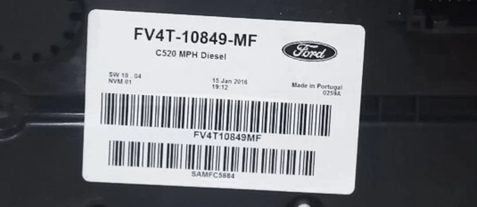

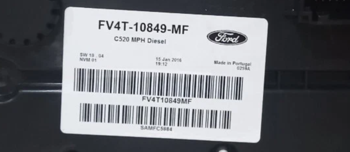

I got the model number and year here. If this helps?
That is a Kuga C-Platform.

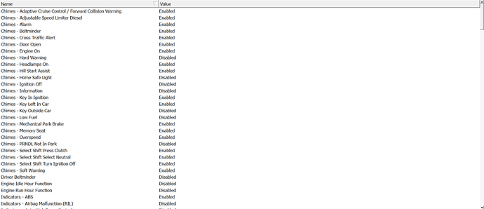

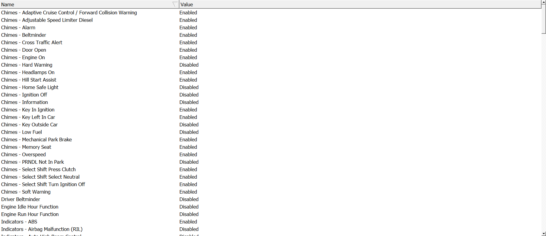

Hey so I went into the IPC configuration but all what’s displayed there is enabled and disable options for messages?
Those are features, not messaging. Look for “Fuel Tank Size”.
