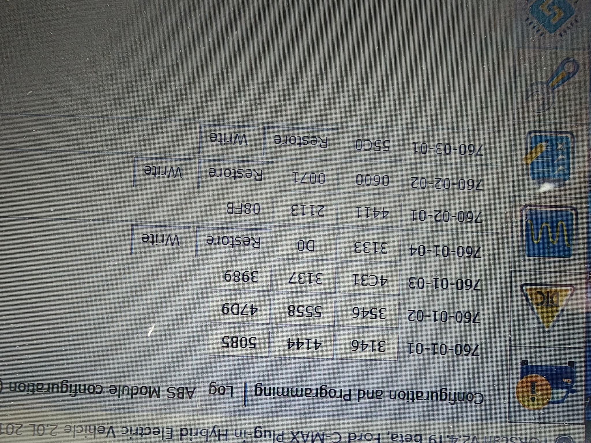

Could you tell me how I should modify the ABS module As‑Built parameters to enable ACC functionality? I’m wondering if missing ABS configuration is preventing the radar module from registering on the CAN network.image

I would message the Forscan guys and they may be able to get you a configuration that weill show it. Sometimes when you add items it will do this in Forscan.
Otherwise, Yea check to make sure your on the right Canbus. You should be seeing it and Calibrations and AB settings on other modules will have no effect.
Sometimes when you do a mod like this you run into the problem that the model/year combo didn’t have the module in it with any trim so ForScan doesn’t pick it up.
