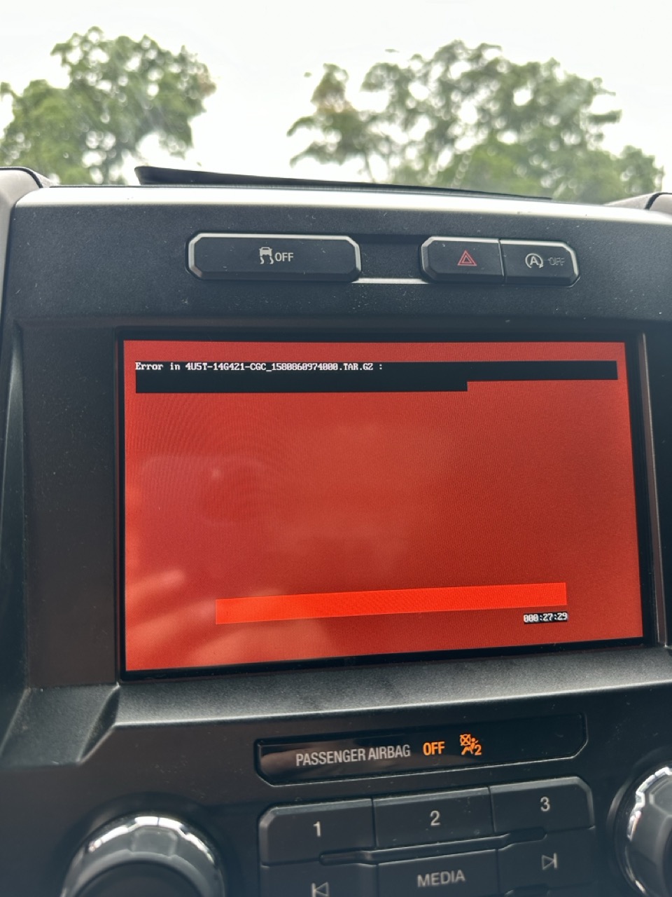

I haven’t been able to update from 3.3 to 3.4 this is my 4th try and it gives me a error after some packages have completed in the progress bar on the radio.
This is my last error message
Error in 4U5T-14G421-CGC_1580860974000. TAR. G2
I used two different USB a 32gb and 64gb. :frowning:

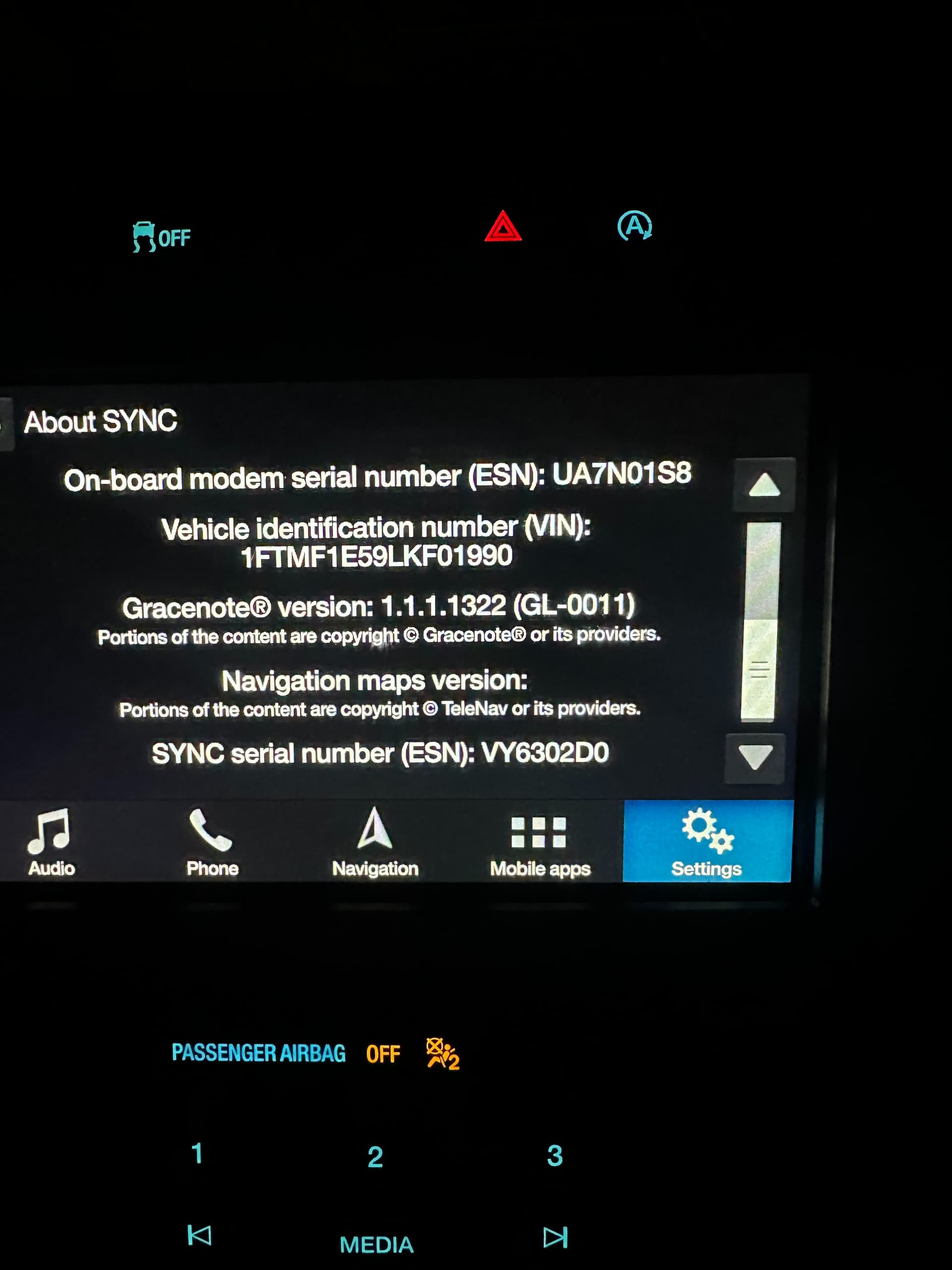

this is my sync info before the upgrade on the navigation maps version its blank?
I am assuming my APIM has nav this is a swap radio from a 2019 f150 and my truck is 2020
it gives me this error now
You are trying to install maps on a non nav unit
