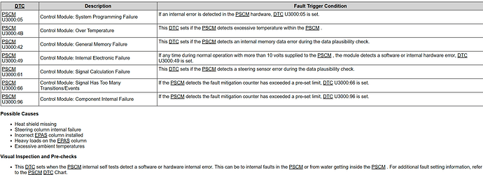

I don’t know. That’s what we’re trying to find out and resolve. The power steering issue makes no sense
I did read that entire thread regarding the RCM Bronco. I know they marked it as solved on the RCM replacement however I do see a final comment from that person mentioning purchasing a new steering column. Was there any confirmation that the RCM was what fixed it other than clicking solved?
Do you think it’s highly certain it’s the RCN module? The reset that we did of it completely removed all previus DTCs related to the airbags.
