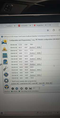

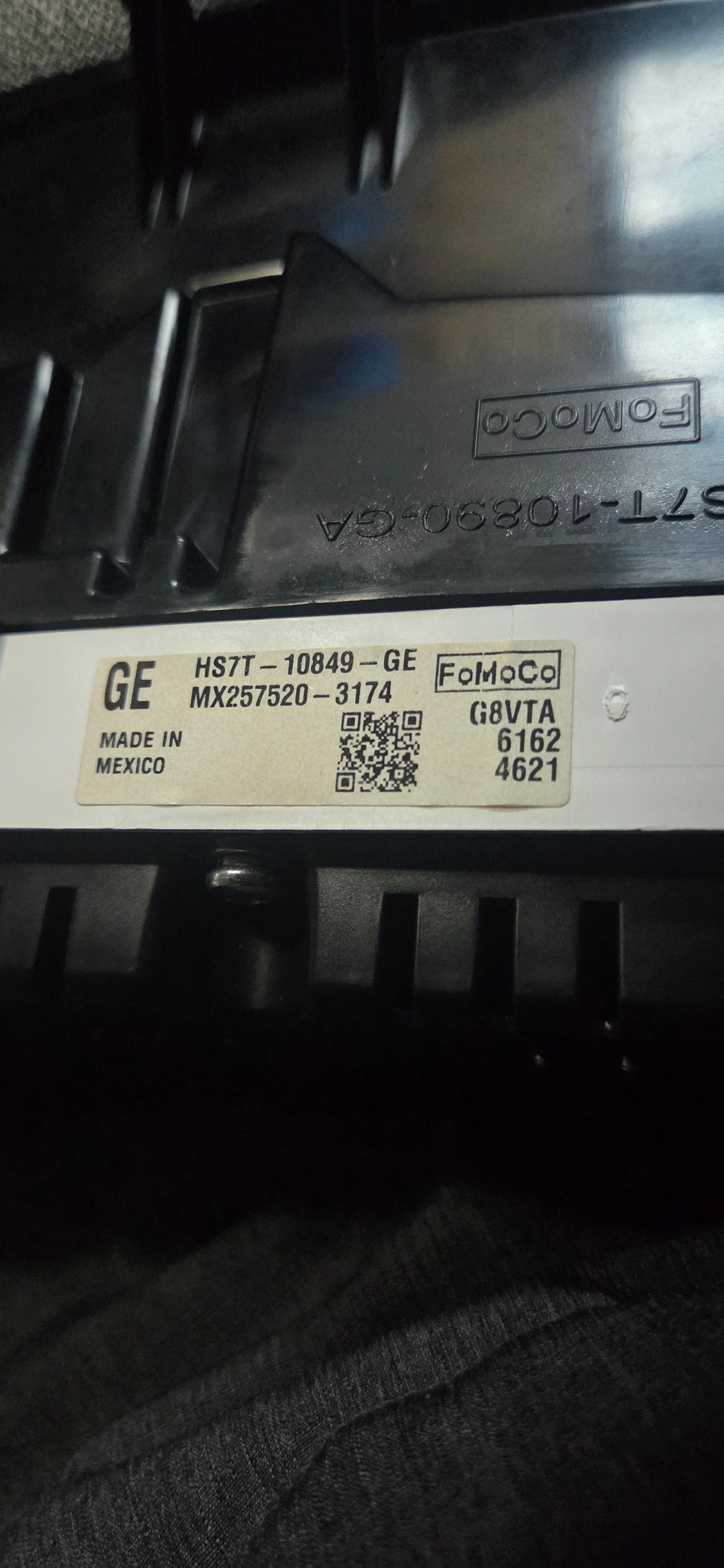

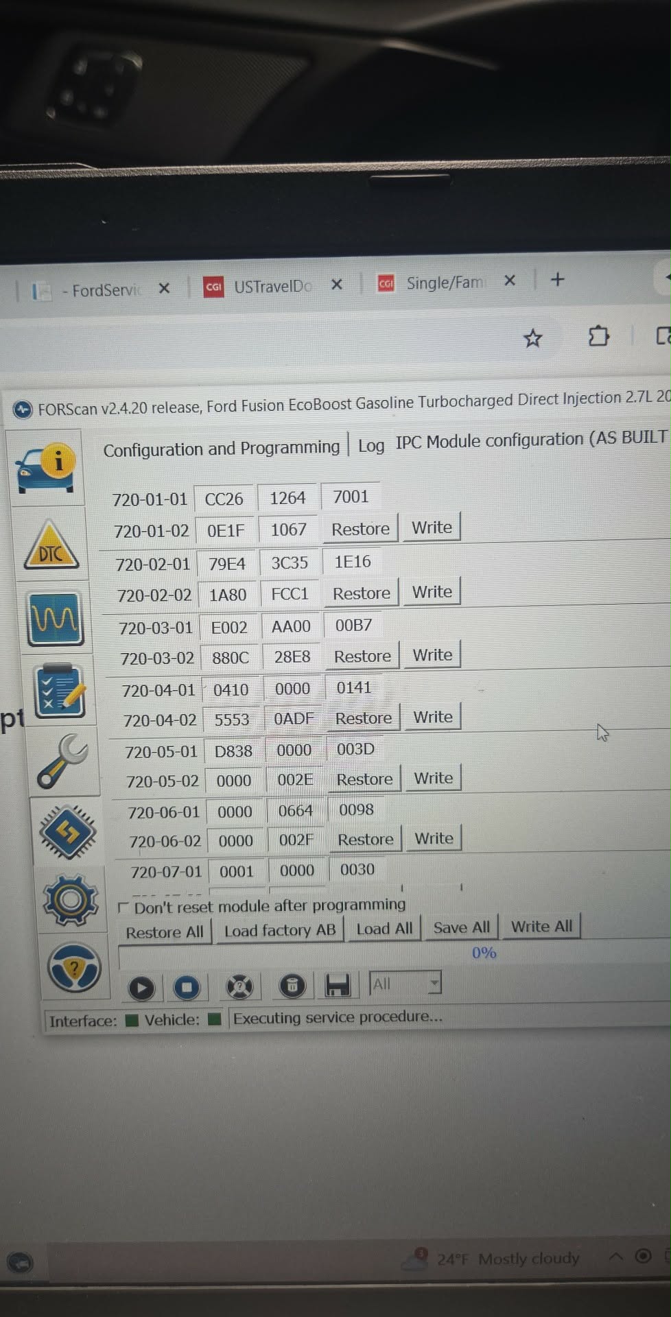

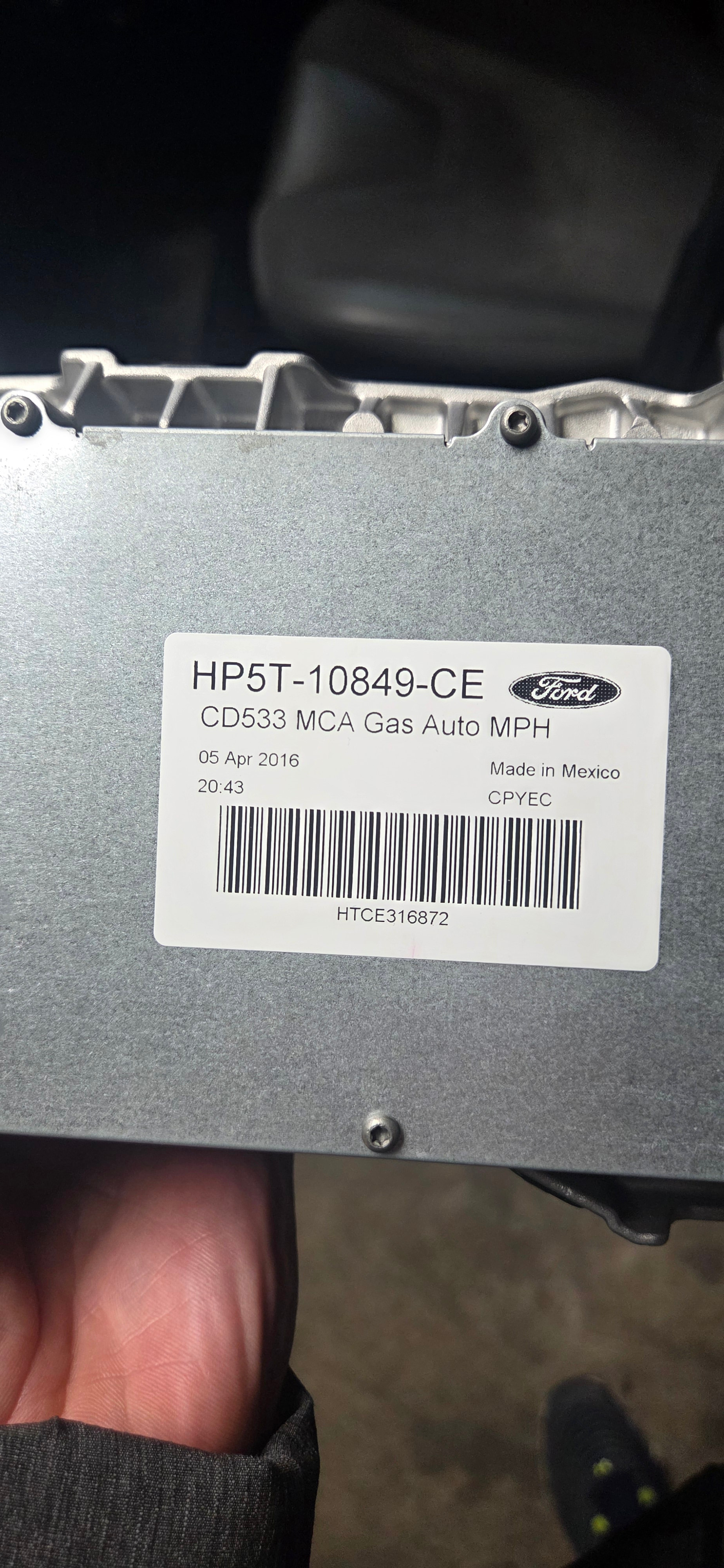

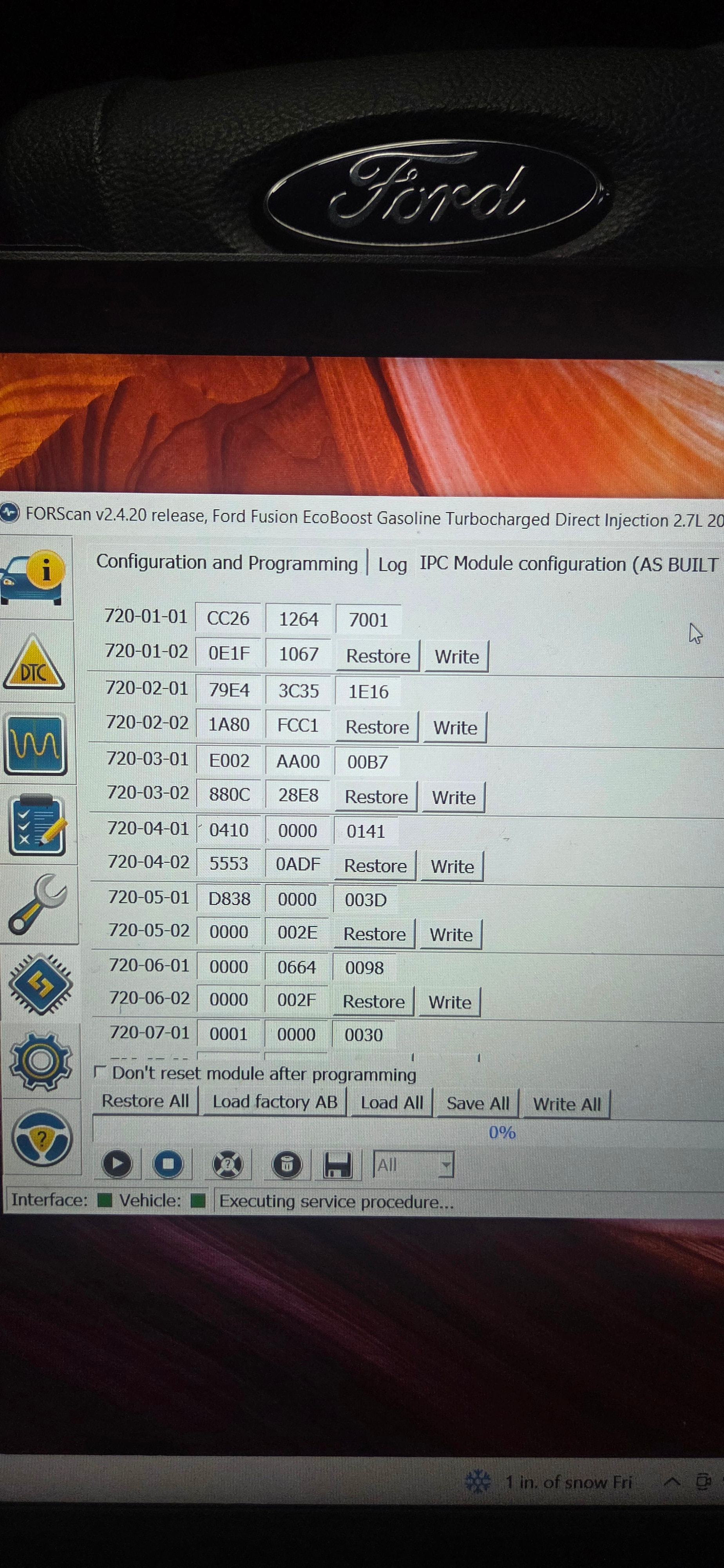

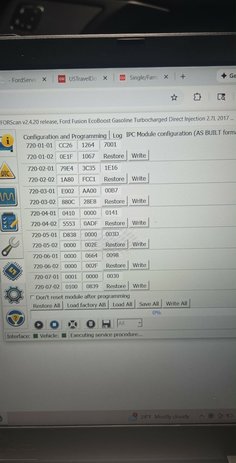

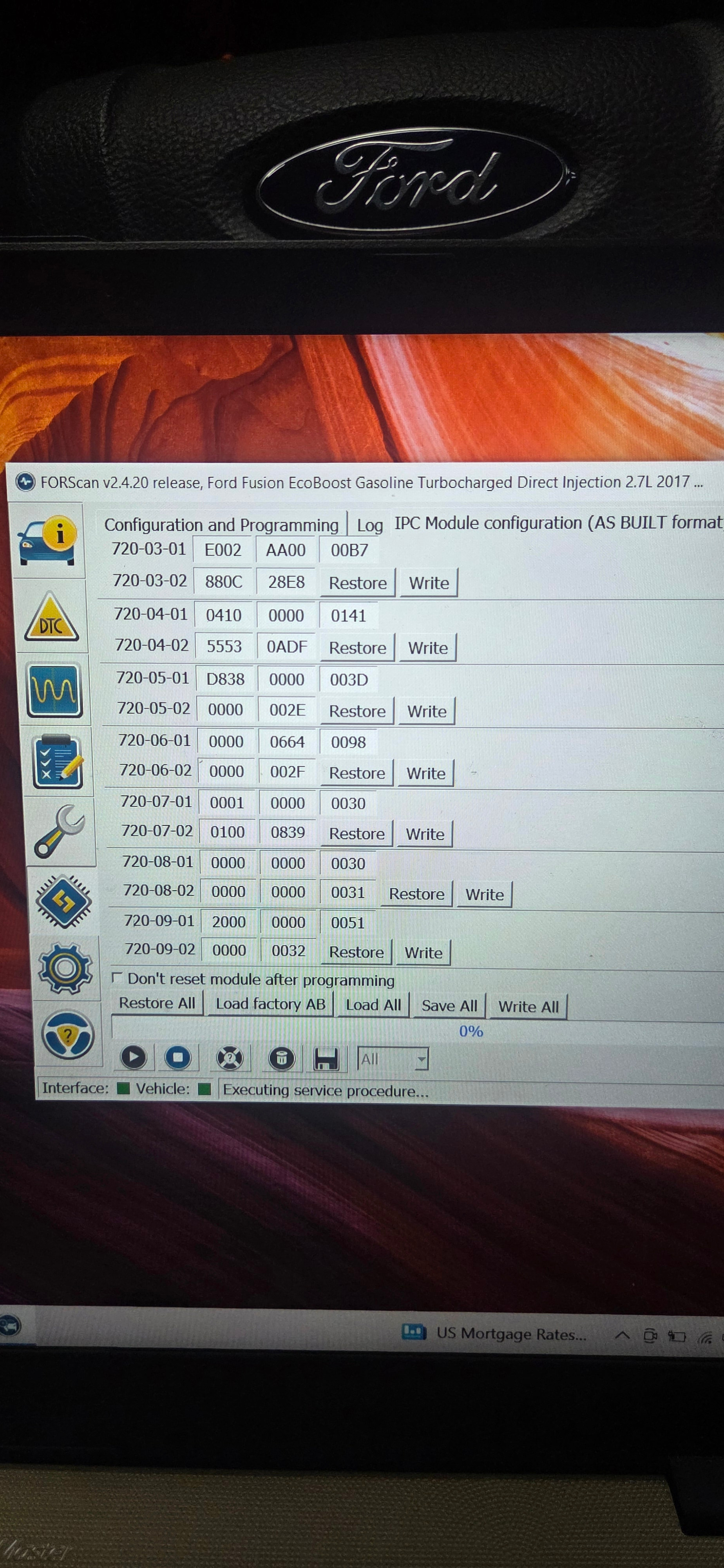

hello all i was hoping i could pick your brains about what i am doing wrong on my ford fusion MKZ cluster swap. original cluster part# HS7T-10849-GE donor HP5T-10849-CE. when i check as built data they are configured differently. i saved the original as built data from my factory cluster and i tried to load it into my new cluster but it fails saying i dont have the proper security something or another.
