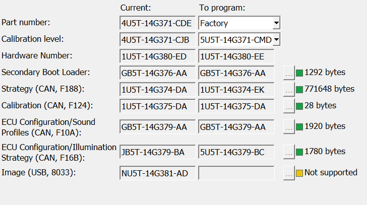

So I bricked the My20 in my Edge. I was able to get one out of a '19 (mfg date 01/19) and per Forscan it’s the same part number. Installed, everything seems to be good. It upgraded maps. All features seem to work. One question I have is it fails when trying to run the 2020 Edge’s AsBuilt. The firmware is a bit different also (see pic). Is this anything to be concerned with? Do I need to find the firmware builds from the 2020 and upload via Forscan using custom? And whats up with the last line, the Image (USB, 8033)?

Just drop your asbuilt into the donor. Should work.
Ignore that. I’m surprised the FORScan crew hasn’t just taken that out. That is the Sync app, which needs to be loaded via USB. It really should not be included in FORScan other than just an informational entry.
If you want to start enabling menu entries in the 7D0-09-xx section you will need to update your firmware to at least -EK.

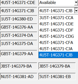

Thanks for the help. I am not seeing anything close to an -EK in Forscan.
Sorry, I was speaking of the Strategy file. If you are going to udate, use the one highlighted in the pic, -CJB.
