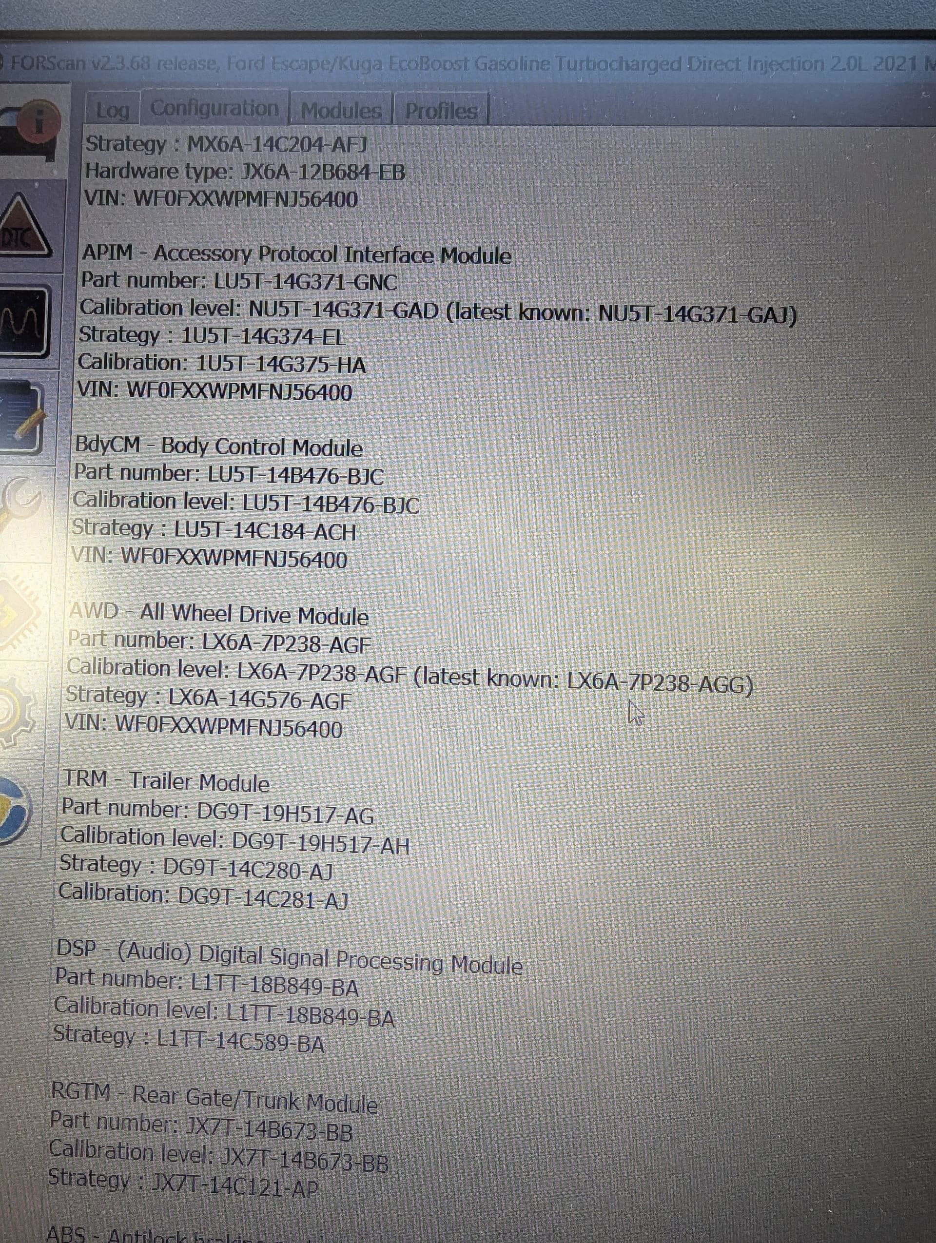

No TCU (telematic control module) showing on Forscan
Hey team.

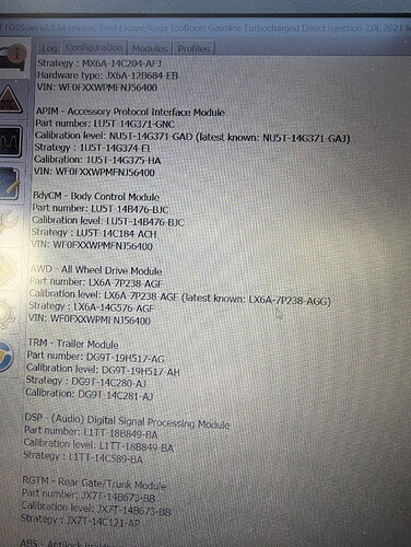

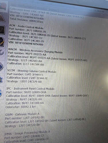

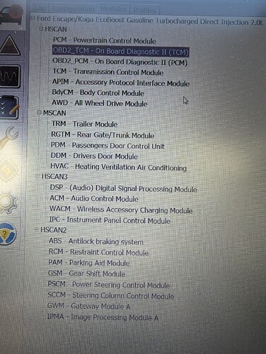

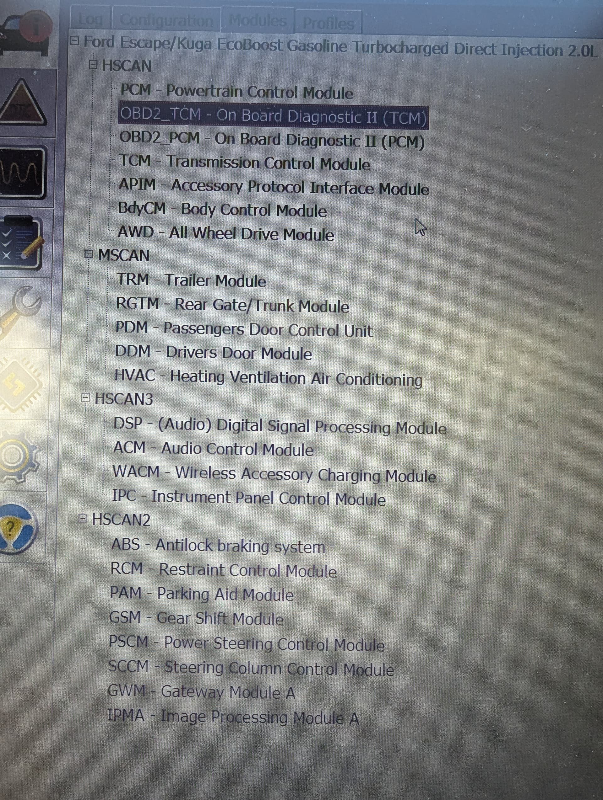

Posted last week ref my stolen recovered Kuga MK3 2021. I have connected Forscan to get status of the TCU which I suspected was disabled/removed. It is not showing, I take it this means I was correct ? Can you have a look at uploaded pics and see what you guys think
My experience of stolen /recovered vehicles is that stuff get’s unplugged all over the place in case the module contains a tracker although a Kuga is one of the least likely vehicles to be stolen.
You need to look at your OEM asbuilt to determine if thisd is correct. In that file you will find the SN of the TCU also if you care to file a claim.
