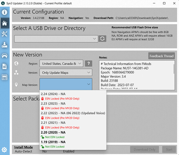

Back to the map update.  My first attempt is a fail.  I ended up with the gps location, but no maps overlay.  I’m wondering if the youtube video is just out of date.   I think I’ll start from the beginning, and try once more with the map extraction method before I ask for help on your method of bypassing the esn lock on the maps.
I did notice the only way I could download the esn locked maps was to go in to advanced, and tell Syn3 Updater to bypass the My20 issue.  This isn’t in the video, and makes me wonder.
