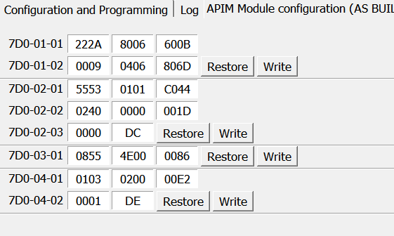

And here are the current APIM as-built values I have set in the Fusion:

7D0-01-01 xxxx xxxx 6x
7D0-02-02 xxx0 xxxx xx
Like such? I wrote that, and it did not change anything. Still the same issues here :confused:
Those were the obvious ones from a Fusion SE that came with MFT.

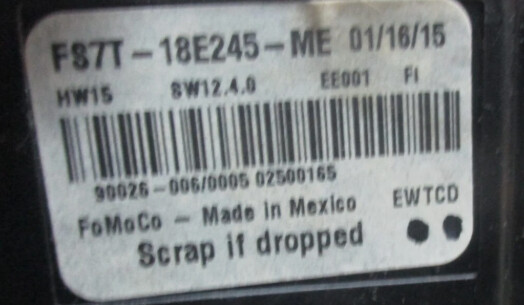

What year did the donor FCIM come from?
2013 can be used in the 2014-2015 with the firmware updated, 2014-2015 had a TSB for remote start climate issues that required a calibration update, 2016 can be used since the only change was to get rid of the cap touch buttons.
MY2017+ is where things start changing due to Sync3 and getting interesting, as an example the putting the seat buttons on the screen works without any problems on the 2017-2019, take the same APIM AB settings, drop them in an L series APIM and it kills the button functions on the FCIM & screen until the firmware in the FCIM is updated to the last release.

As for the FCIM, that came from a 2015 Ford Fusion part number: fs7t18e245me
