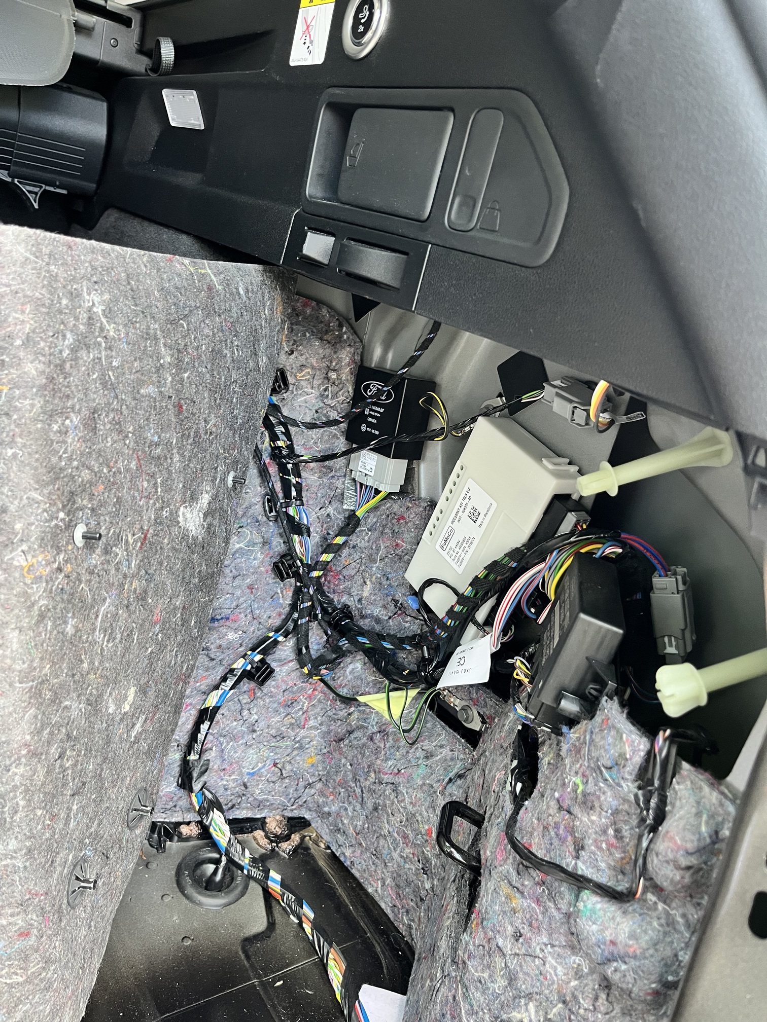

Left is totally empty, right has park assist , towing, and smth else, but no TCU.
Here’s photo of the right side.

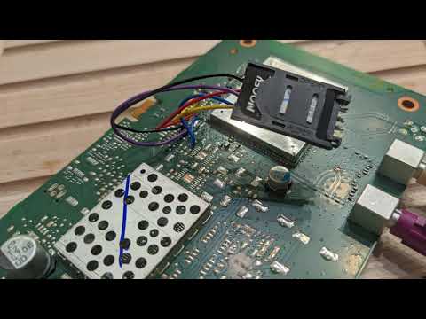

So you are doing this…
Vehicle hotspot and FordPass works well.
You still need to have a TCU suitable for your country’s frequencies. For America - American TCU (TCU-B2 for example), for Europe - European TCU (TCU-E2 for example).
In addition, since the modem’s mobile number changes, Ford servers can no longer wake up the modem when a command from FordPass is executed, currently there is no way to fix this.

Just to confirm - TCU in 2023+ ford focus is under the central console, almost at the floor level. Removal required full disassembly of the tunnel and central console, removal of APIM and radio. Quite difficult. Soldered sim holder to esim chip and works like a magic with ford pass app. Still, after shutting down the car, TCP falls asleep in 20 min and ford pass app can’t wake the car, as it uses the genuine esim number/address… happy anyway.
