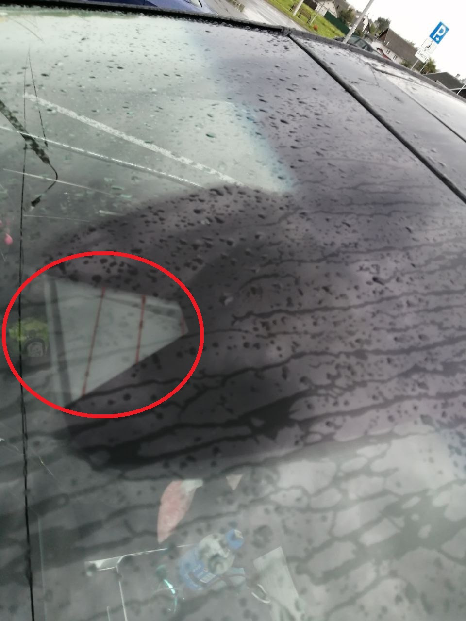

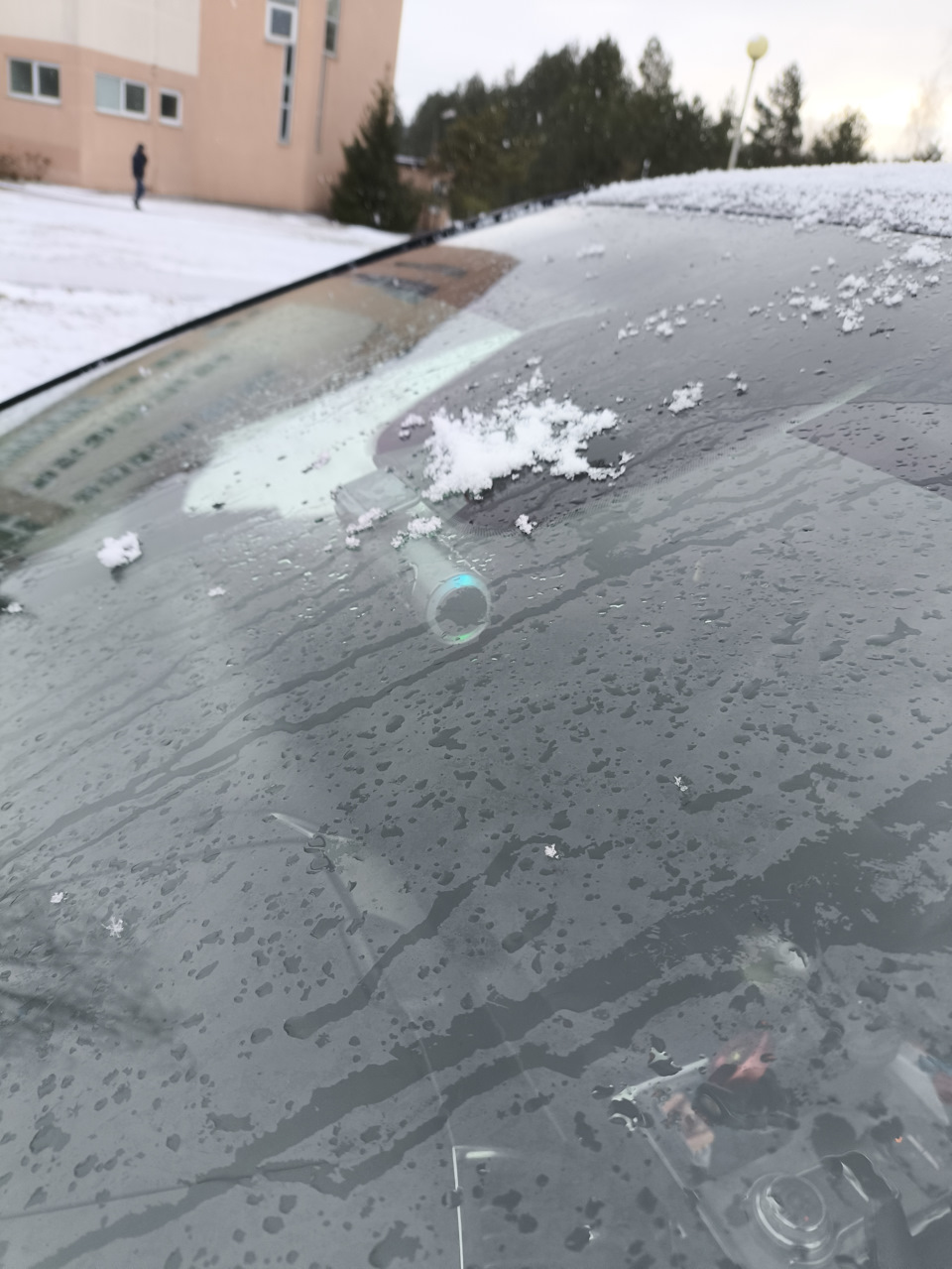

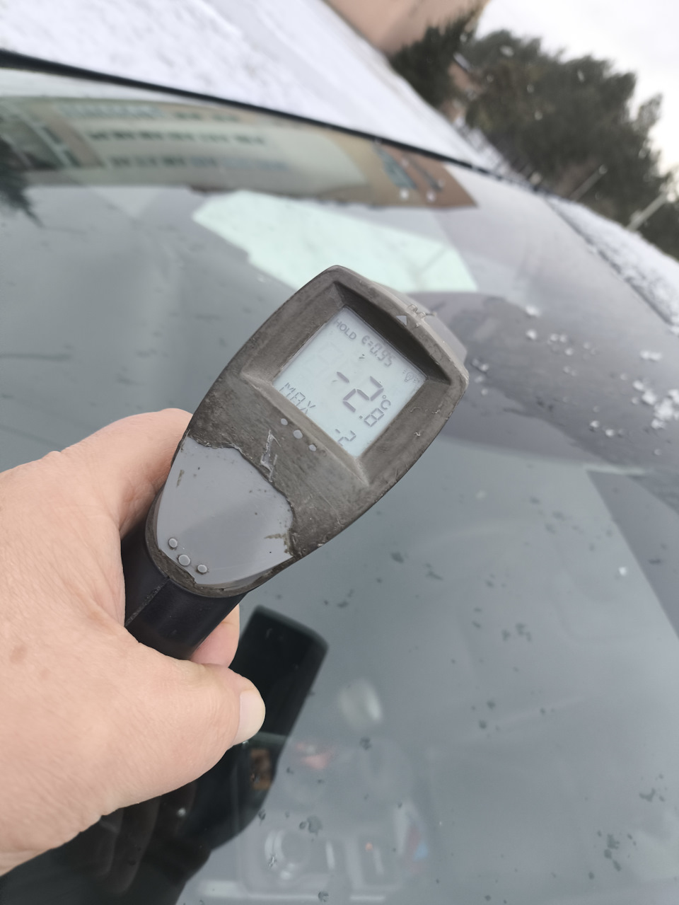

The camera heating suddenly disappeared. Tell me what I can look at and check?

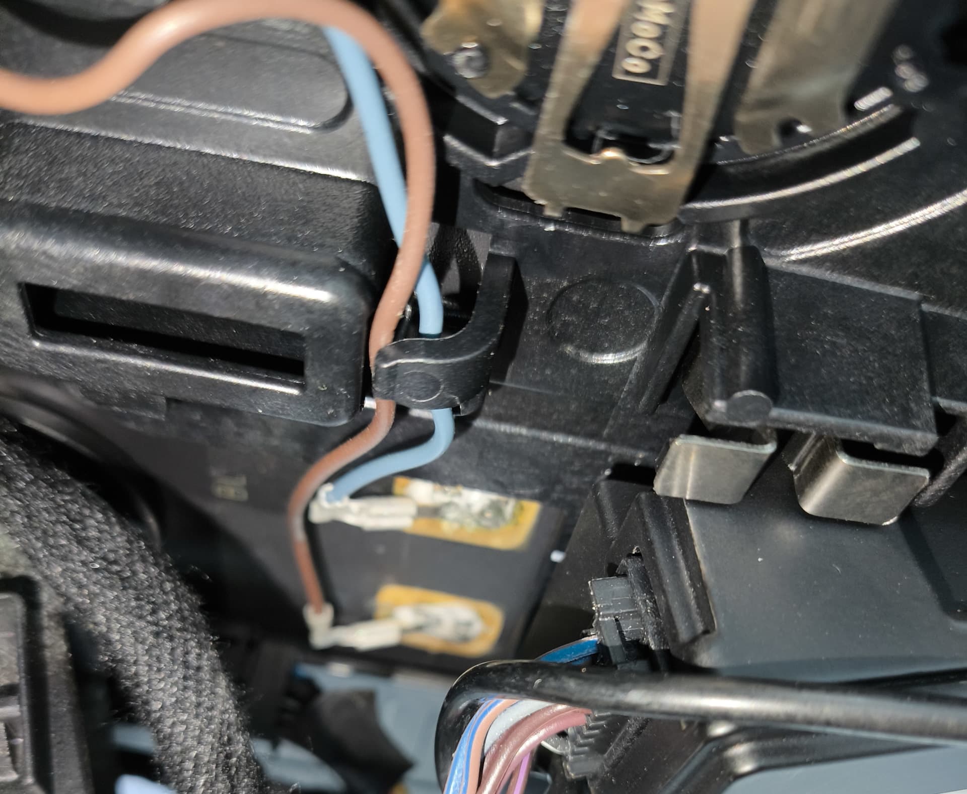

The soldering looks good.
What’s the resistance across the wires if removed from the terminals?
I’ll try to measure it tomorrow.
The heating grid has resistance. The suitable wires do not.
If you have resistance directly at the grid and don’t have it at the wires leading to the grid you have an open wire.
Thank you. I will check. I will let you know the result.
As I understand it, there should be resistance on the wires removed from the chips. Is that correct? Should the general heating be on?
You check each individual wire from end to end, resistance on the wire should be less than 1 ohm.
