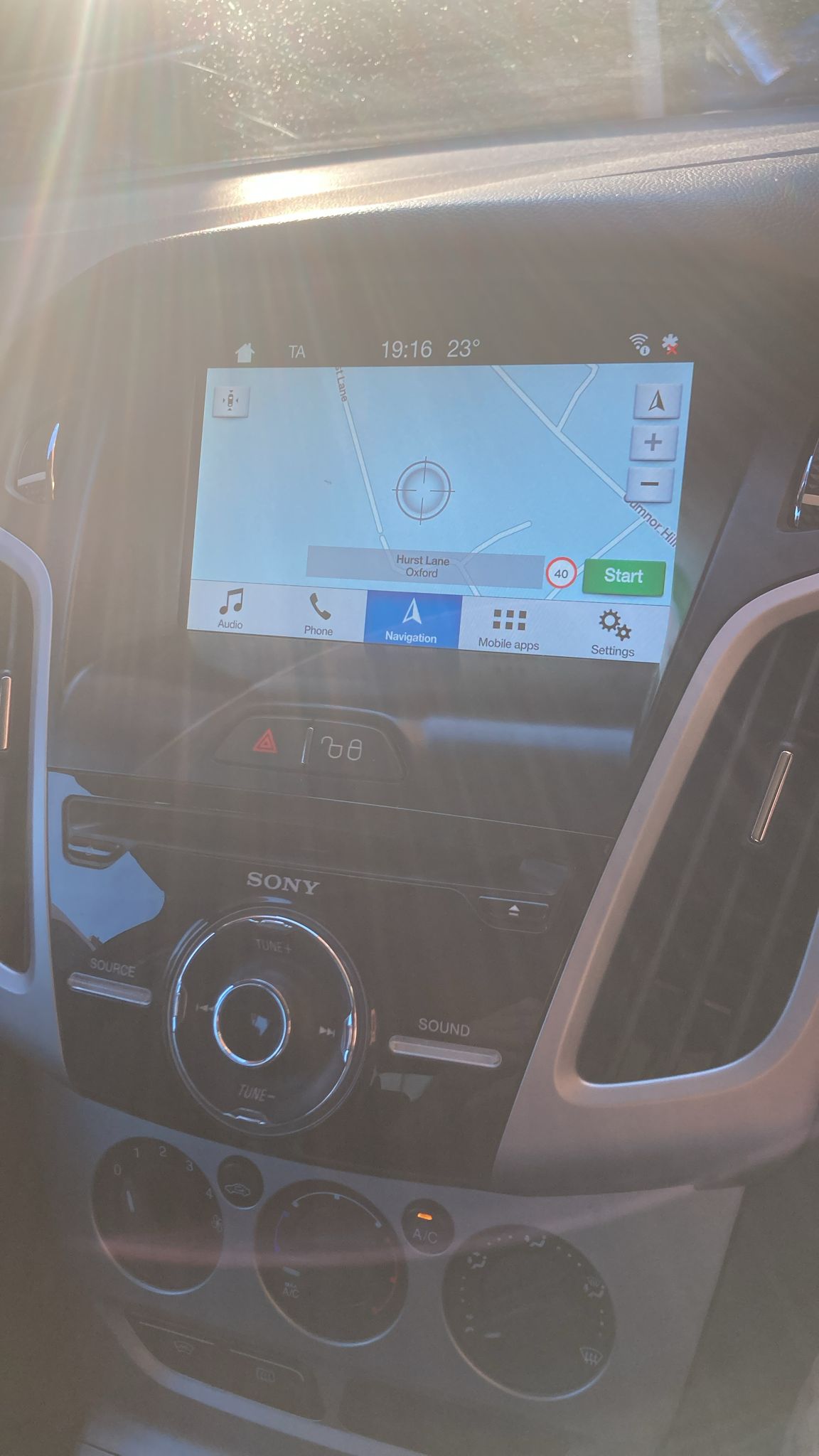

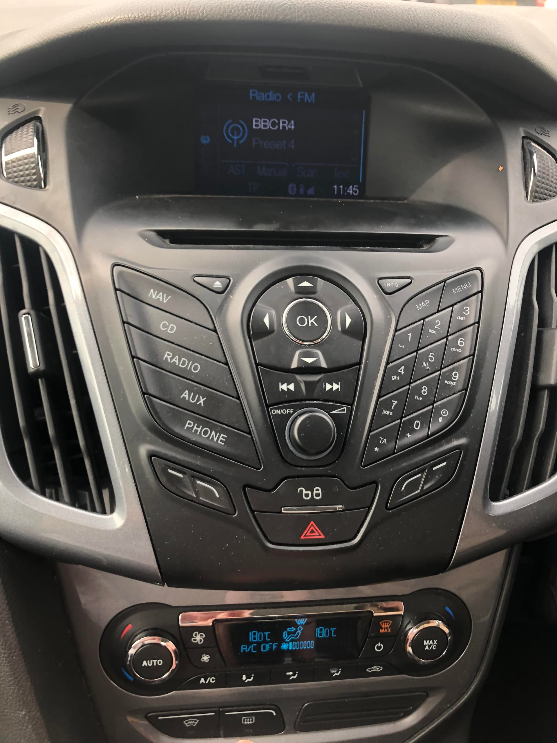

I’m retrofitting a radio from Sync 1 to Sync 3 in a 2011 Ford Focus, and we’re using an original radio from another donor Ford Focus. The radio itself already has Sync 3.0, but I don’t have Navigation Voice or Bluetooth voice. When people call, they can’t hear me, and I can’t hear them when they call me.
I can’t log in, and it doesn’t even show me the APIM Module configuration section (AS BUILT format). And I paid for the one-year version. Basically, it won’t let me do anything in ForScan.

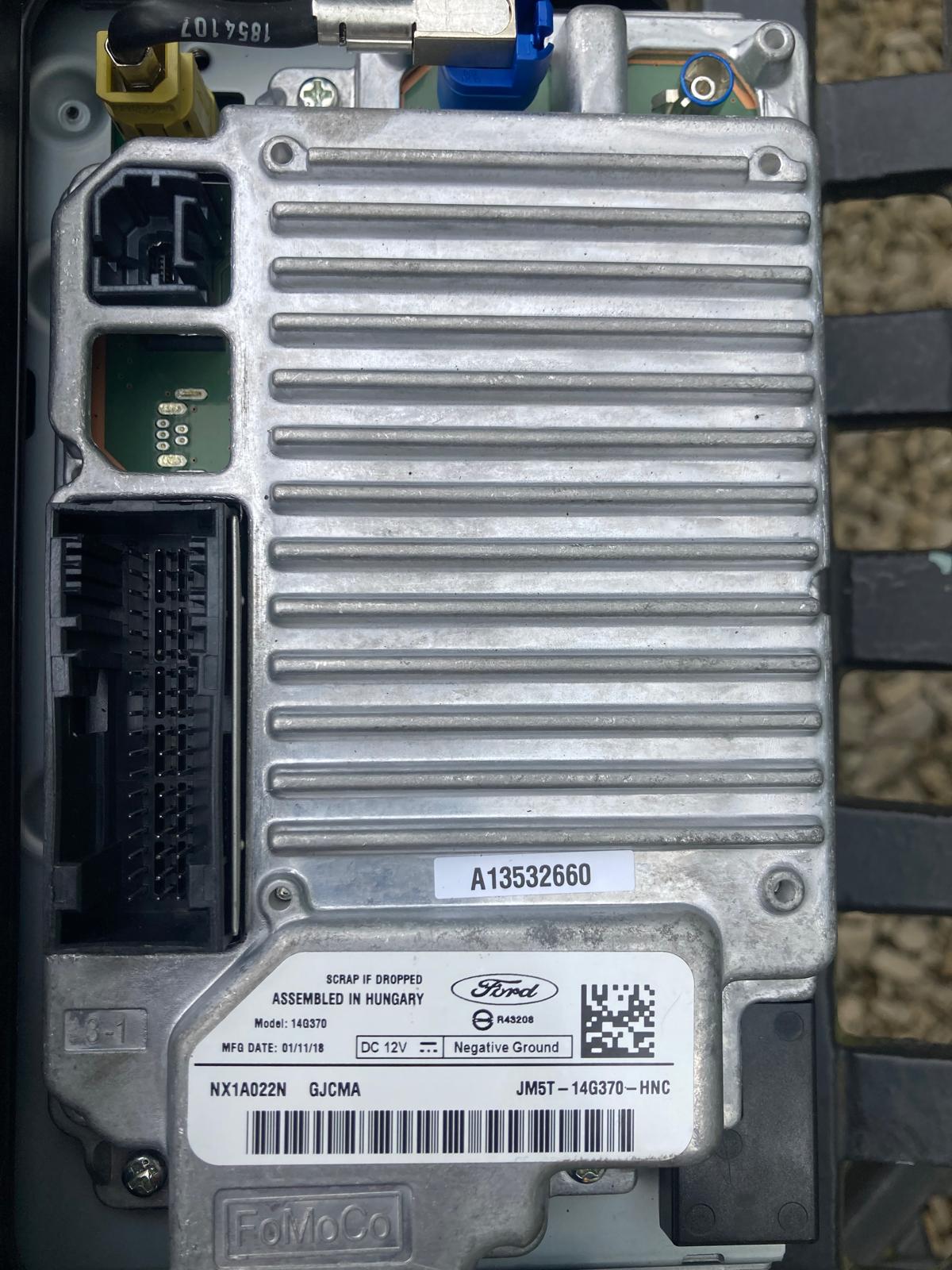

OEM Radio from donor.

How can I know how much capacity the radio has and where I can look exactly?
