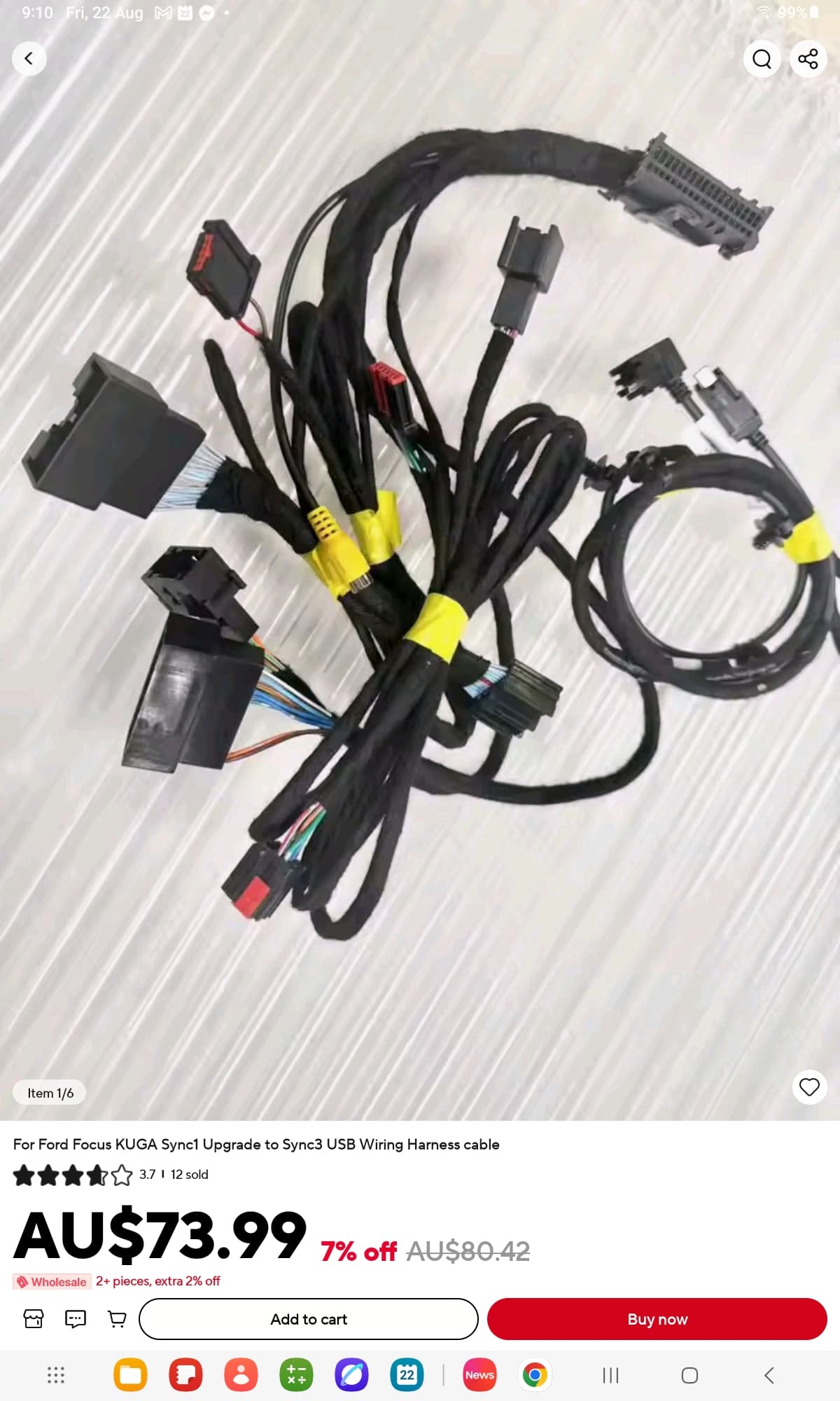

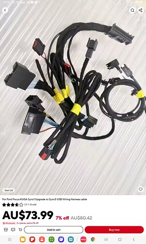

It depends. What harnesses did you use to do the upgrade. And what exactly are you experiencing with that camera. Pictures would be useful.

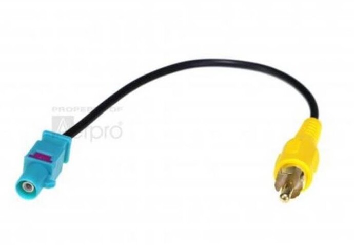

Did you use an adapter to make that connection to the yellow RCA? I ask because i have read that the people were having connection issues with that adapter.
