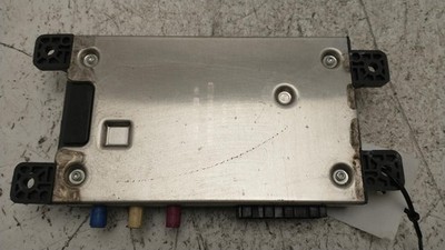

… One more question: This is the TCU I have installed:
TCU - Control Unit - Telematics Module
Part Number: LB5T-14G087-XH
Calibration Level: LB5T-14G087-XL (latest known: LB5T-14G087-XR)
Strategy: LB5T-14G139-SL
If I need to buy a new one, what should I be looking for? The part number? I can’t find anything ending in XH…

There’s no battery in the TCU its powered by the vehicle 12v battery.
Is this vehicle a NA/US import or an EU original?
The part number showing you more than likely won’t find directly, you can try to use ForScan 2.4.x )paid license) with a GOOD OBD2 adapter like an OBDLink Ex to flash the firmware up to -XR.
Pull the update files down first, the TCU files are one of the larger download, applying takes 45-70 minutes and the car needs to be on a battery charger the ENTIRE time with the engine not running (so that the idle shutdown doesn’t kick in and brick the module).
Even if you replace the module yourself, you’ll need to follow F150Chief’s doc regarding how to active a new TCU. The last 2 characters of the part number are usually current factory flash level and or a reference to the bracket is attached for mounting to the 4 screw holes as the same module can be in different models.
