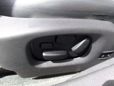

Facelift controls:

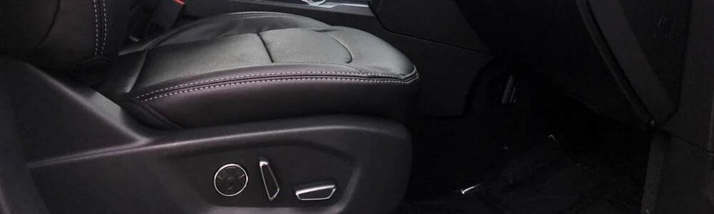

Taurus controls:

Yes, it looks the the taurus has the massage module, and then the button which is separate from the seat control module rather than combined.
Usually there is not a physical button for it. It is controlled through the FCIM screen as a Sync function over Canbus. Based on your pic there are physical heated seat buttons also if I am seeing that right.
There’s a button on the newer seat modules that pulls up the menu, then you can either control it with the arrows or the module (at least on the sync 4 fords with multi couture) pretty sure those buttons are for memory on the Taurus.
