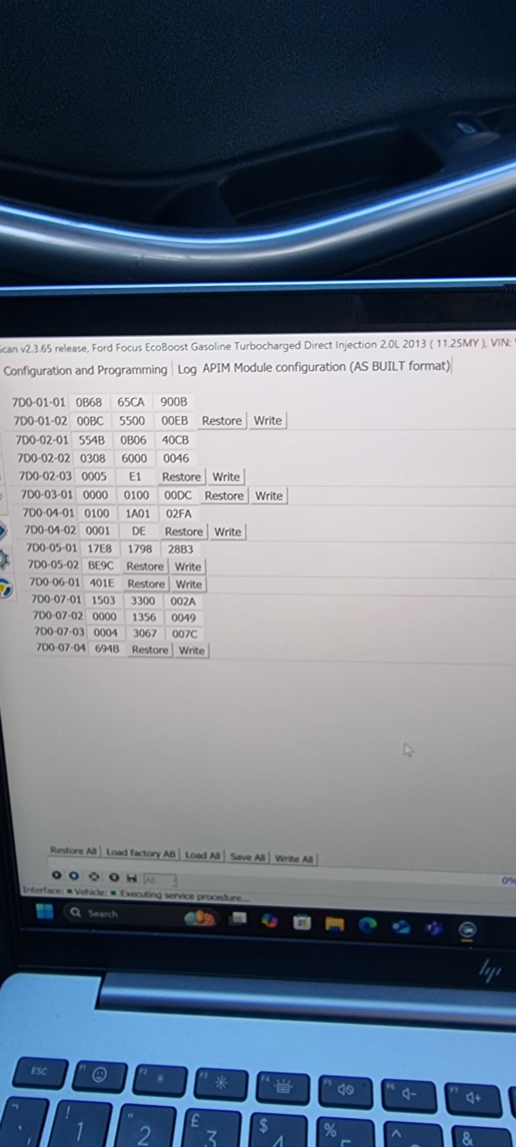

Hi, I have fitted Sync 3 into my 2014 Focus ST3 UK car, non nav apim. For the most part it functions fine however I have a few issues if anyone can help with?
  1. The clock was wrong and I couldn’t adjust time, I have since changed 7D0-01-01 ##XX (from 68 to 28) which I can now set correct time however when ignition is off clock goes to 00:00

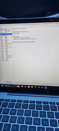

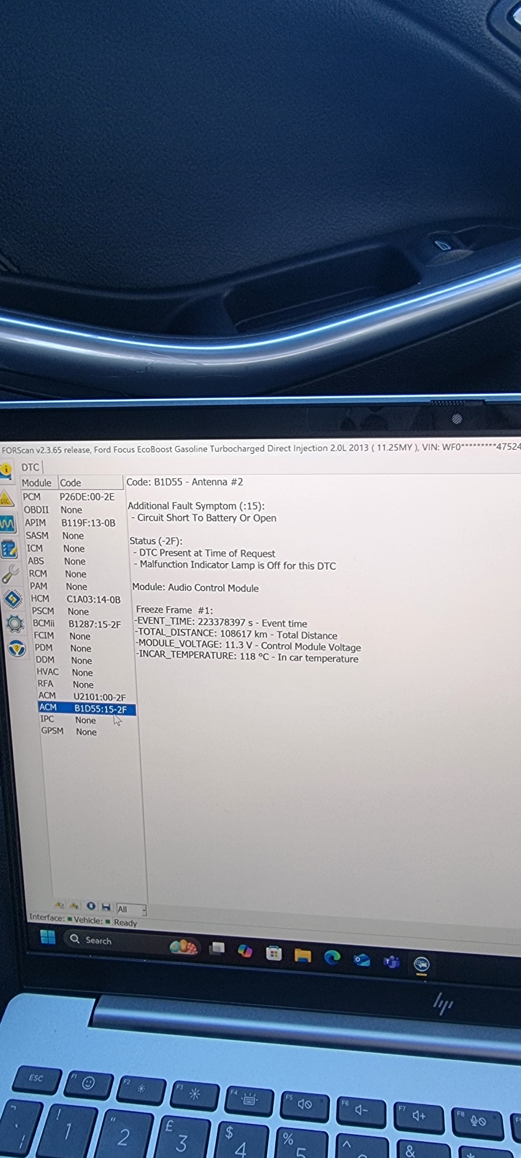

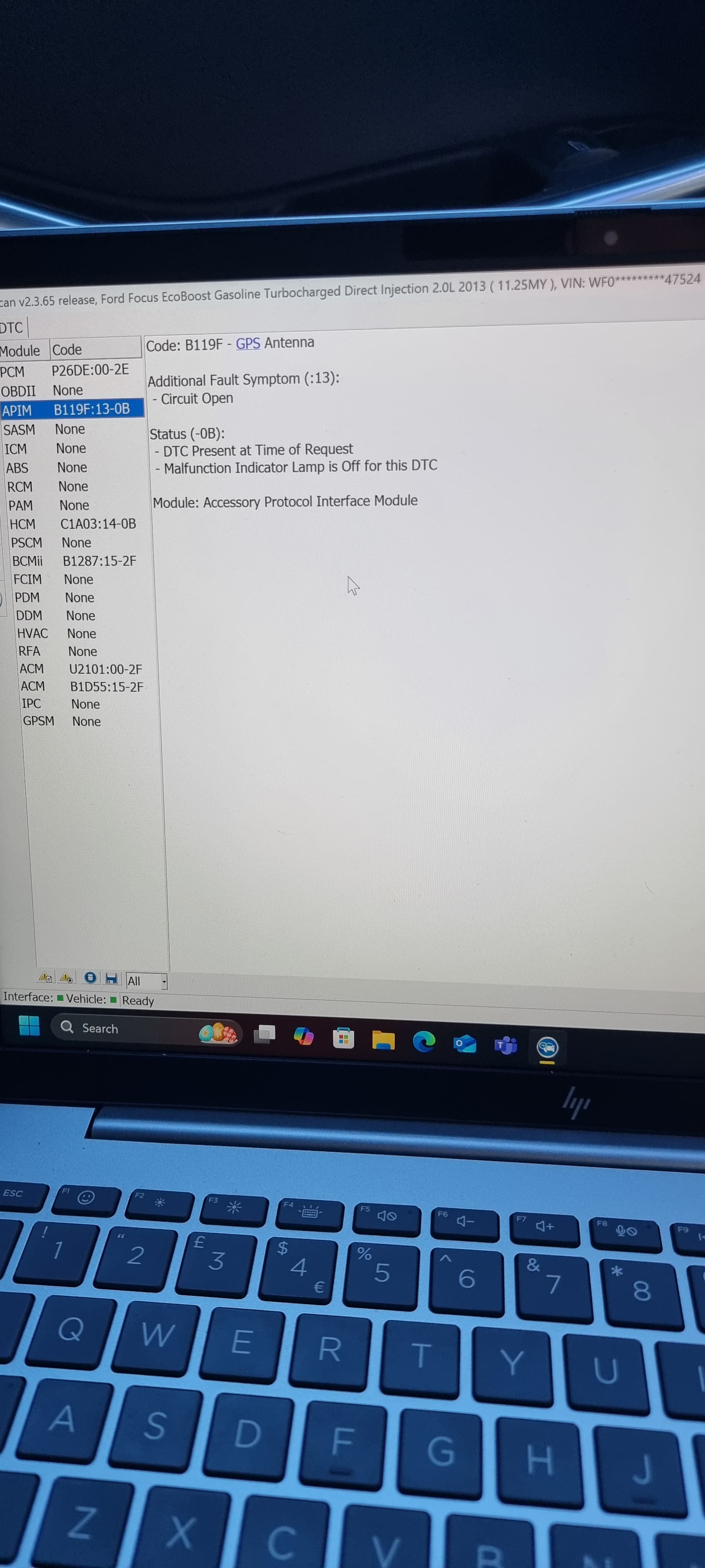

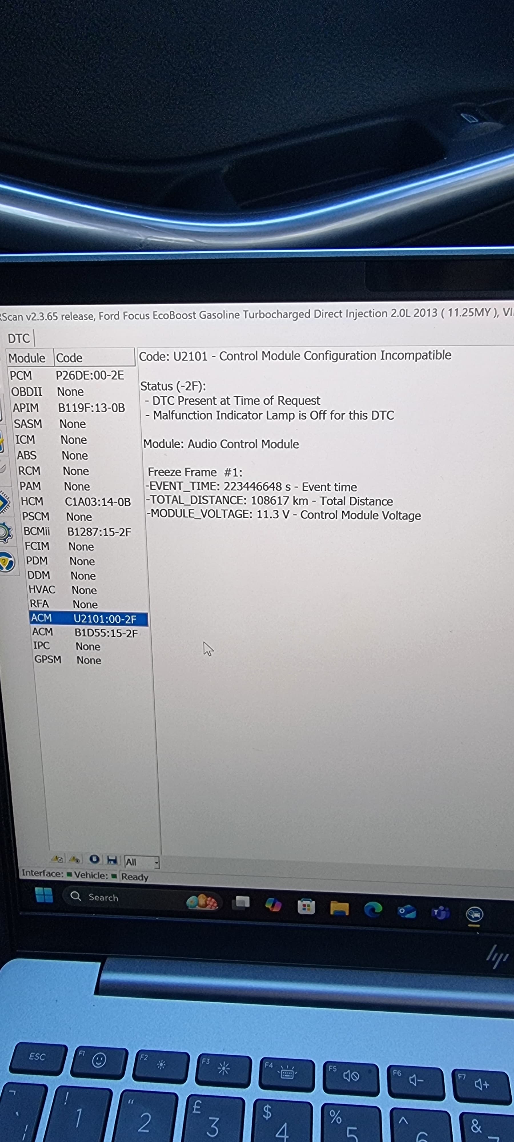

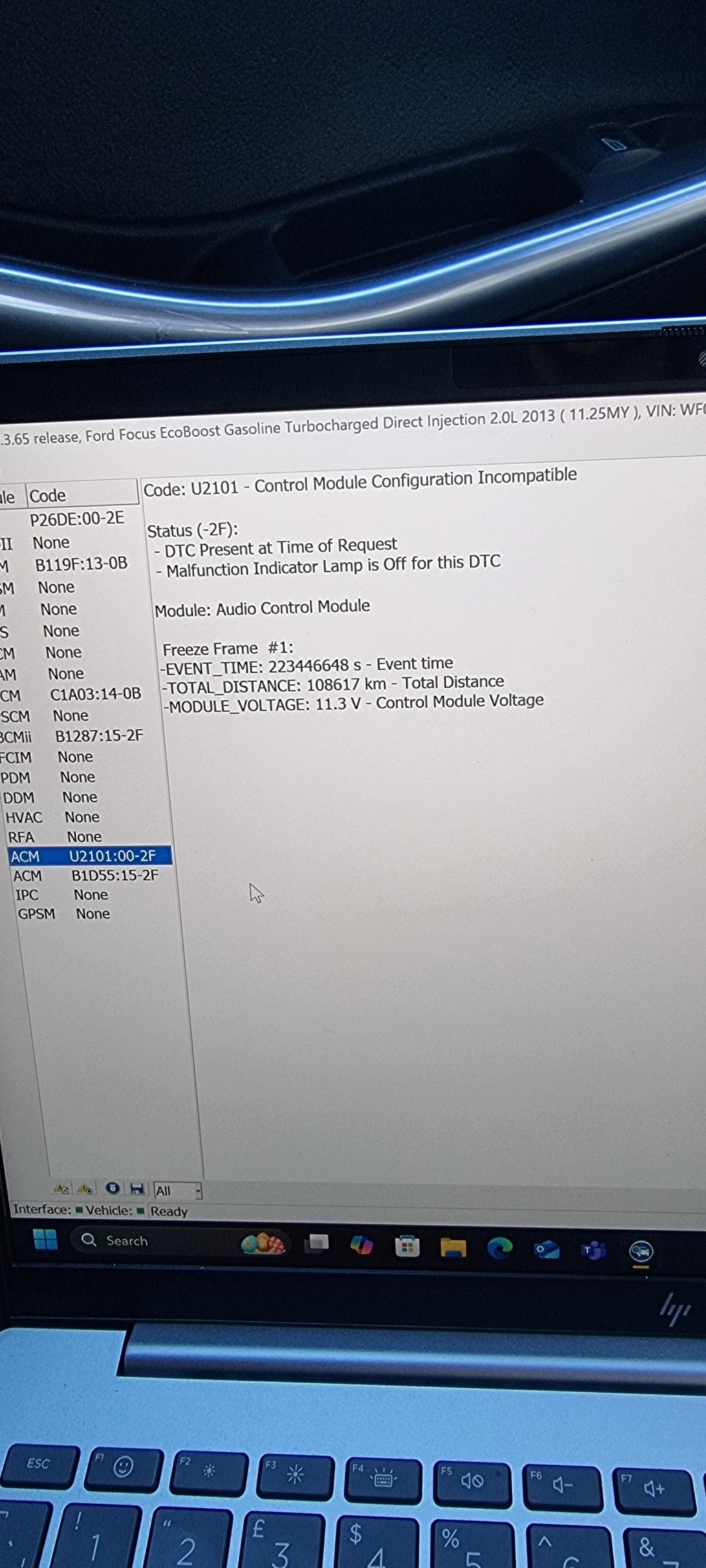

  3. I have the below DTC’S active which won’t clear
![20250405_102055|225x500]
First thing, fix your antenna issues and you will be able to fix the rest. See this thread for reference…
GPS open circuit error after MFT to SYNC3 upgrade solution? - Ford / Discussion - CyanLabs Official Community
