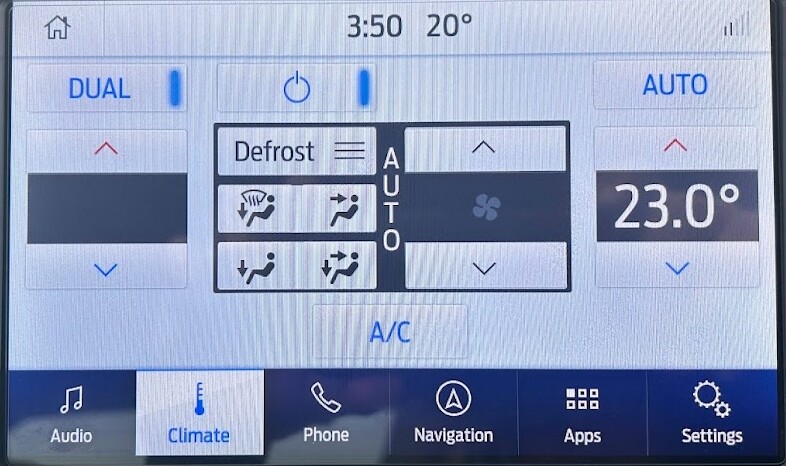

Sync 2 to Sync3 No climate controls screen

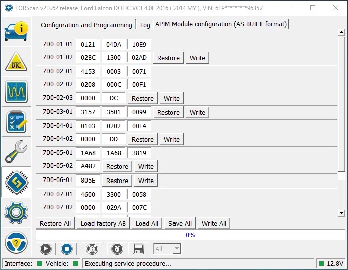

Try these settings the Supplier that provided me the Sync 3.4 upgrade helped me work thru the climate settings. The Emergency Call assistance feature was disabled on a popup however the engineer turned this off.
The climate control shows as dual however that is a limitation of the Sync 3.4.
