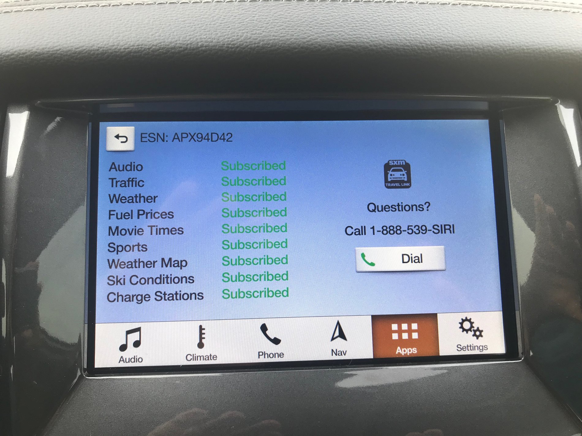

If you go to Apps in the Sync menu, and since you have Sirius Travel Link, look there to see if the RADIO thinks it’s activated. What is on the account info could be wrong, or the ID number could be recorded incorrectly in their system for the vehicle.

I have the Travel Link - it says unsubscribed - When I change to Channel 2 it says radio is not activated

In the subscription section, it specifically lists SiriusXM radio (AUDIO) as the first item. If that says unsubscribed, then the issue is with the activation of SiriusXM with Sirius, not the truck. (Unless you have a bad ACM…)

Audio is the first listed - unsubscribed…
