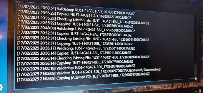

Youāre getting an error when it tries to copy to USB.
- Reformat the USB as exFAT without the quick option checked so that the bad blocks are de-allocated
- USE a good quality USB (eg SanDisk, PNY, Lexar), some cheap ones overheat on extended file copies
- Try another USB port on the PC, you may have one which is badly worn.

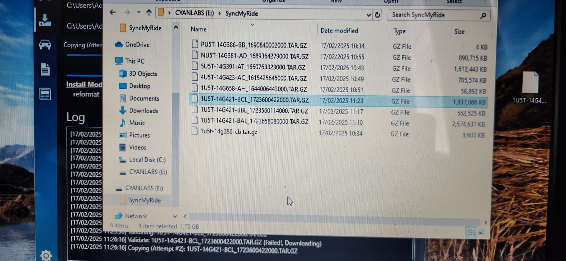

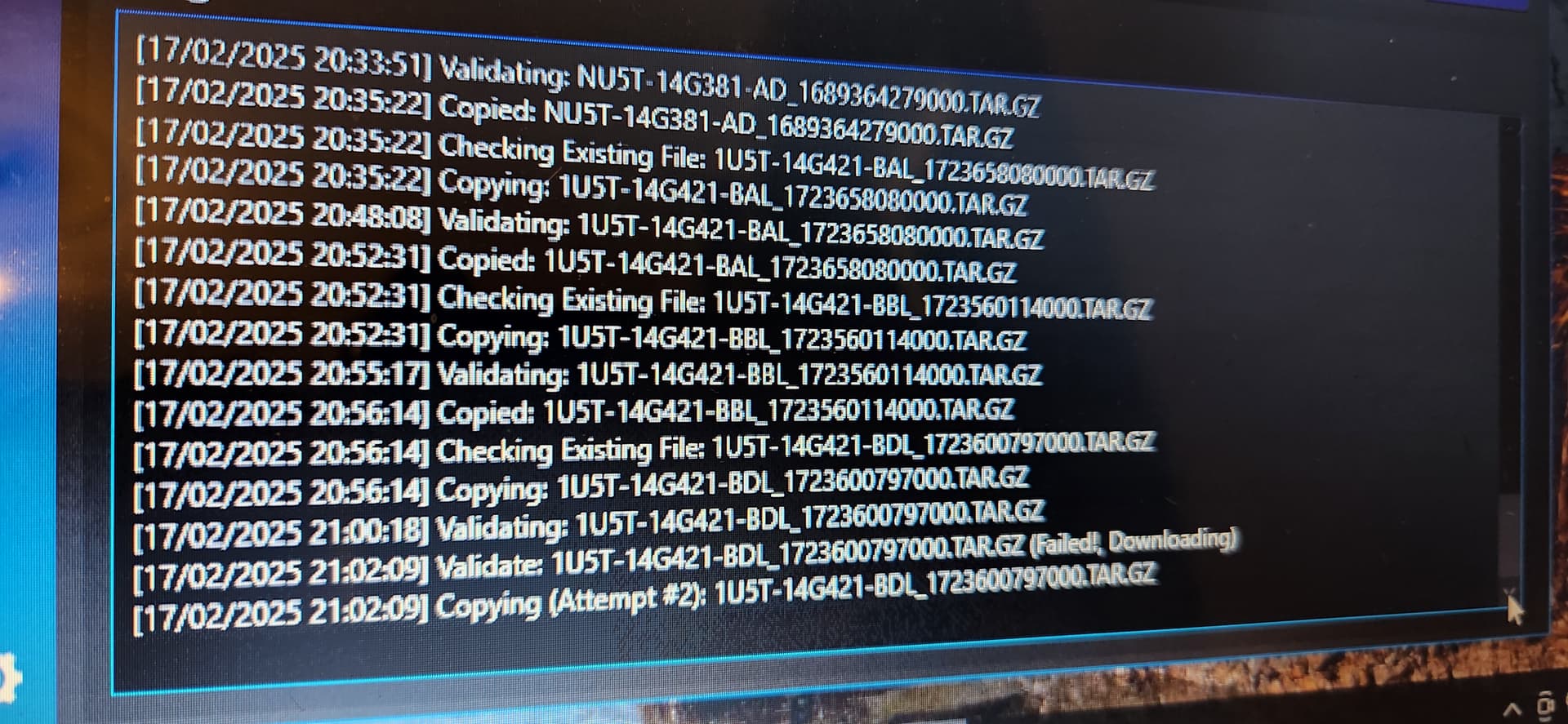

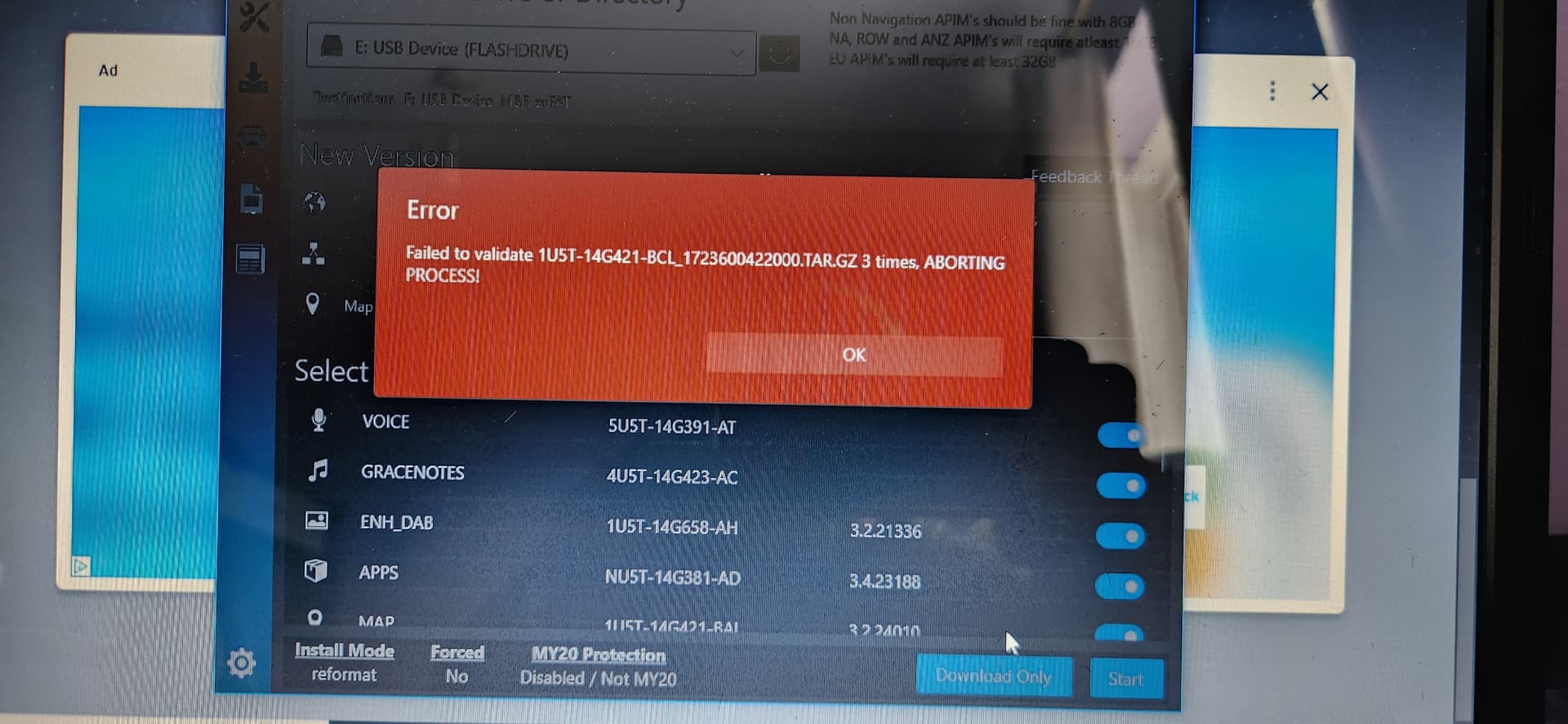

Well i wrote an explanation to what was happening aswell as uploading them pics but the part i typed must have disappeared when i uploaded the pics, i seem to get that error every time i get to that exact file, done it a few times on the download process but now its doing it on the copy to usb
Even though when i open the file on the usb drive ot shows that its copied ok, but soon as i press ok the it aborts and leaves the usb blank
The checksum or md5 on the file doesnāt match so it deletes the file as corrupt.

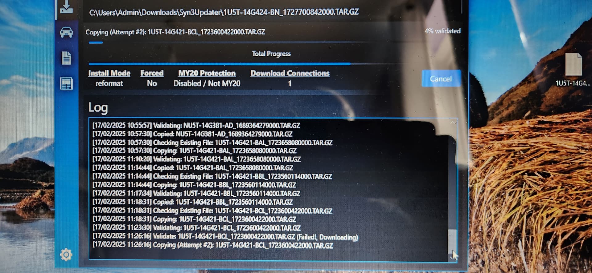

I did what you said and everything ran much quicker but still failed to download when it got to that exact same file and aborted again. Iāve unchecked that file before pressing start this time to see if it makes any difference, think Itāll be a case of just giving up if doesnt work this time, i think this will be approx the 20th attempt, Iāll be gutted but if its not meant to be then so be it hahaha
Iāve even tried the manual way twice without success

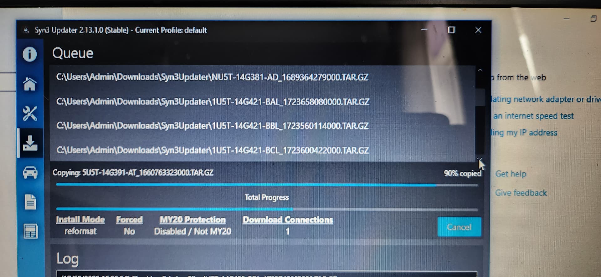

Click Restore Defaults within the formater and let windows handle the USB, within sync updater app settings configure number of connections to 1
Yep, it has connections set at 1 so i just leave it as is
Iām downloading the files to a folder on my desktop instead of the usb⦠do i extract them onto the usb once theyāre all downloaded?
Let synupdater copy them to the USB and save time
