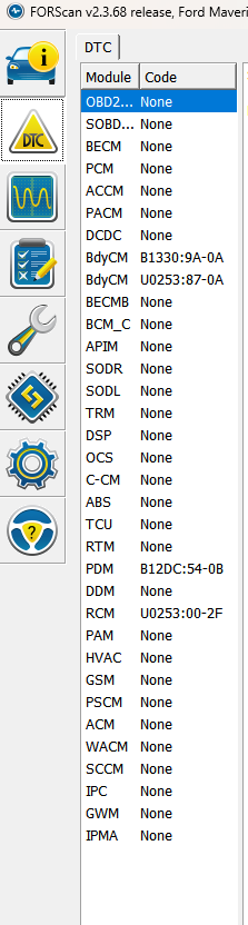

I’ve read quite a bit of the existing threads about some of the sync 4 retrofits and haven’t found a solution to my issues yet. I have a few DTC’s still after reconfiguring my APIM as built with the new sync 4 apim out of a ford escape. The only issues I notice are that when exiting the vehicle with it turned off the screen and audio take a bit to cut off and the zoom feature on the backup camera only zooms in. However I have DTCs for u0253 on hvac, rcm and bcm modules. I have another for my bcm but thats a dead dc inverter. If someone has done something similar is it just a non issue and I should proceed or is there something amiss. The HVAC code is missing below it only shows up after the vehicle is running.

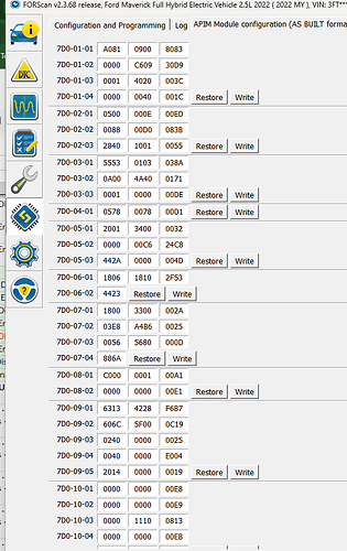

This is where I started with the as built from page 19 of that thread and then customized it from there. I’m going to reexamine his as built but I think all I did was mainly make changes related to my features. I used a lot of the as built sheets guys had out together from f150s to get it like mine.
Can you post that asbuilt? I assume that the one above is your modified asbuilt…or Escape?
The above is where I currently am. I just made some changes most don’t seem to make a difference.
This is the one from the thread you referenced:
