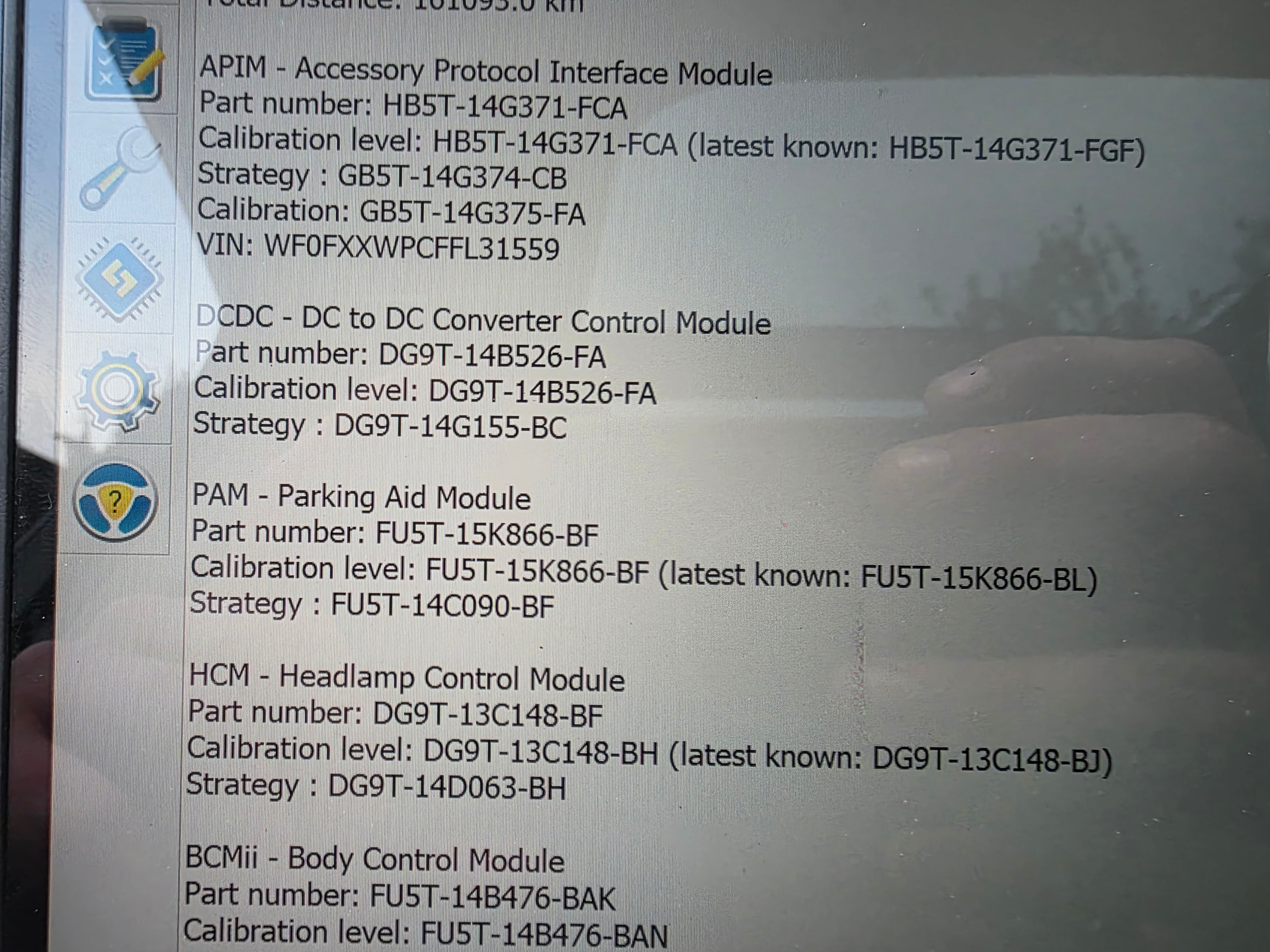

Look at the modules tab and see what the latest firmware is loaded on the PAM.
Yeah, I created a new profile after upgrading to SYNC 3. I followed the steps mentioned above, but the issue is still the same.
Here’s a photo of the PAM module
You need to upgrade to -BL. You can use FORScan to do this, version 2.4.69.
Forscan 2.3.69 doesn’t support firmware updates. I installed the 2.4.22 beta, but the newest calibration files available there are still only BK
See your PM…

Everything else looks to be set correctly compared to other vehicles with 12 sensors that I know do work. These vehicles however, do have the -BL version of the PAM, not -BF. I am not sure if this is a factor. They all have the -BL firmware.
