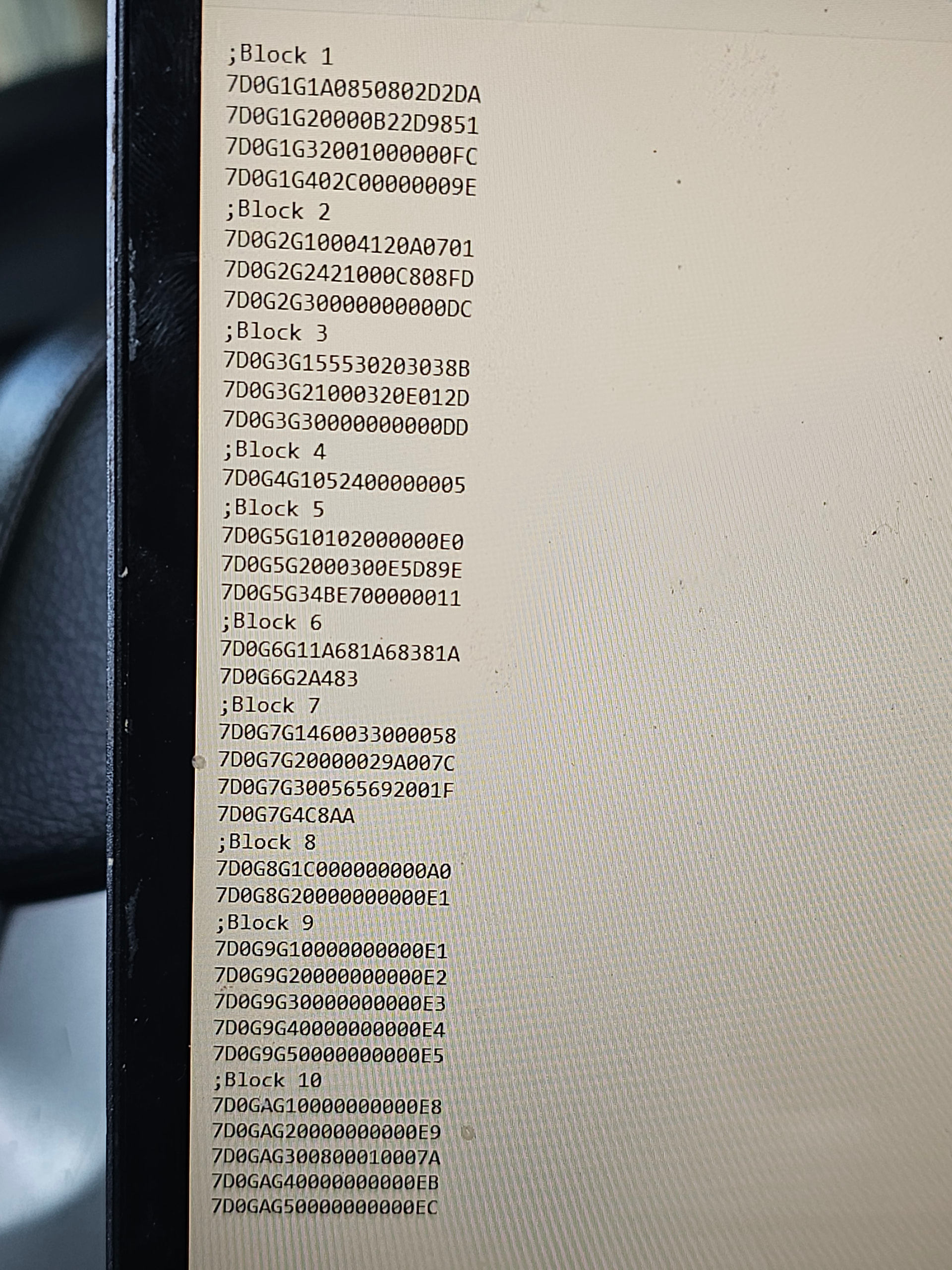

First photo is the current asbuilt from the sync 4.

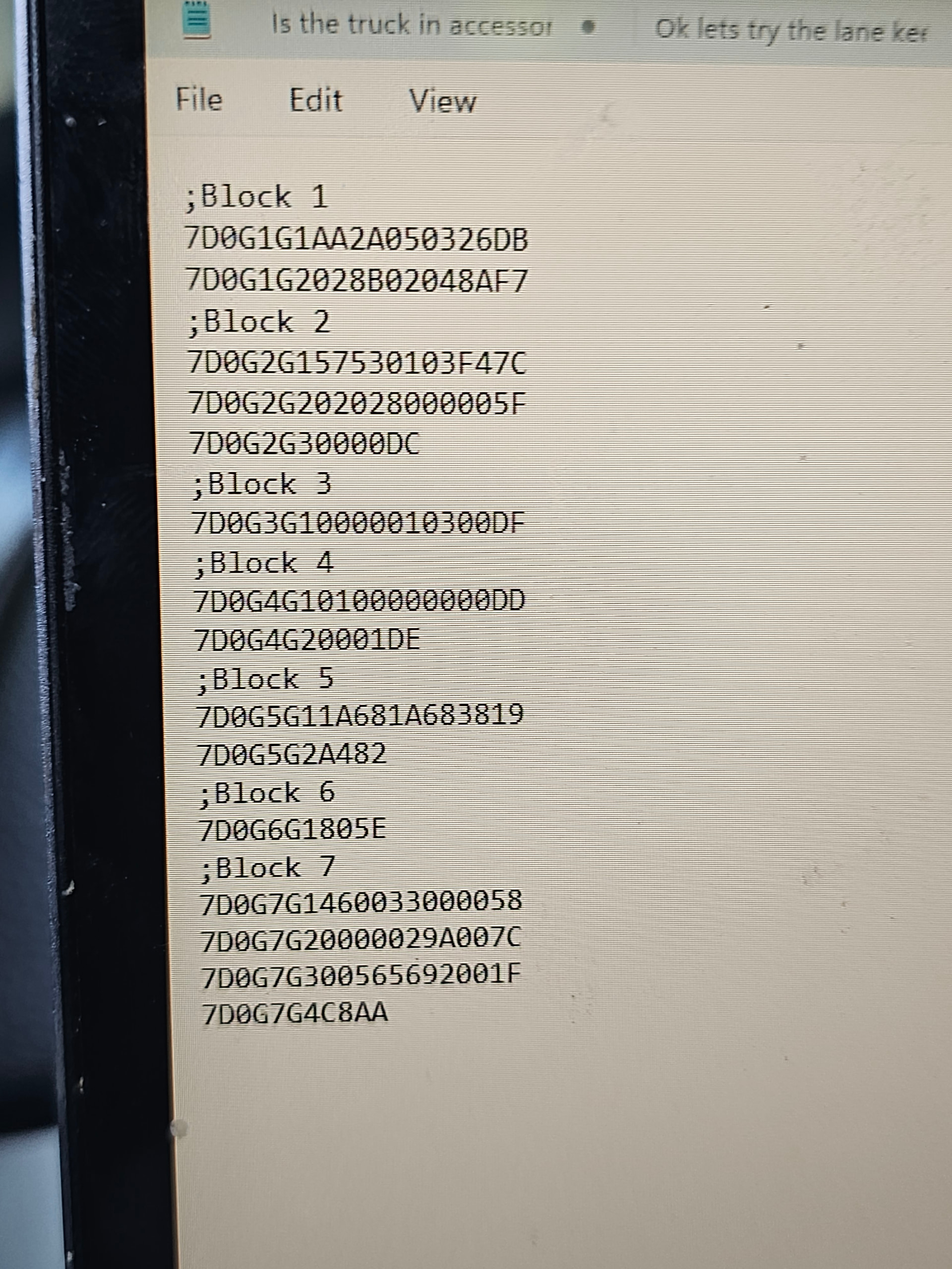

Second photo is from my sync3 before I pulled it out

I saved both of the sync3 acm and apim asbuilt but I cant forscan wont let me display them. I can only bring them up in a text editor.
As far as the sync4 I have now installed in the 2016 I can see the forscan format. I dont understand the format that the text editor showes.

What i need help with is the forscan edits for the apim.

What would be helpful right now is knowing the blocks that need edits.
I also have backups up of both the 2016 and 2018 apim in forscan.
I know the settings from the sync3 Asbuilt but they dont just transfer over to the sync 4
I need help with 7d0 0101, 0102, 0201 0202 and any other block im missing.
