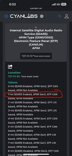

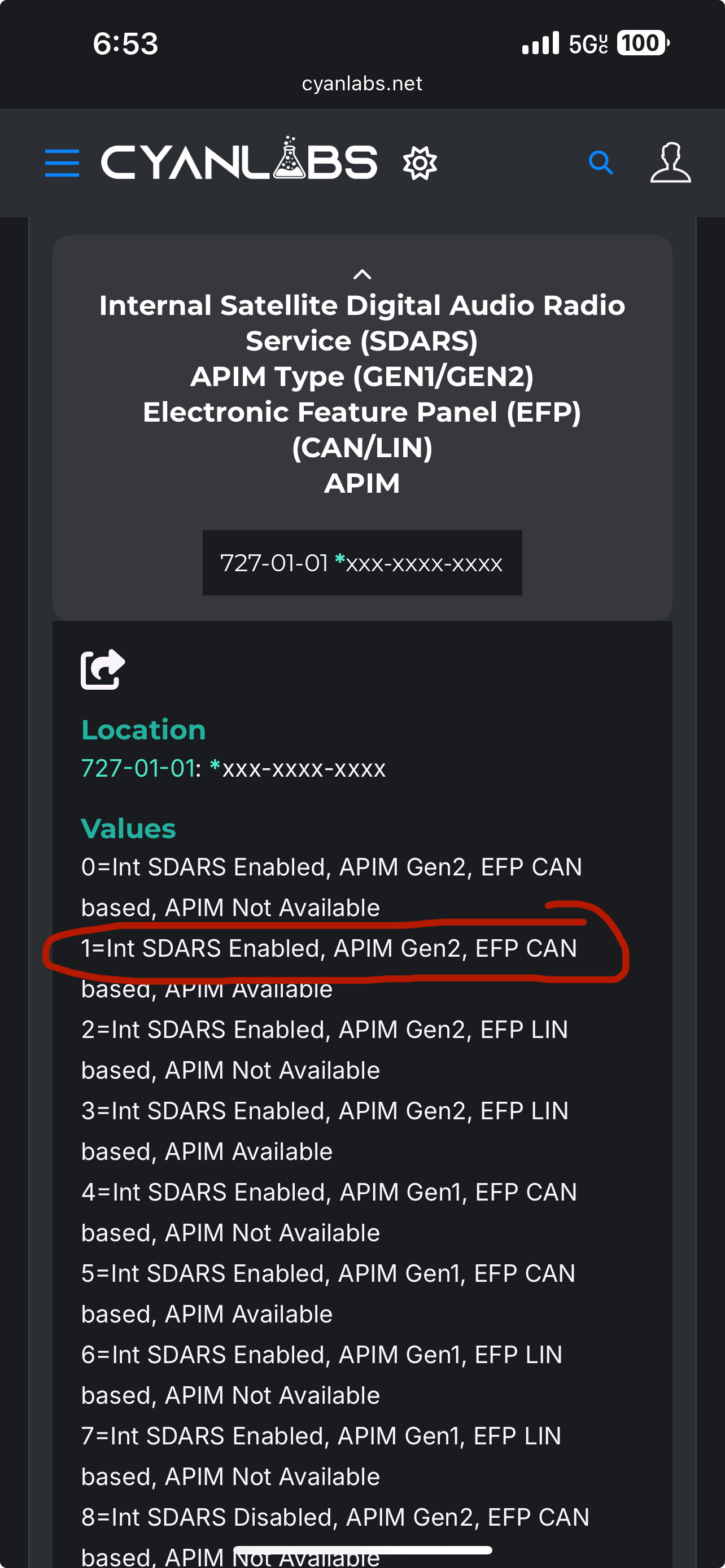

Post your ACM asbuilt. There is a setting for LIN or CAN based EFP, needs to be set to LIN probably.

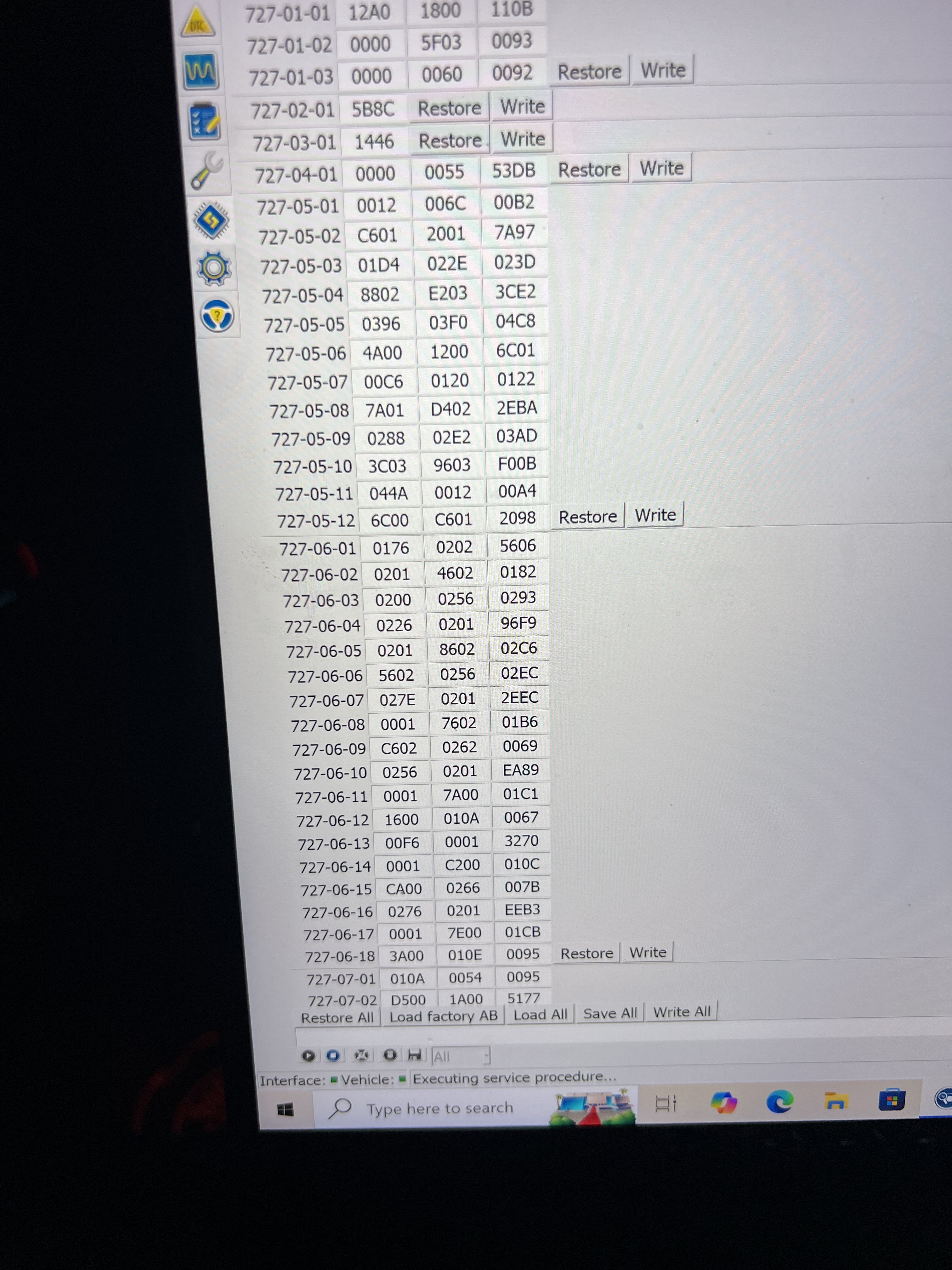

Try this asbuilt, it’s from a 2015 F-150 Platinum with a KL3T-18D832-CC ACM. Make sure to save your present asbuilt before you use this.
;Block 1
727G1G1 10A0 1002 8173
727G1G2 0000 FF03 0033
727G1G3 0000 0060 0092
;Block 2
727G2G1 5B8C
;Block 3
727G3G1 1446
;Block 4
727G4G1 0001 0155 53DD
The values past this are radio presets, they don’t matter as far as programming is concerned.
Thank you I will try but I have noticed in your list efp is set to can? Should this be lin
Try it both ways…I did mean to change that.

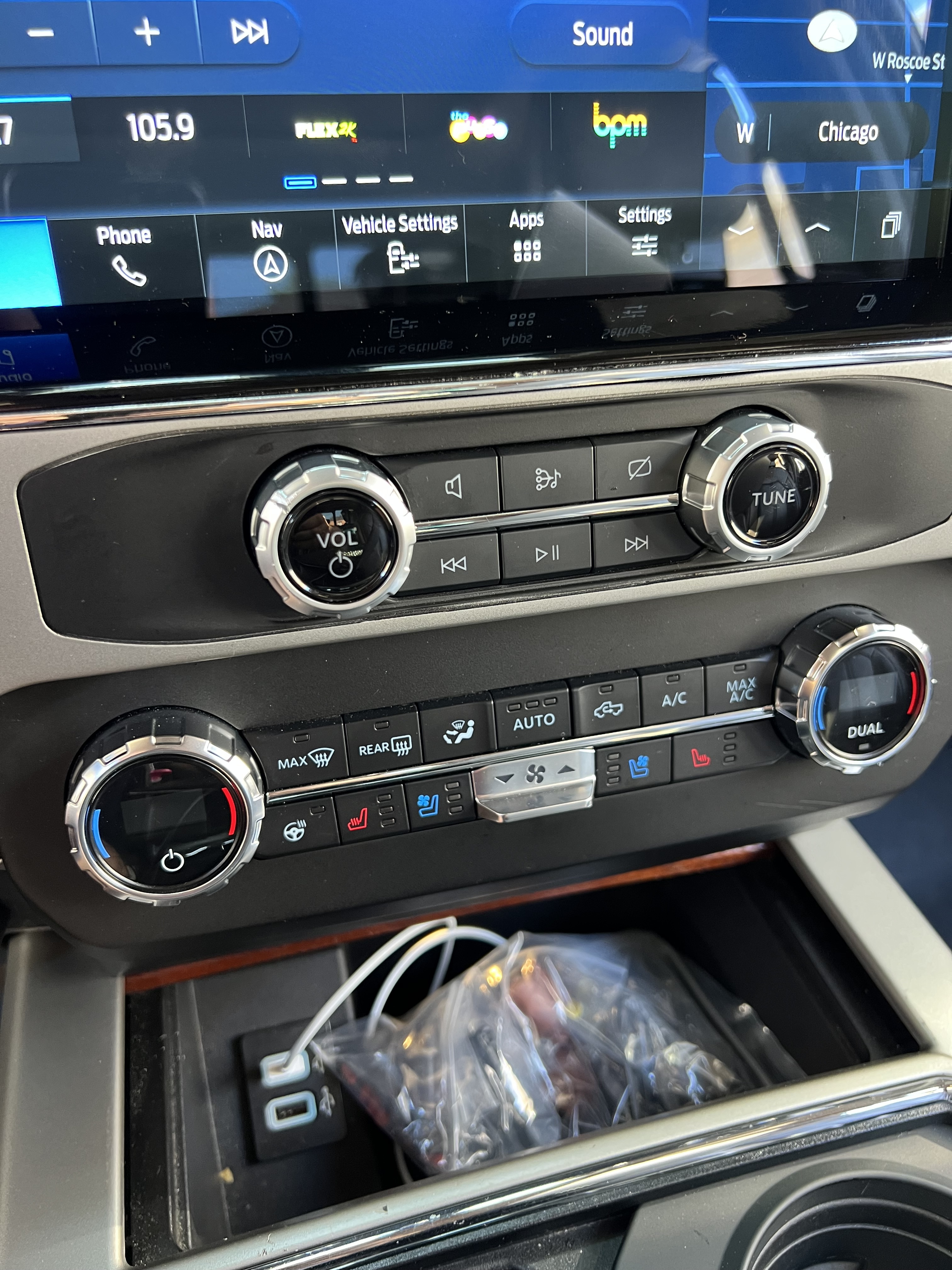

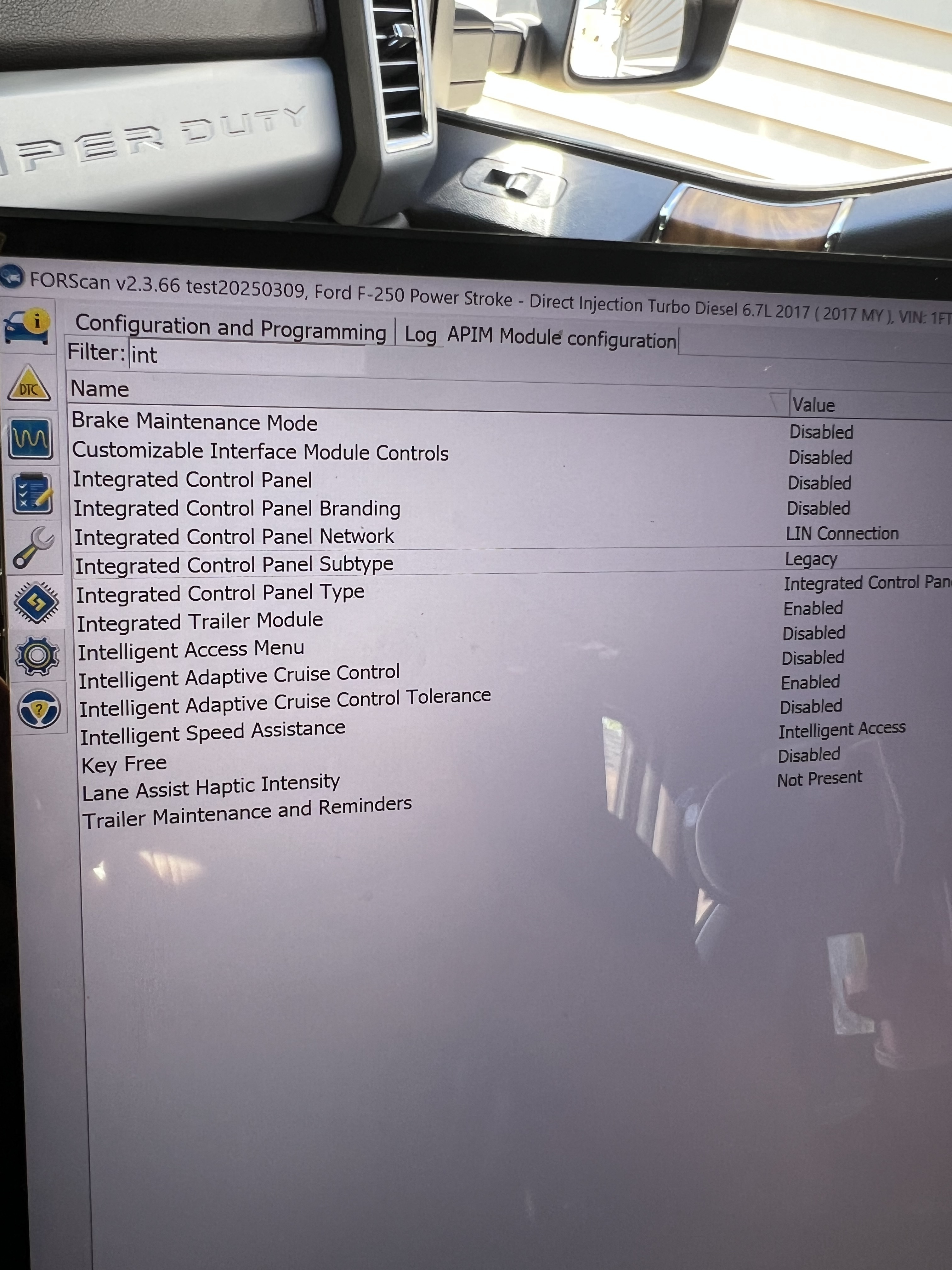

That didn’t work I did your settings also change to lin , but I have found many settings in apim perhaps there is something in there to make those code go away , this is a control panel I have and those are apim settings

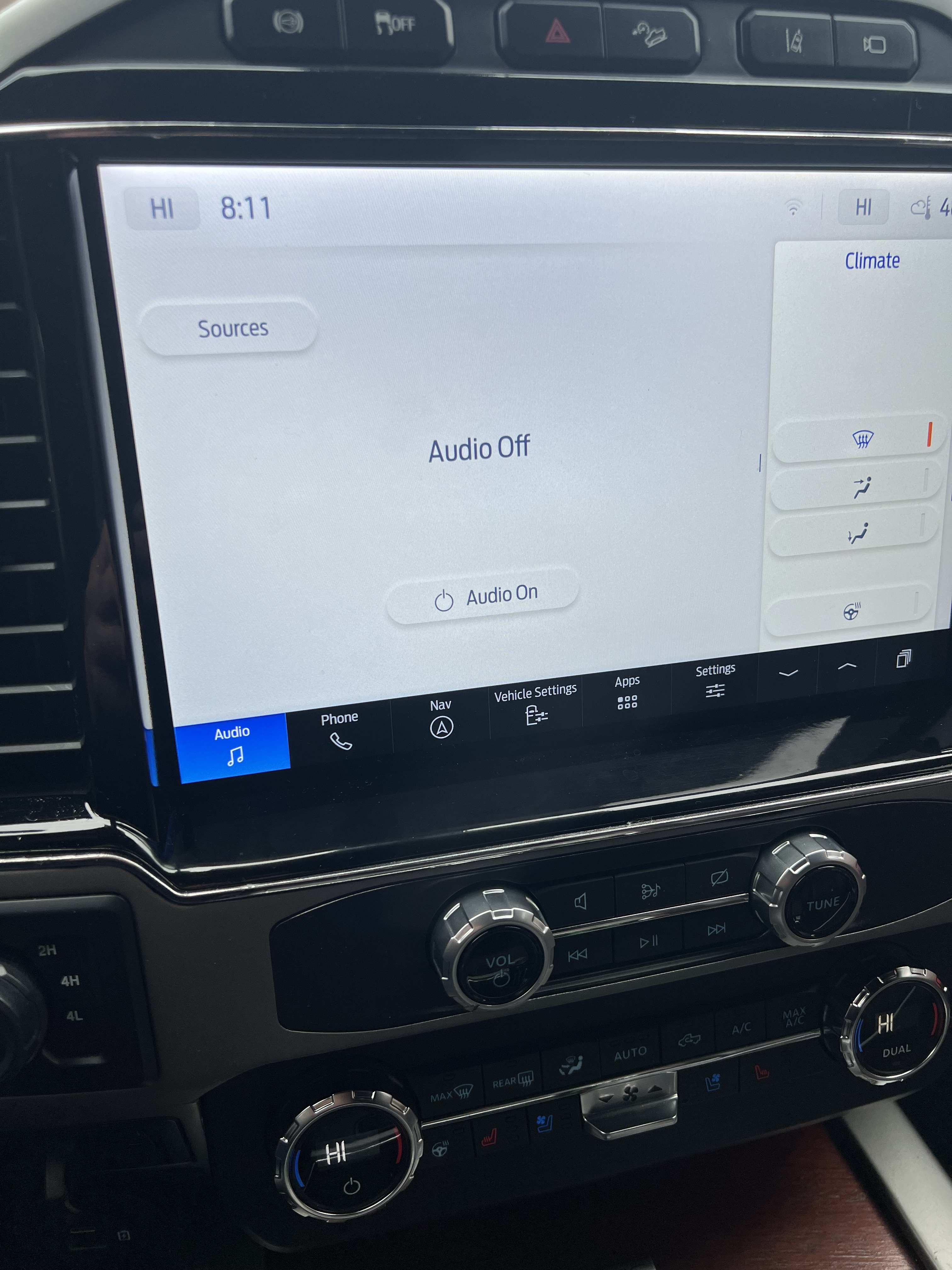

Yes sound works as should with one issue, when I leave the sound source in off position or in carplay mode the next time I start the truck all the chime are coming from cluster speaker but when leaving in fm am or xm mode it chime go thru speakers , so is there a setting than enable when audio is off to direct chime to speakers instead ipc?
That is normal. The chimes are a safety requirement so if the radio is off they need to be sounded somewhere.
