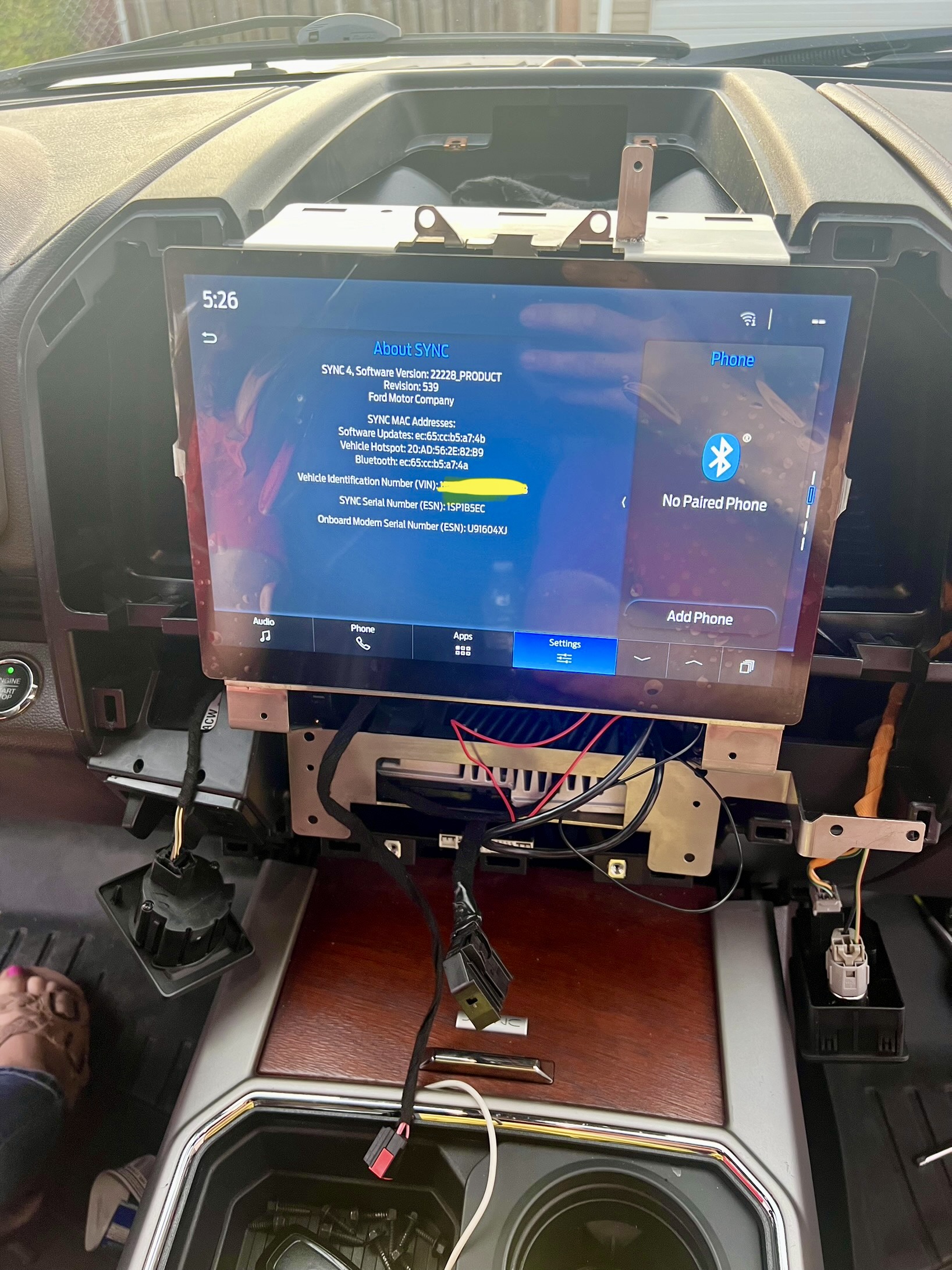

Hello I have installed sync4 apim in 2017 f250 for new programming I have used a similar data from newer truck, few options don’t work and I also have few dtcs in forscan, can anyone help me create a new as build data for apim?
I can also point out you’re on a very old build of Sync 4 but forscan is alien

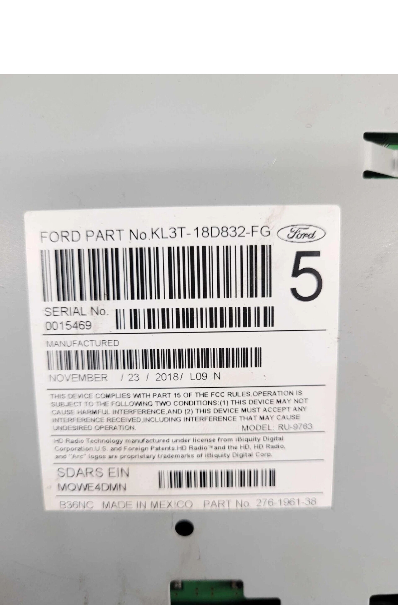

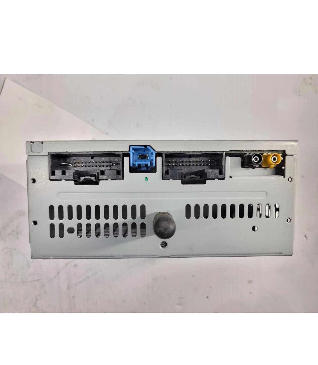

Good Evening, Im new here and need a little help. I upgraded to SYNC4 and a newer ACM KL318D832-FG. The fader and EQ is not working. How do I get the correct files?
2019 F250 B & O system.
ACM KL3T-8D832-FG.

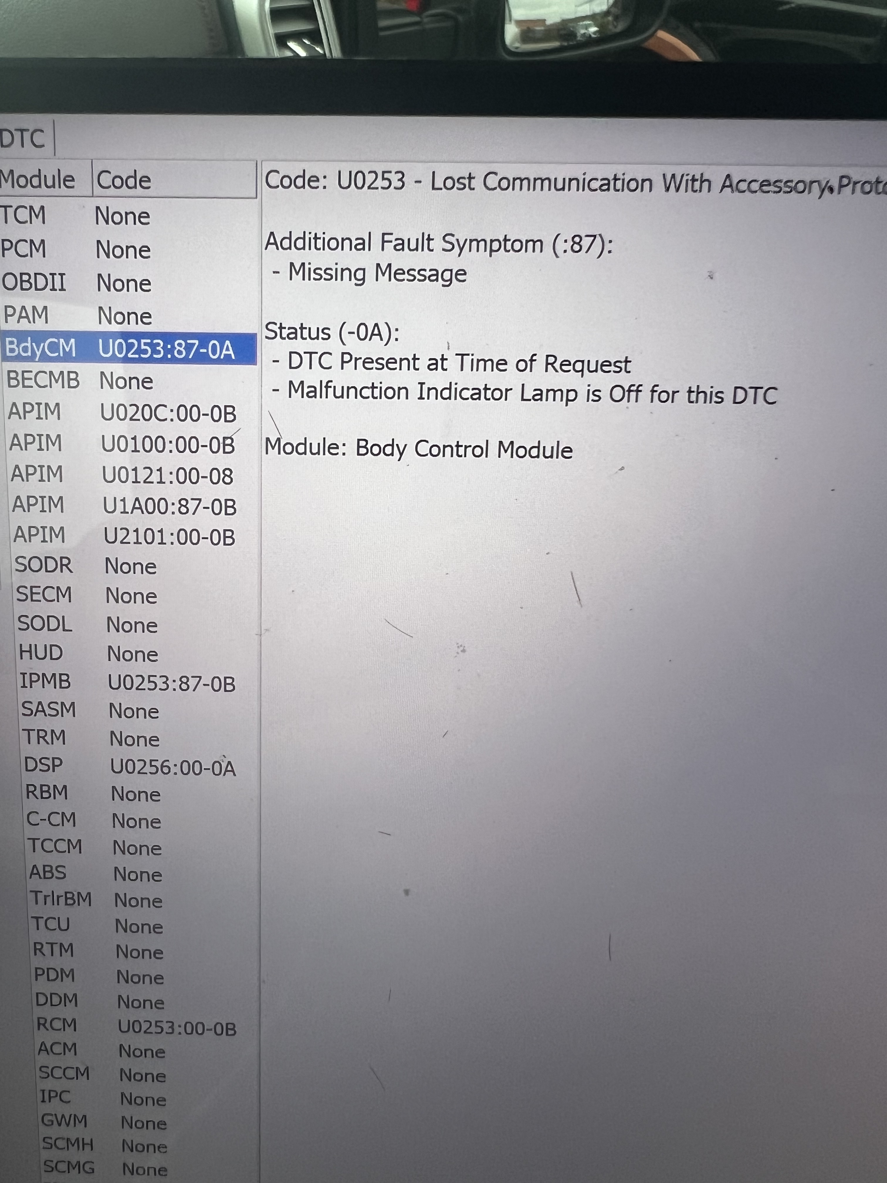

I have also updated acm everything works but there is a code for dsp u0256 , is there a way to do anything about this? My understanding is that front control panel is misssing but Im using different control panel from newer model are there any settings to select different control panel?
DTC U0256:00-0A in a Ford vehicle indicates a communication issue, specifically a lost communication with the Front Controls Interface Module (FCIM). This could be the DSP is having issues on the CAN network due to the Sync 4 addition, or simply just a wiring issue. Along with all the other communication issues with the Sync 4 addition, not surprising.
What FCIM did you install? Part numbers? Asbuilt?
Audio module ML3Z-18C858-AB
Climate control buttons -ML3T-18C612-de
If the ML3Z-18C858-A is a LIN based EFP it will not talk to your DSP.
Did you also replace the ACM?
Yes I have put newer acm KL3T18D832FG

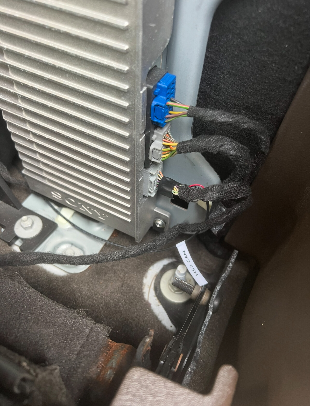

Is the DSP a Sony or B&O?
That is the ACM. The DSP will be on the back wall of the cab. Driver’s side.
