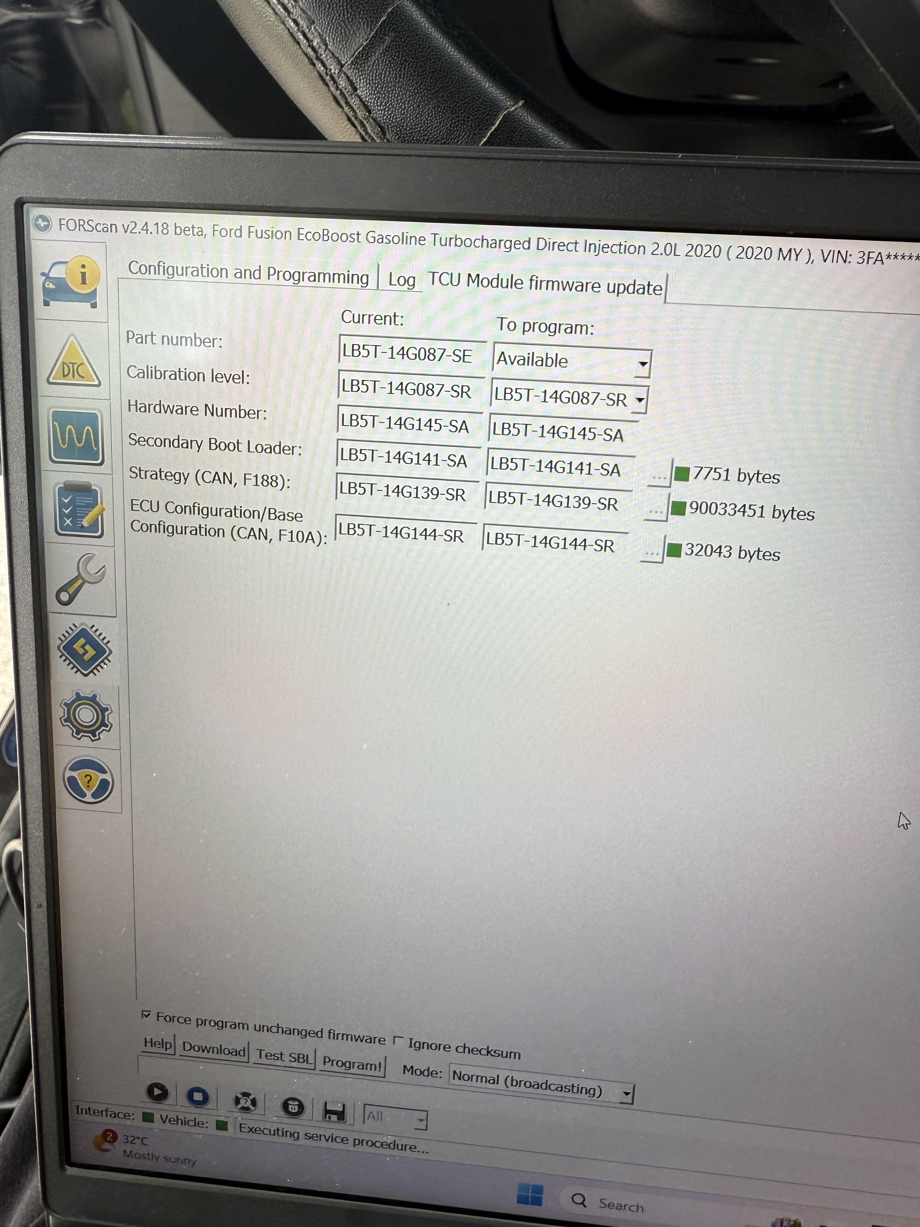

Is it safe to update my new modem???
It needs around 1 hour and half or 3 hours and half
This looks like the calibration it already has. I don’t see a need to update anything.
You are on the latest firmware for that unit. Should work fine.
Update i ended up updating it, it took like 2 hours, its now faster and the connection is good. Thankyou so much
