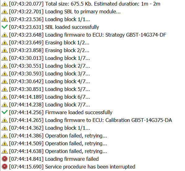

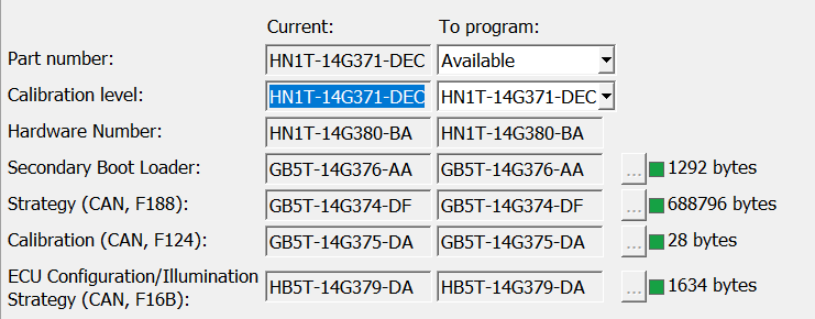

The code in this unit is HN1T-14G371-DEA, i plugged it into my car and nothing happened, forscan detected it as HN1T-14G371-DEC, i tried updating the firmware with the “Available” files and it doesnt work.

The brick level was DEA so try using that first.
The issue you have now is whether on not the unit was even at HN1T-1371-DEA to begin with.

If it was at dea, what should my next step be? When i click on the drop down menu for the calibration level, it shows only the DEC option
Also, with this apim connect to my car, there’s no asbuilt option for the apim, in the dtcs section it says the apim is not compatible with dtcs and when i try to access the apim configurations, it says it’s a sync 1 apim lol
Try GB5T-14G374-DG. Program this with the other files instead of -DF.
See your PM…
No luck unfortunately :frowning:
See your PM…
Replied
