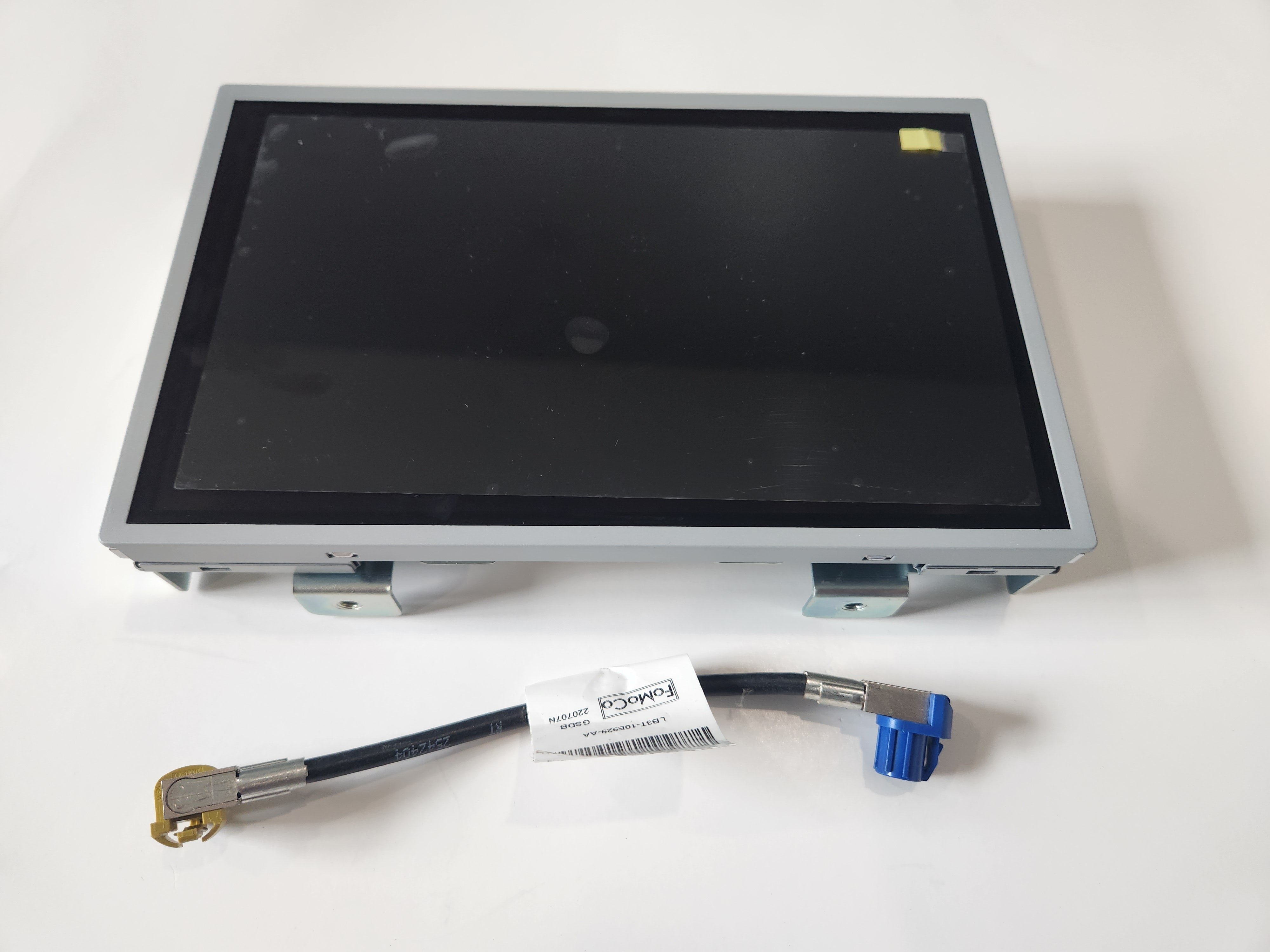

I think he’s referring to the Sync 4 8.46" screens that some sites are selling like this one.
Specialized conversion. First, I’ve seen of these screens…so looks like a bare Sync 4 screen, likely a service replacement item, with a bracket. I could see if you were to replace a screen in say a 2020 or earlier F-150/Explorer/Expedition and their Lincoln brethren you will gain nothing unless you were to modify the FCIM bezel. Other vehicles likely the same. For vehicles with the stand-alone screens on the dash this looks feasible. Probably really aimed at that market…?
