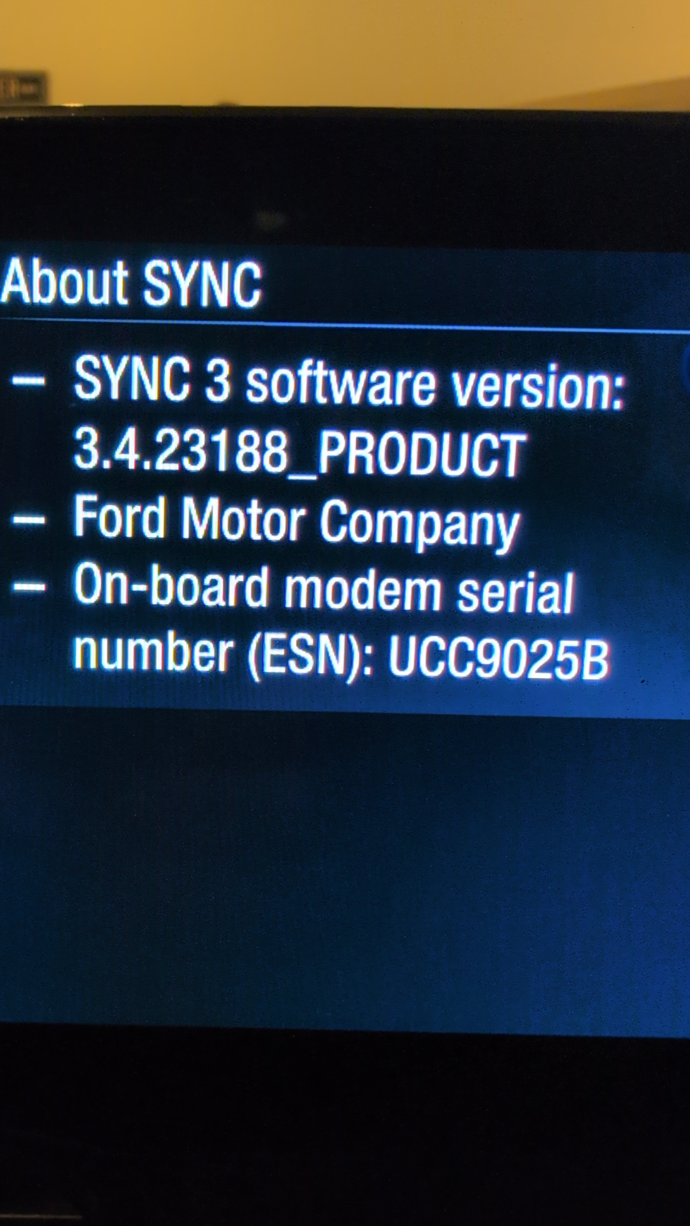

That’s fine, I do not need any part number, just the Sync3 version. You can look for it in the About Sync3 screen, if you can’t access that you will need to create and run the interrogator log against the unit. But, step by step…
You may be new to this, but you can’t expect others to assume you do not know anything about your infotainment system (not even the Sync3 version) if you just performed a major upgrade to it :wink:
Anyways, get the current version the unit is running and we will take it from there.
Ok, it’s on 3.4.
You only need to install NU5T-14G381-AD, which is 3.4.23188 for 8 inches screens.
