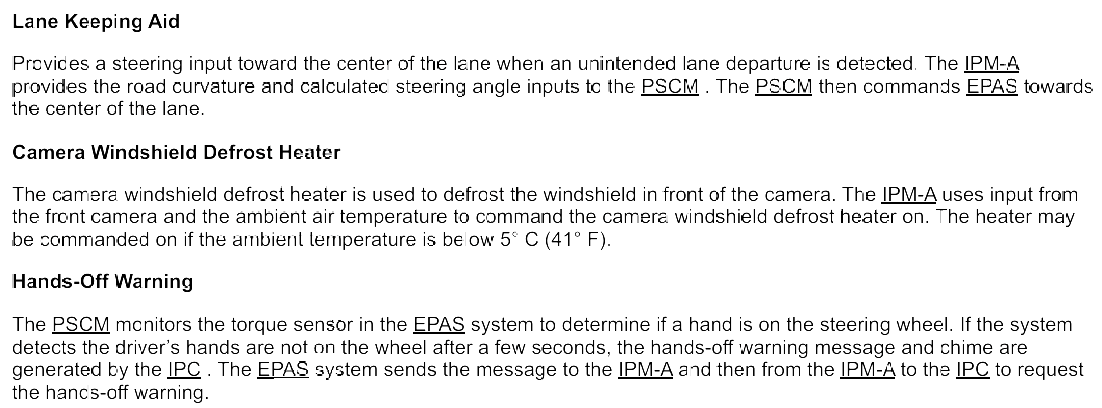

First off, Do not put [URGENT] in your title like were all here to serve you.
If your adding an IPMA to get LKA than you need an EPAS steering assy. If you dont have that than there is no reason to add LKA as it is not going to work and you will get DTC’s like you have becuse you can’t calibrate something you dont have.
Won’t work.
