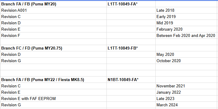

Can I fit a counter like this from a Puma(virtual cluster) into a Fiesta with a 1.1 85HP petrol engine? If so, what marking does it need to have?
You dont need to order a spicific type of the cluster because everything can be configured later like kph/mph etc. The only thing that you need to watch out is that the cluster you get has less kilometers/ miles than yours because when you try to code the correct milage on the new cluster the milage can only go up not down. The other thing you need to watch out for it what version you get because earlier versions tend to lag a bit. When i got mine retrofitted i got the N1BT which is good.
