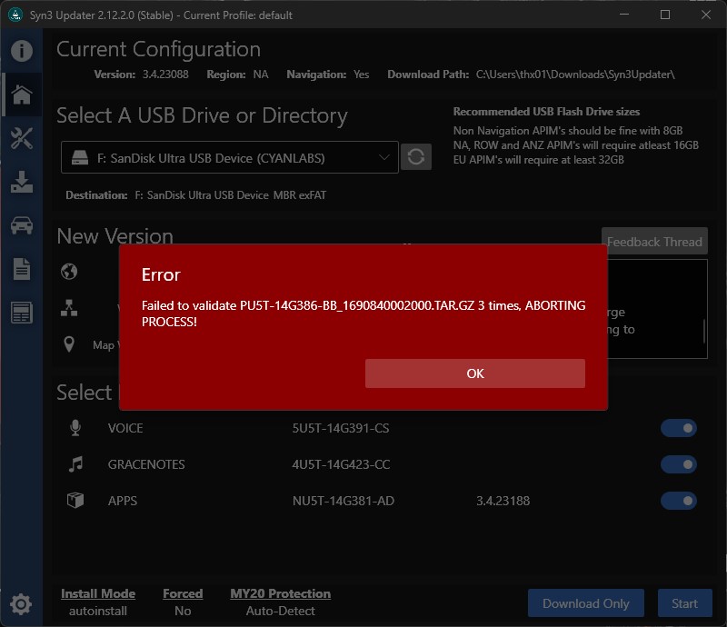

Using SyncUpdater 2.12.2.0 and trying to create install files on a usb for 3.4.23188. have done this in the past at least twice to get me from 3.0 to 3.4.23088 with no issues.
now when i try to create the drive i get an error:
i have used the same usb as before and have reformatted it several times. Tried it with maps and “keeping same maps” i am current with maps but tried anyway.
any help would be appreciated
never mind
i think i figured it out. i purged all my old cynlab files on my harddrive and it seems to be working now
Check your hard drive for errors, the software would re-download any corrupt files, you may have something else going on.
