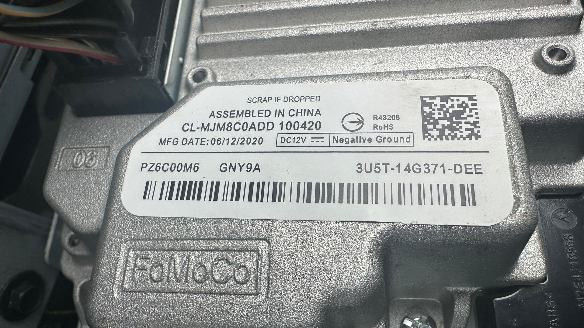

Do you have a pic of the unit showing the part number?
I didn’t take a picture before installing, but I’ll grab one at some point. I believe after one of the “Master Resets”, I did see that red circle for a minute or two, but haven’t seen it since. I can’t remember if that was when I had the GPS unit behind the radio under the dash. Since then, I’ve routed it to the entertainment box on top of the dash.
Had a chance to snap a picture today. Seems like I’ll get one of three situations

This is a Chinese clone APIM. It is probally going bad. I could go on and on about all the faults in what I see in this pic.
But I wont becuse I dont want to help these scammers get better at hiding them.
That is counterfeit.

They did not make an H series APIM in 2020. Those were 2016 & 2017 units. This right here tells you the sticker is false also.
That would have been a genuine number but it has been hacked.
Yeah, when I looked up that number, it seemed to belong to a variety of 2017-18 vehicles. But are you saying they just hack that number into the APIM and the whole thing is “fake”? It’s not a rebranded unit from 2017?
They are returned/faulty units that get thrown away. They do all kinds of frankenstiening to get them to work so they can sell them.
