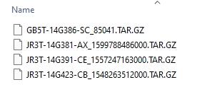

Do you have a list of the files included in the upgrade you downloaded? They should include these:
You can download these in the site IVSU Database.
This is the autoinstall file to use with these files:
autoinstall.lst (576 Bytes)
This installation will reboot and continue, so don’t remove the usb until the installation is completely thru both steps. You will get a message.
