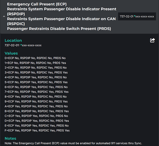

This should help you get the ECP fixed in the RCM. Find the right setting use Forscan to change it.

I have the as built description pulled up off of the vin number and do see 737-02-01 c76a cf33 1084 Am i correct that I need to change the “c” to one of the values showing in the screen shot you sent?
Which value to i use? Did you say I can find thins in the RCM module?
Can I make the change while the car is running so the radio doesnt try and shut down?

I video recorded the changes OEM upgrades tech do….He changed c76a to 476a.
Do I want ECP, RSPDIP, RSPDIC, PRDS to all on which means I change the “4” to “F” ?
I made the changes to 737-02-01
I changed the 4 back to a C but Im still getting the same alert. Any ideas?

You need to adjust settings in the APIM and RCM to remedy the issues, but we need to see the asbuilts for those modules to help.

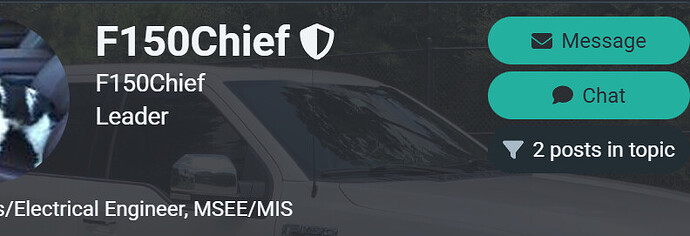

Im looking but dont see anyway to PM you
Click on his screen name and that hit message in the box that comes up.
This is all that I see
Try it now.
It works…………thank you….I feel like Im so close to solving this darn issue
