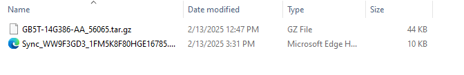

Root directory on the USB

Here us the USB Root Directory:

Here are the contents of the autoinstall.lst file (the only lst file in the root):
; CyanLabs Syn3Updater 2.13.1.0 Stable - Autoinstall Mode - Interrogator Log Utility NA
Item1 = TOOL - GB5T-14G386-AA_56065.tar.gz
Open1 = SyncMyRide\GB5T-14G386-AA_56065.tar.gz
I hope that helps…
