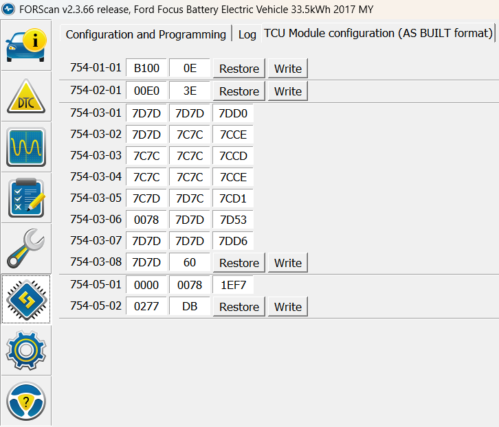

I’ve installed the new TCU and antenna, but can’t seem to get it working.
I’ve attached some screenshots.
The TCU shows a current level of HJ5T-14G087-UM which is the same level as shown in the FORD bulletin for the upgrade. Shouldn’t that be sufficient to get it up and running?

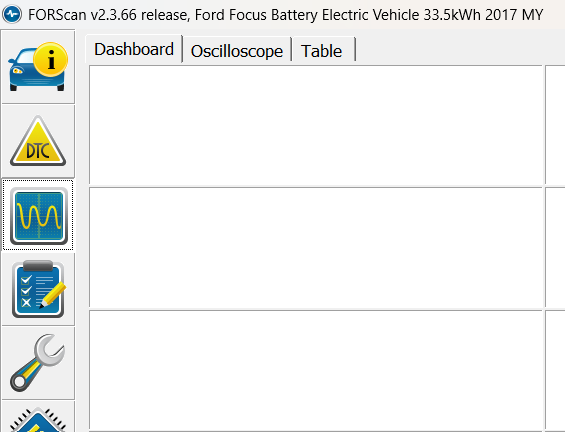

My screen is different as it doesn’t show the module with the upgrade options like the Chad Mees video, but is that just a ForScan difference? I have an extended trial license.
Forscan is not reading any PID data, which I guess means it’s not seeing any TCU activity?
Any suggestions appreciated!
Change B100 to B732.
Wow, thanks fr the quick response. Have made the change and written it, but also noticed this"Executing service procedure.." message in ForScan and I actually cannot chand the PID read to the TCU probably because this is happening.
4ScanExecSP
The procedure should only be momentary. The message you see is the PID scanning. Disconnect from the vehicle and restart FORScan.

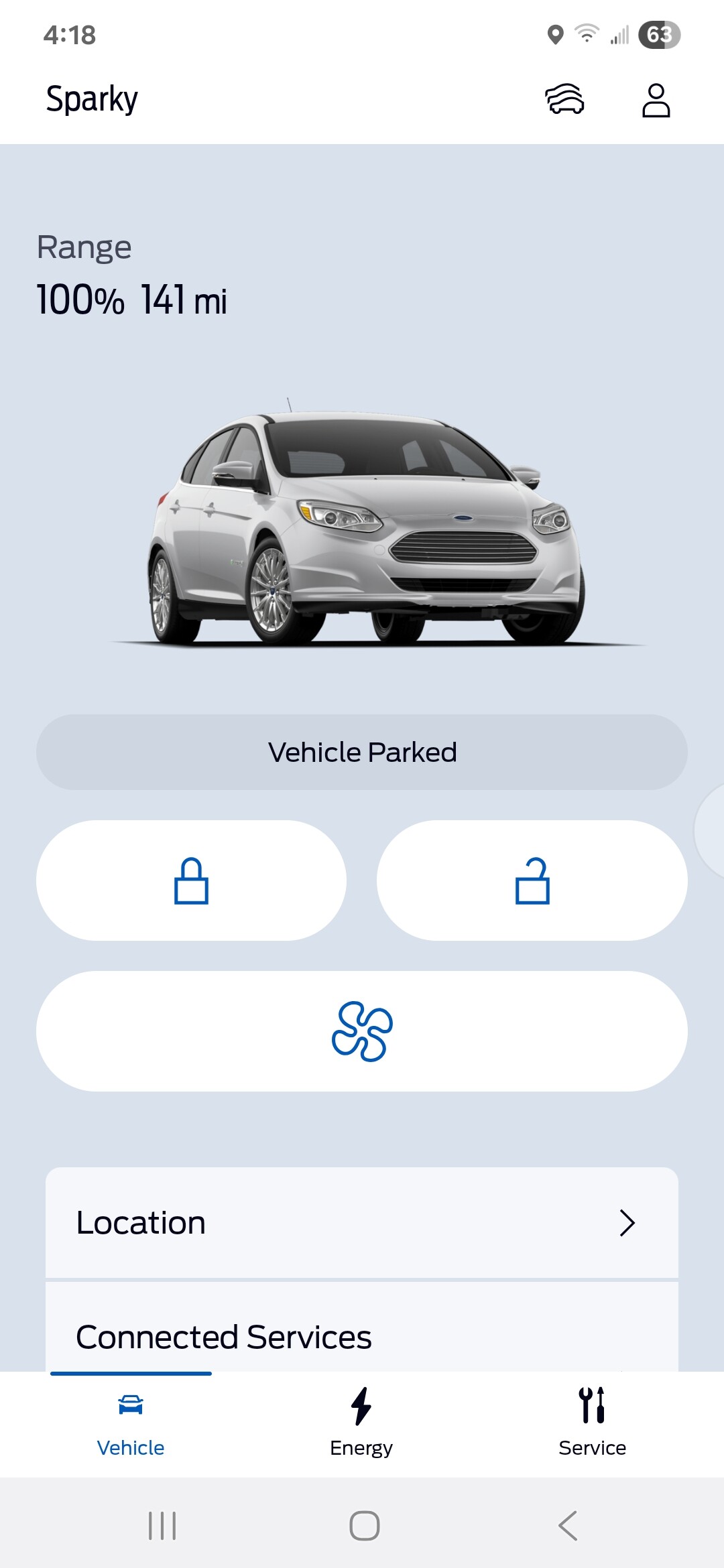

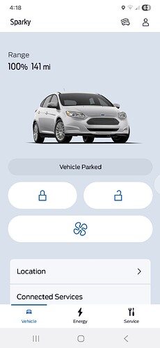

OK. Guess I celebrated too soon.
I can see location and battery stats (%charged and miles), but lock, unlock, and start climate all fail. All were functions that worked when 3G was operational.
Suggestions appreciated (again!).
Screenshot attached.
Probably my bad here…change B732 to B722. CGEA 1.2 platform.
Do you have your asbuilt from the 3G modem?
ok. I’ll try that.
Unfortunately I don’t have the 3G asbuilt.
PM me your VIN…
Well, I should pay attention better, and only work on 1 thread at a time. A 2017 Focus is C1CMA, not CGEA. Set the value the B742.
Your original was:
754-01-01 B742 56
754-02-01 00A0 FE
So set those the same.

Got the asbuilt file.
Mahalo!
You are welcome…
Those changes seem to work, thanks!
