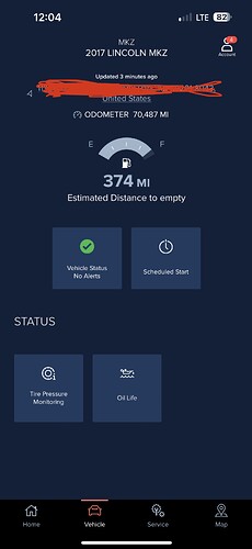

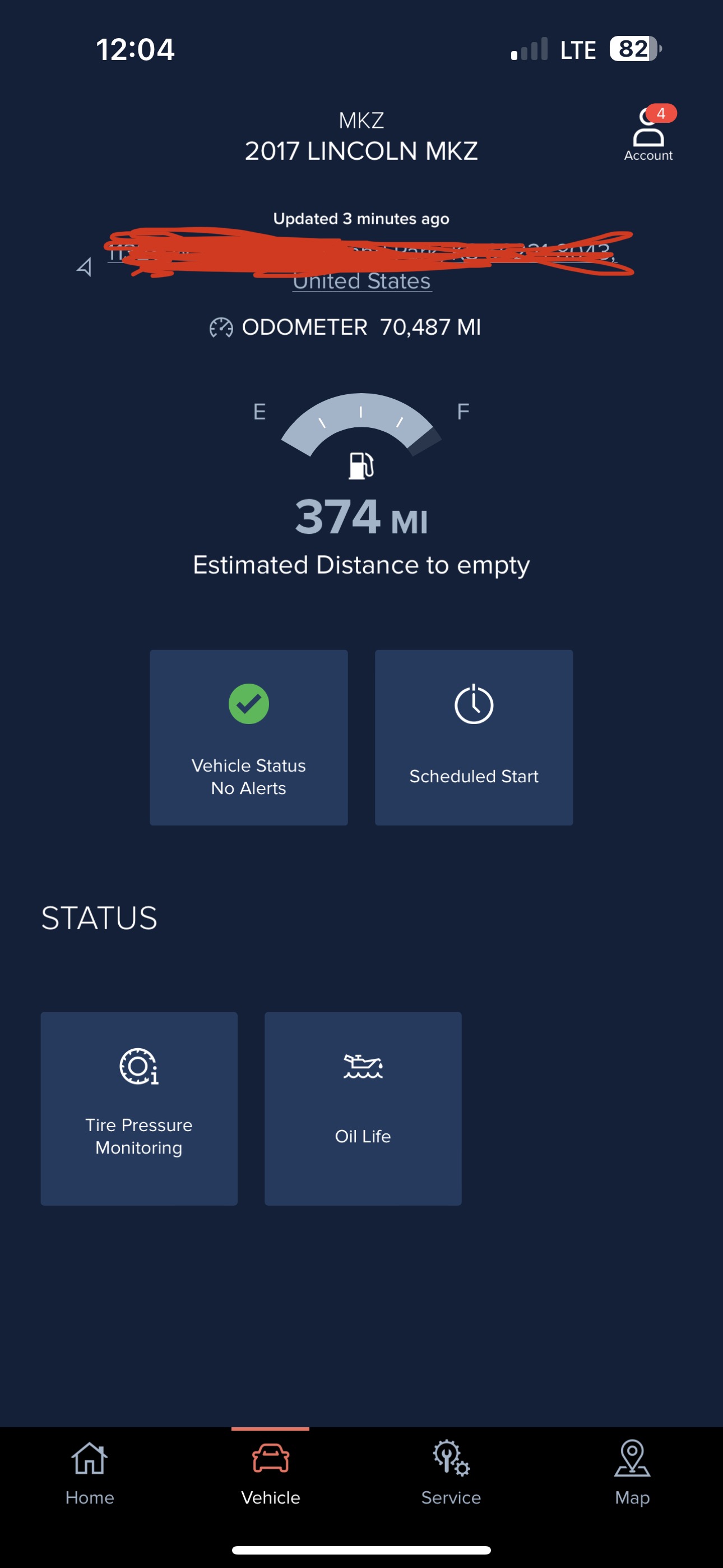

I did try changing from B142 to B162 based on the info in the database and the post above for the CGEA 1.3 vs 1.2 but I didn’t notice any difference. It is also odd to me that the Lincoln app shows the last update for the info on the odometer and fuel page as Dec 31st

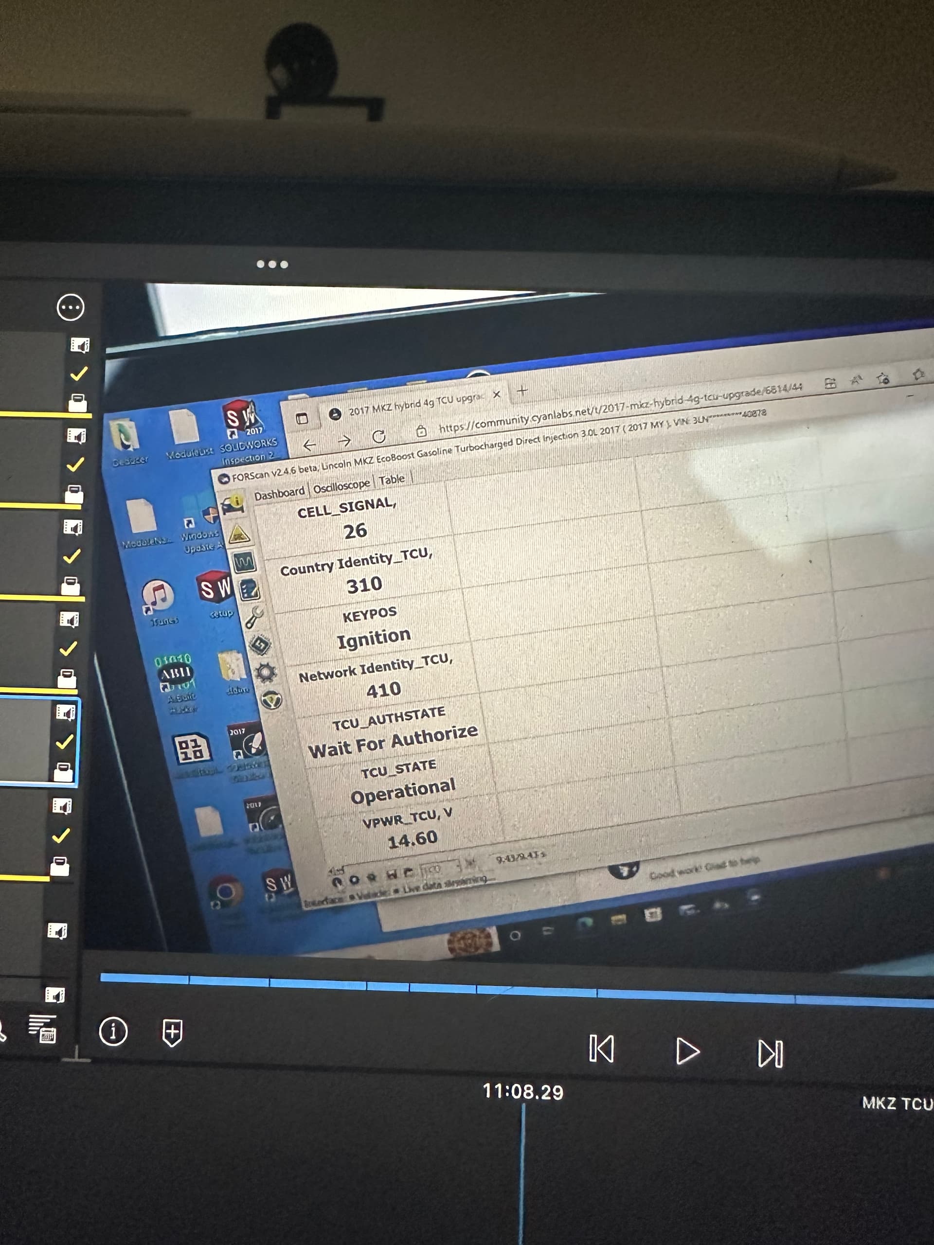

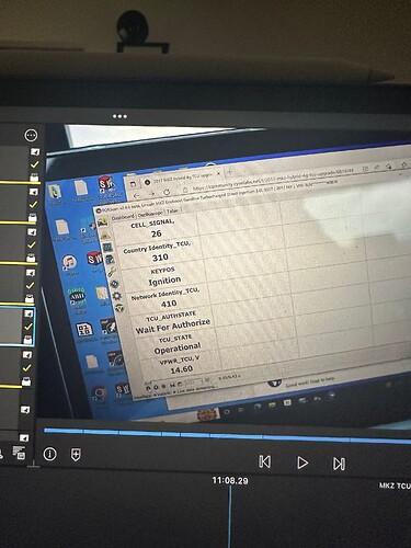

I got it on eBay. I did not set that line. I did the firmware update then checked the PIDs which looked like the following image.
I did not change the AB because it was already in the wait for authorize mode. I was then able to reset the apim and re-add my vin to initiate the activation which seemed to work right away without issue
I can try starting over by putting it into factory mode like you suggest if you think that may be the issue
