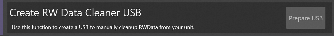

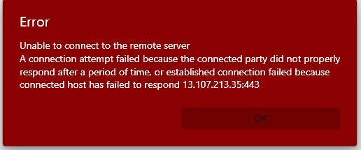

That’s what i am trying to do but i am having issues with creating the USB for the RW Data Cleaner USB.
It starts and then this error pops up
is there something i am doing wrong
It seems to be having issue accessing the http://ivsu.binaries.ford.com/ website to access the file which is why it seems to be having this issue. Can anyone else access this and its just me or what?

Ford’s servers are not accesible at the moment, not only for the tool but for any package, nothing we can do about that at the moment. Keep checking from time to time if Ford decides to solve their servers…
Yes, the “multiple consecutive SR and then MR attempt” was something people had some success with in the past… not guaranteed, but you can’t do anything else at the moment…
EDIT: Azure is having issues, once again… So that’s why Ford’s servers access is not possible at the moment… Again, nothing we can do at the moment…
Could be part of the worldwide Microsoft outage today. Nevermind I see Sandman already saw it.
