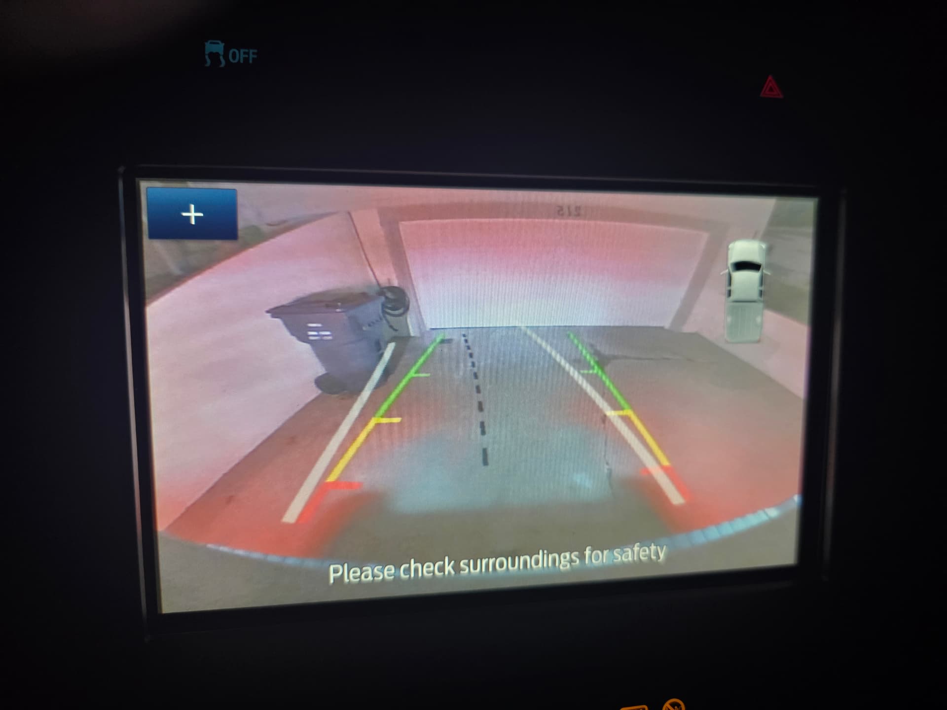

2019 F250 SYNC3 upgrade, no vehicle or reverse sensors showing while in reverse
A couple years ago I did a SYNC3 upgrade to the 8" screen and everything works perfectly except for when in reverse. The vehicle icon with the 4 reverse sensors zones does not show up.

I enabled Parking Assistance to “Rear Park Distance Control” (PDC), there was no change, the vehicle icon and sensor aid didn’t appear. I even did a APIM reboot afterwards.
APIM needed 7D0-01-01 changed to 0A2A 0402 0013, it was set ar 022A 0402 0013, it now works perfectly!
