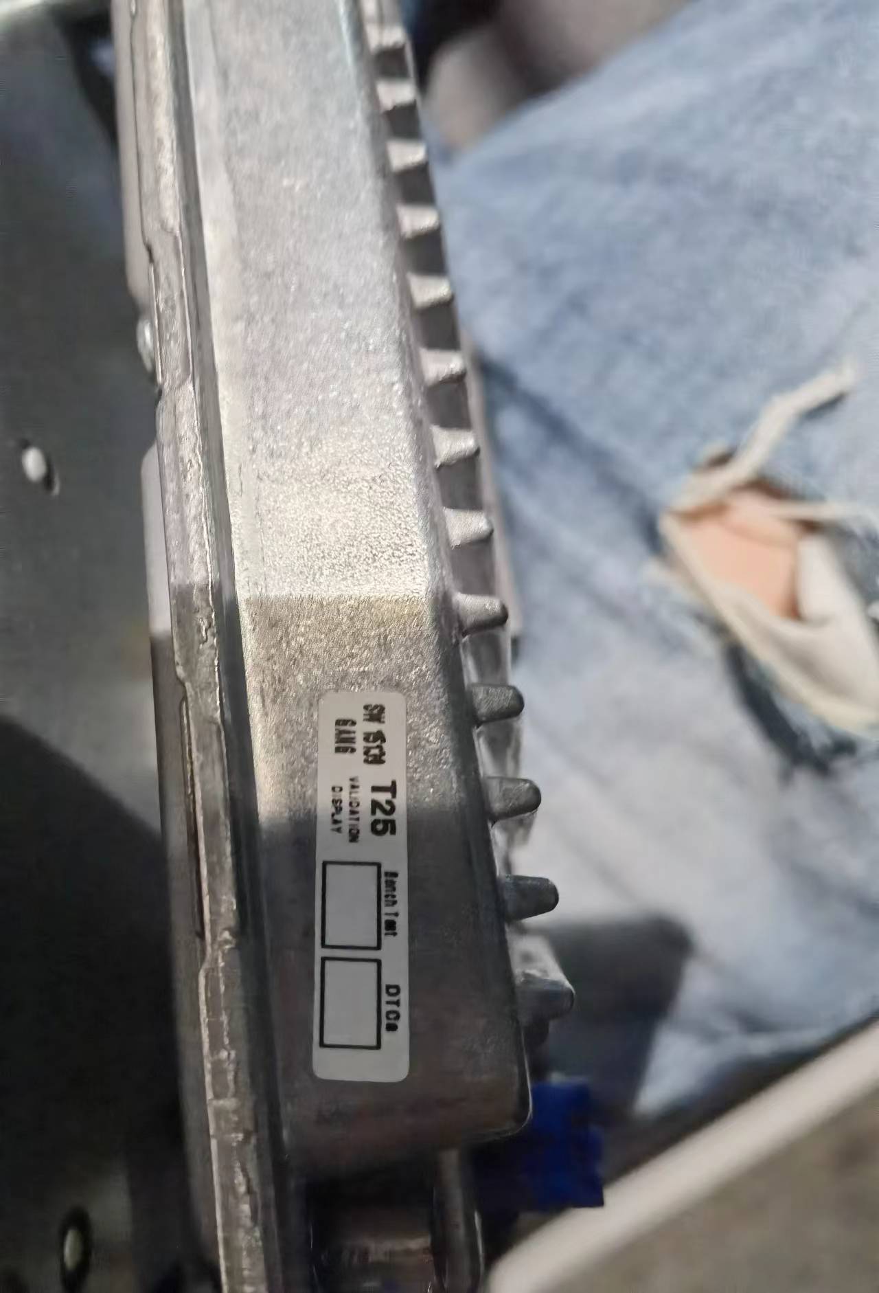

@dennisholland , do you have a picture of the APIM?
@peppinoesposito @shuai , same question for you guys. Do you have a picture of the APIM?, we are interested in the sticker that comes with it… specifically, the manufacture date…
Until now, all references for APIM JL7T-14G371-KGB are located here on this thread.

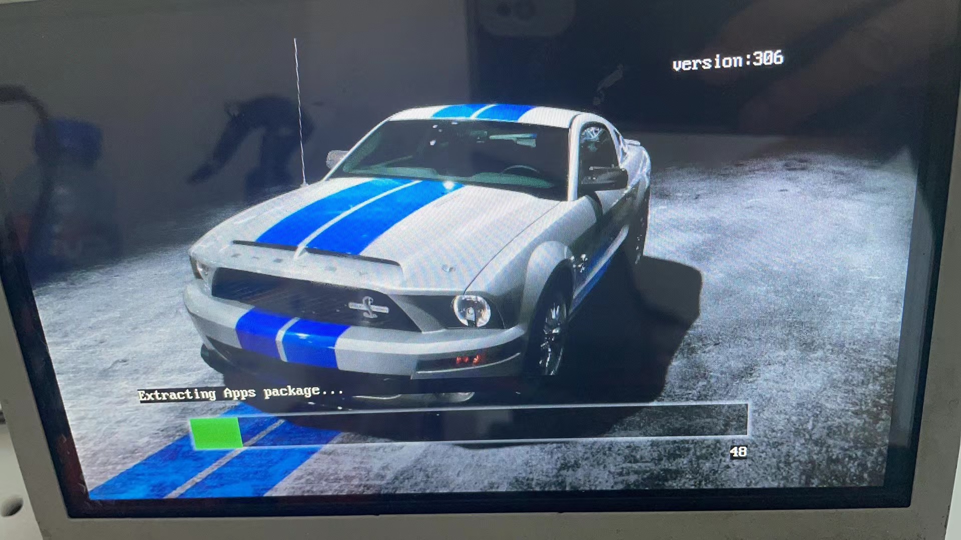

The seller tore off the sticker,But he fixed it.the APIM works again. He took down the original screen, connected another screen, and upgraded the APIM through the downgrade mode successfully.Then he connected the original screen back

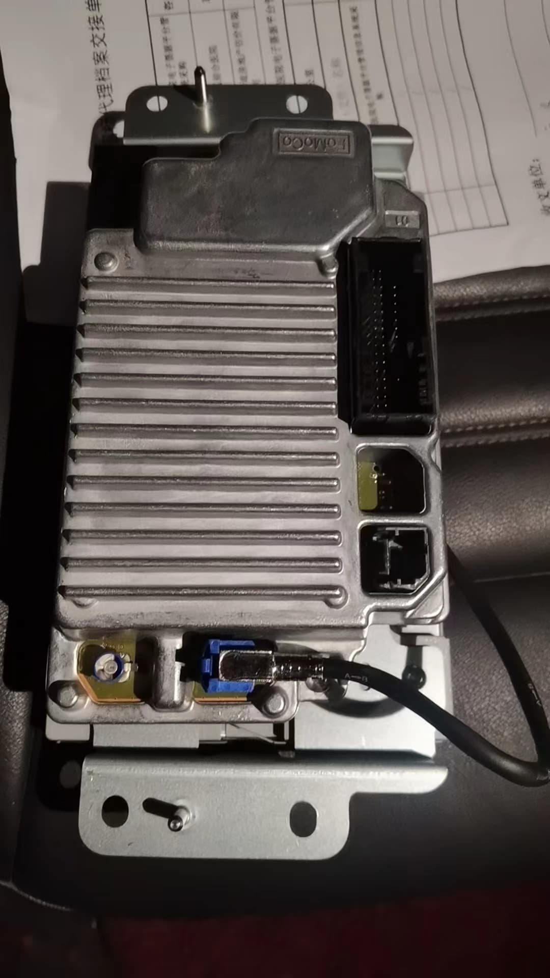

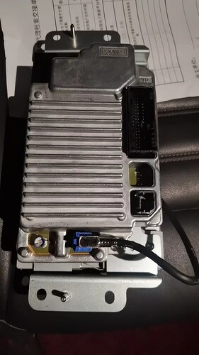

it’s the only picture I can provide. The back of APIM is bare.and now my build is 3.4.23188.
This is a picture sent to me by the seller during the repair process. Obviously, this is not my screen.
The second picture is the reformat tool, so in this case that APIM is not MY20 but the screen you used is.
Honestly i’m not even convinced this is a geniune FoMoCo item currently no one seems to be able to provide a picture of the official ford label.

I wonder why did he do that… The sticker on the APIM is not easy to remove, and it’s the single thing that can proof it’s authenticity… It’s odd, but I’m sure he had his reasons…
This is quite interesting… If that’s the case, that points to a MY20 screen, which is not supported by the reformat tool either…

These two photos were taken when I sent them to the seller.This is indeed true.The seller told me that the 4th generation high-definition screen does not support the reformat tool.
Why would they remove the label, dodgy as anything

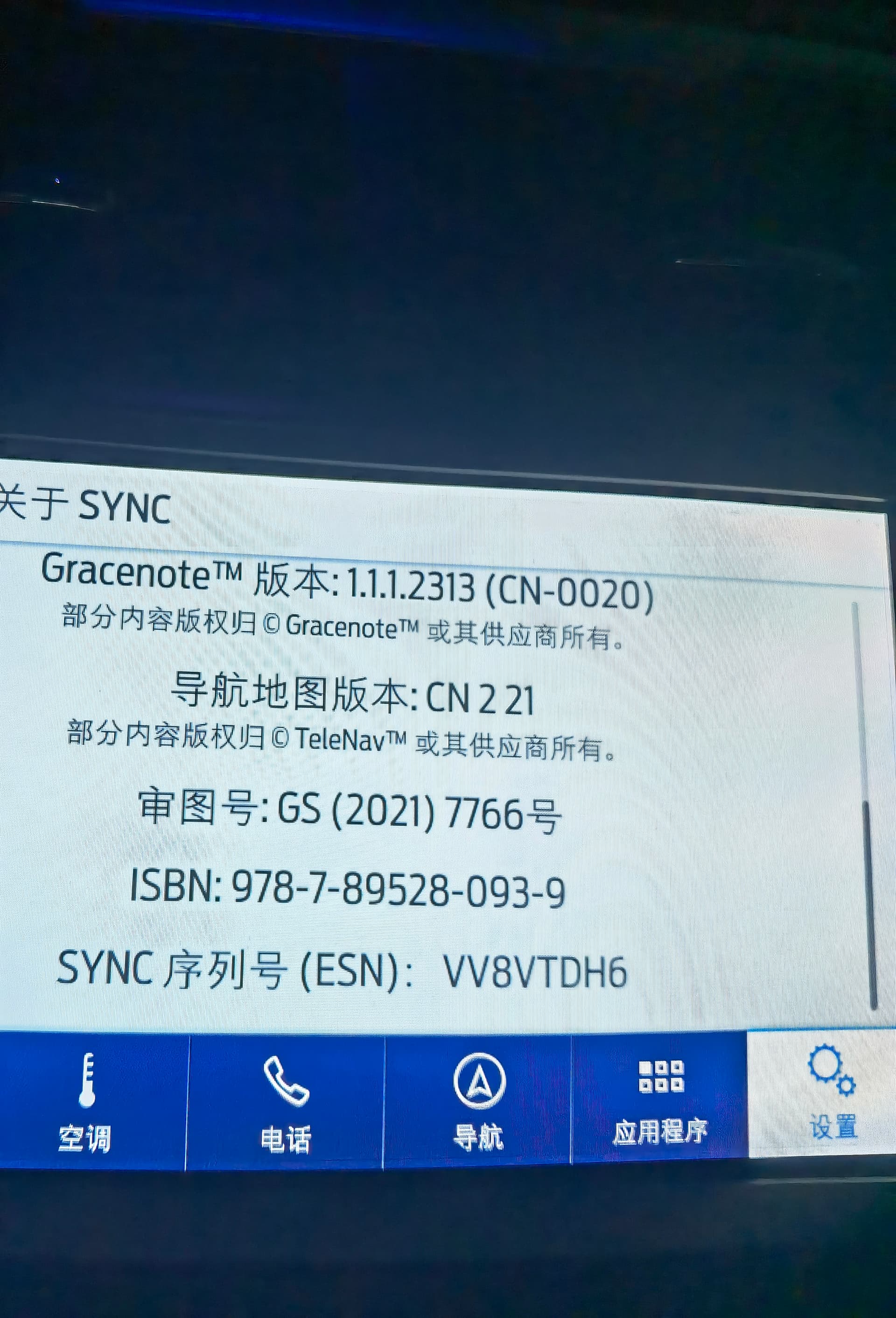

That APIM is a Chinese hack job. The sticker removal and the Chinese text in the details screen are dead giveaways to this.
That’s just the chinese language set in SYNC is it not?, the sticker removal however is odd
